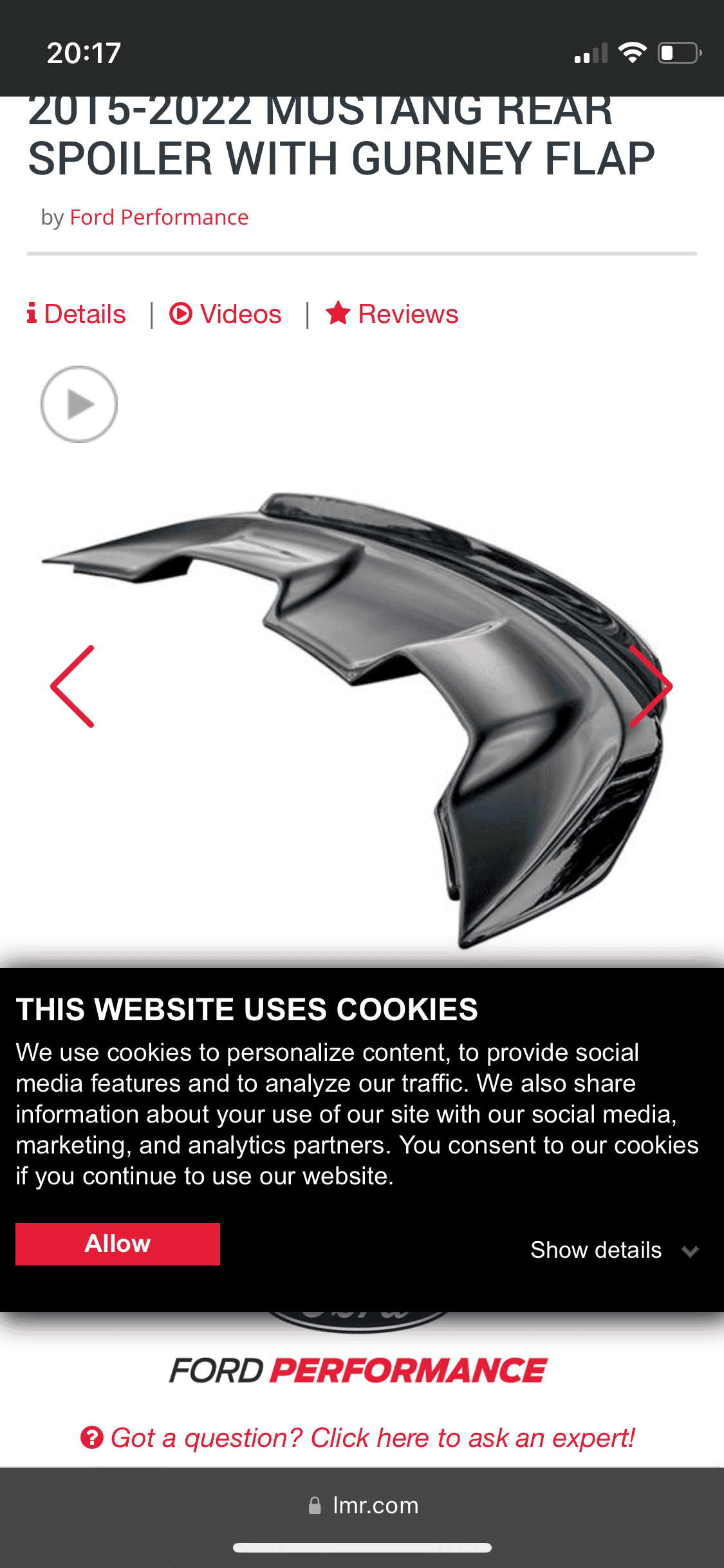

Would someone be willing to share a photo of what a gurney flap is? I can't see to figure out what it is.
I'm totally just curious.
Thanks!
Thanks!
That raised lip on back of the HP spoiler.
