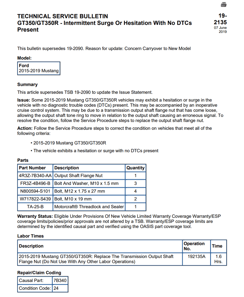

sox3
Jun 2, 2019
1,201
2,038
Newark, Delaware
George
2019 GT 350 Performance Blue
Here is the TSB on it
MutterTheresia
May 1, 2017
Germany
2016 Shelby GT350 Technology 2017 Shelby GT350 Track and Electronic
Thanks a lot.
I will show this TSB my Ford Dealer in Germany. I hope it works.
This morning I first disconnected the car from the battery for about an hour so that all possible errors and PCM data are deleted. So that the car is learned again. When I was driving in normal mode everything worked so far. As soon as I accelerate strongly and then want to go into a higher gear to cruise, he stutters and I can't get the cruise control switched on. if I press it several times I get it turned on at some point but then the vehicle jerks briefly and it jumps out again.

matthewr87
Oct 13, 2013
81
1,226
1,675
Maryland
2018 GT350
In the TSB it says that there is no DTC with this condition, so probably no engine light?
