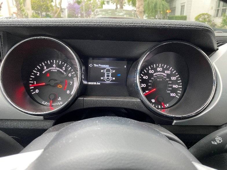

No check engine light initially, within 24 hrs check engine light came on

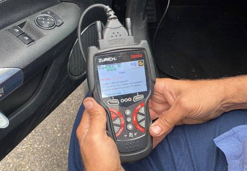

Went to mechanic. Hooked up scanner #1 (Zurich ZR15S)
I took a picture of the code: P0304 (meaning cylinder misfire in 4th cylinder) to look up later even though mechanic told me not to worry about it.
I looked it up and seemed like it was potentially pretty dangerous
Did some research on ford forums and found discussions about people having had a similar error code (as well as other P03 codes for other cylinder misfires) specifically following clutch and flywheel replacement. These forums mentioned crank relearn and misfire monitor neutral profile correction as potential solution.

Mechanic cleared code, said maybe it was a glitch since I wasn’t experiencing any engine misfire.
Went home. No problem till next day, check engine came back on.
Later that night, I actually felt the engine misfire (before I experienced it, I wasn’t sure exactly what that’d feel like, so I wasn’t 100% sure if I’d even be able to recognize it, but once it was actually happening, I knew immediately). The feeling was like a vibrating ratatat when depressing the gas pedal, and when I felt that immediately looked at the check engine light and saw that it had began blinking. That all lasted for about 10 seconds, then it was fine again, though the check engine light was still on.

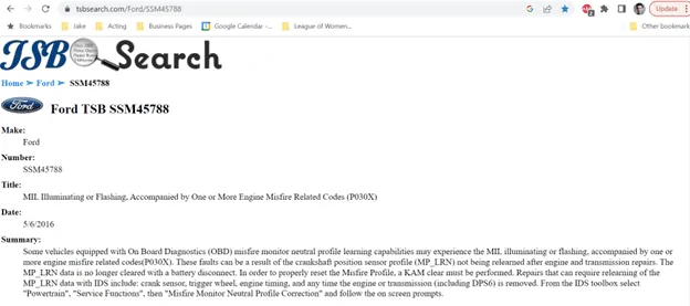

See official ford technical service bulletin (TSB) outlining the problem:
Had car towed to shop just to be safe since I’d experienced an actual engine misfire the nigh before
He hooked up the Snap On scanner above and when I got there, he said he thinks I might be right. Cleared the check engine light, then ran the profile correction.
Link vid to people running that profile correction:
Been 2k+ miles and running like a top now, no check engine light has come back, and the car is running great. Note: for a few hundred miles (about 500 or so) after clutch and flywheel replacement, there was slight shudder (nowhere even near what it was like when I first brought it in) in shifting out of first and reverse. However, have read others experienced the same break in period post clutch and flywheel replacement, and shudder went away completely by 1k miles.
Turns out then whenever transmission is removed from engine, the computers inside the car need to be recalibrated.
See 2:06 for what it looks like when your transmission Is separated from the engine to access the clutch and flywheel for replacement:
Bottom line: super easy fix, just have to know about the “misfire monitor neutral profile correction” process and send them this doc/insist that your mechanic hook his scanner up and run it, even if he’s understandably skeptical because he’s never heard of it.
