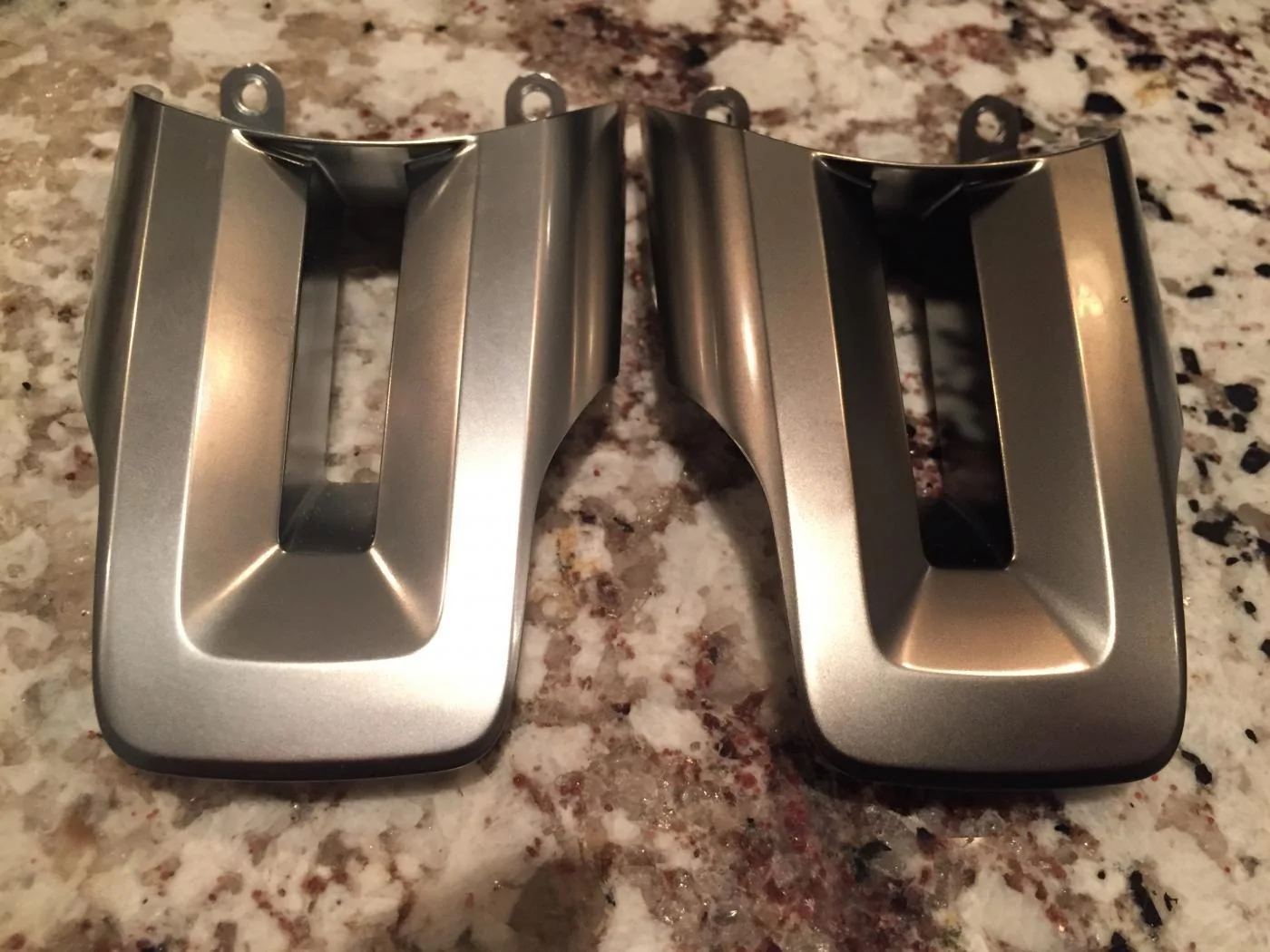

For those of you wondering how the stock bezel piece compares to the R. Finally got mine installed as well. Now to wait for these temps to go up so I can drive it ! :doh:

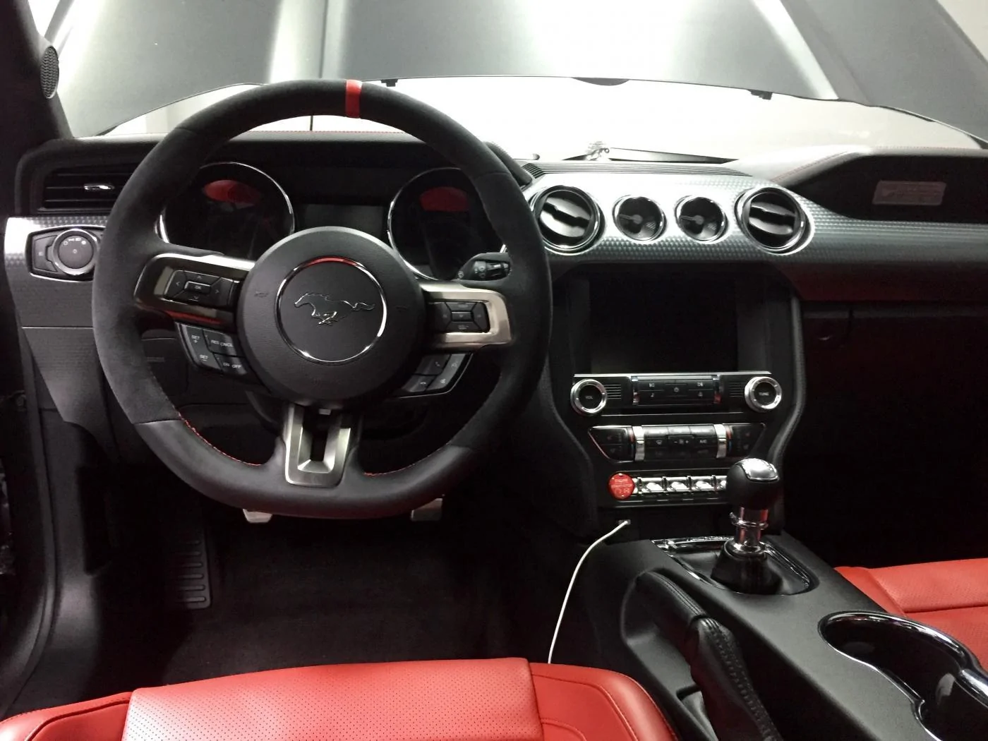

Quick question about installing and centering the wheel: After finishing my install, my wheel is slightly off center--enough so that it's mildly annoying. Does anyone know if, instead of trying to install the wheel with the wheels pointed straight, you can turn the car to a full lock, and then install the wheel in the same position? It seems like it would be easier to make sure the wheel is pointed in the correct direction that way, but I just wasn't sure if it was possible. Ideally, it seems like turning the car to a full lock to the right (the direction the wheel gets torqued when tightening the nut) and then installing would be the best bet. Anyone know if this is possible? Thanks in advance!

If it is slightly off then it is probably just the wheel itself as there is a hex where it mounts to the steering wheel. I think you would notice a fair amount off if you had misaligned the hex (60 degrees off)

There should be a key notch or something making it a only one way installation. Where your wheels are pointed shouldn't make a difference.
Your wheel is most likely not centered to the alignment and it wasn't noticeable without the site line leather strip on the new wheel.
Wow, there was?!? Shows how observant I am! :lol:
I thought I remembered the wheel moving in my hand as I was torquing the nut down and thought that affected how the wheel was pointed.

Thanks for the pic! It's only off by a couple degrees--certainly not a full turn of the hex. When I hold the wheel with the spokes pointed to 9 and 3, the car tracks slightly to the left. When I'm going straight, the wheel appears to be turned very slightly to the right (according to the position of the spokes, and not the centering stripe).
