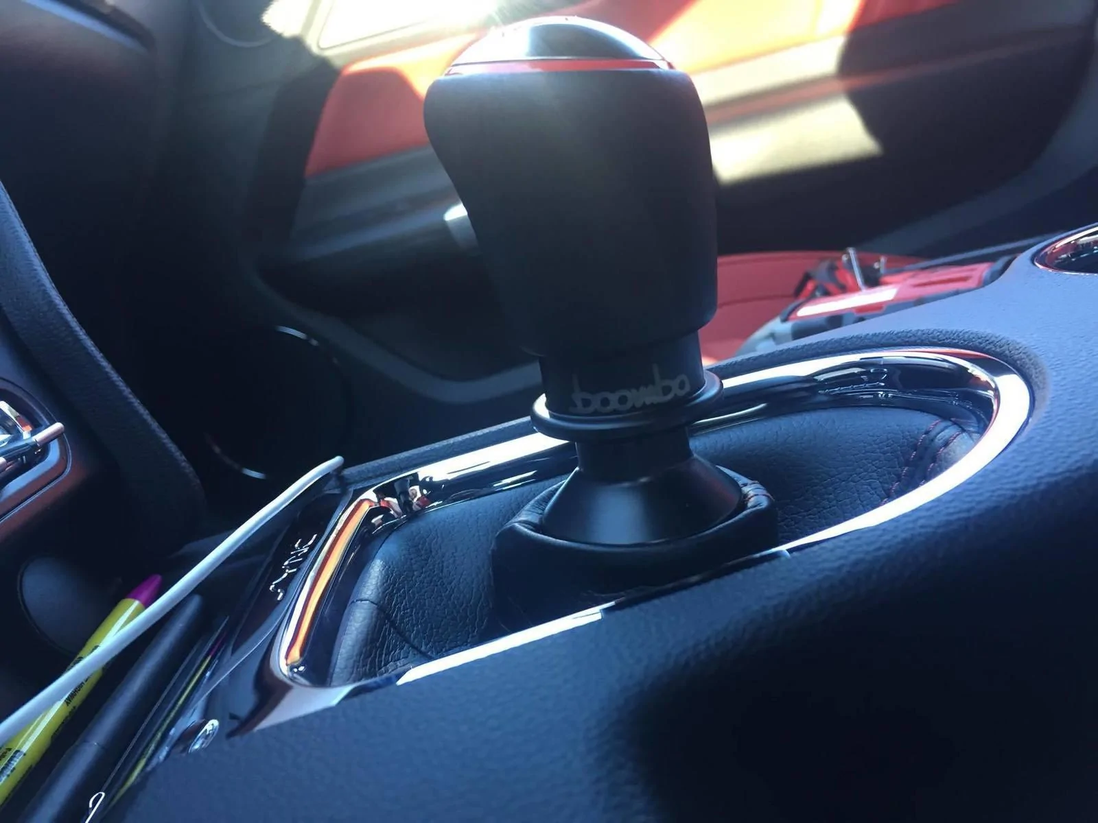

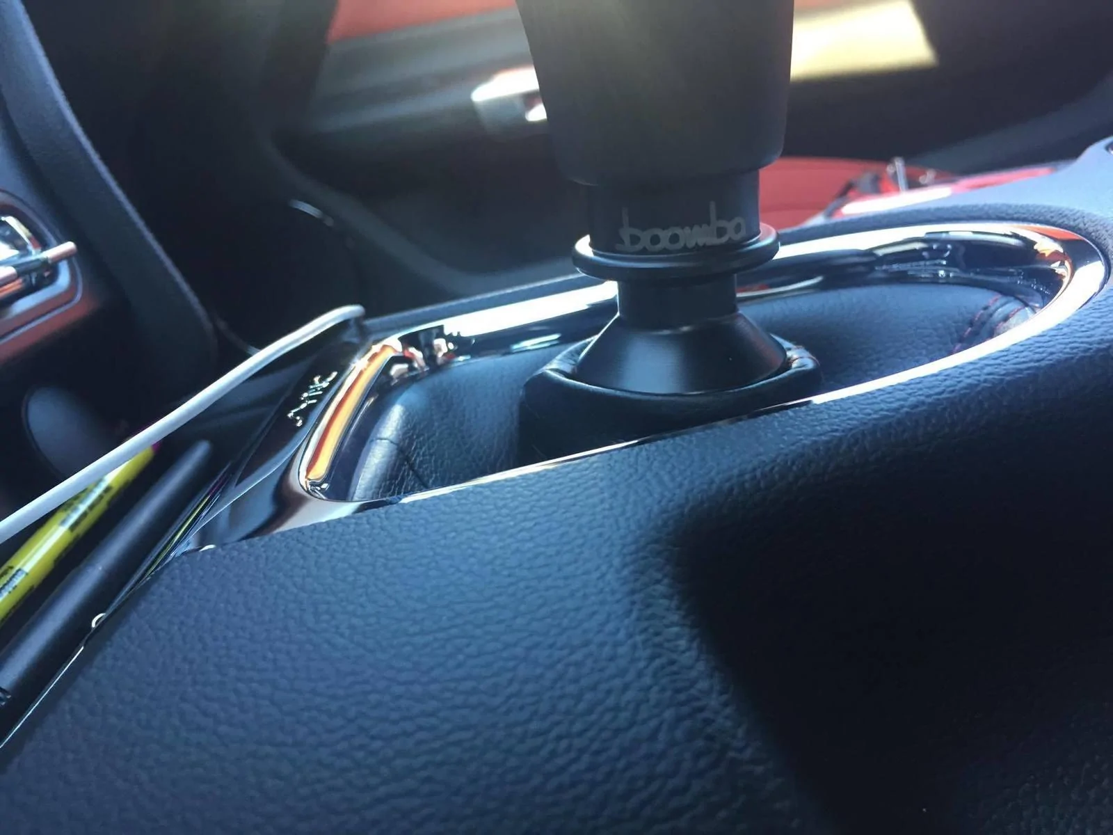

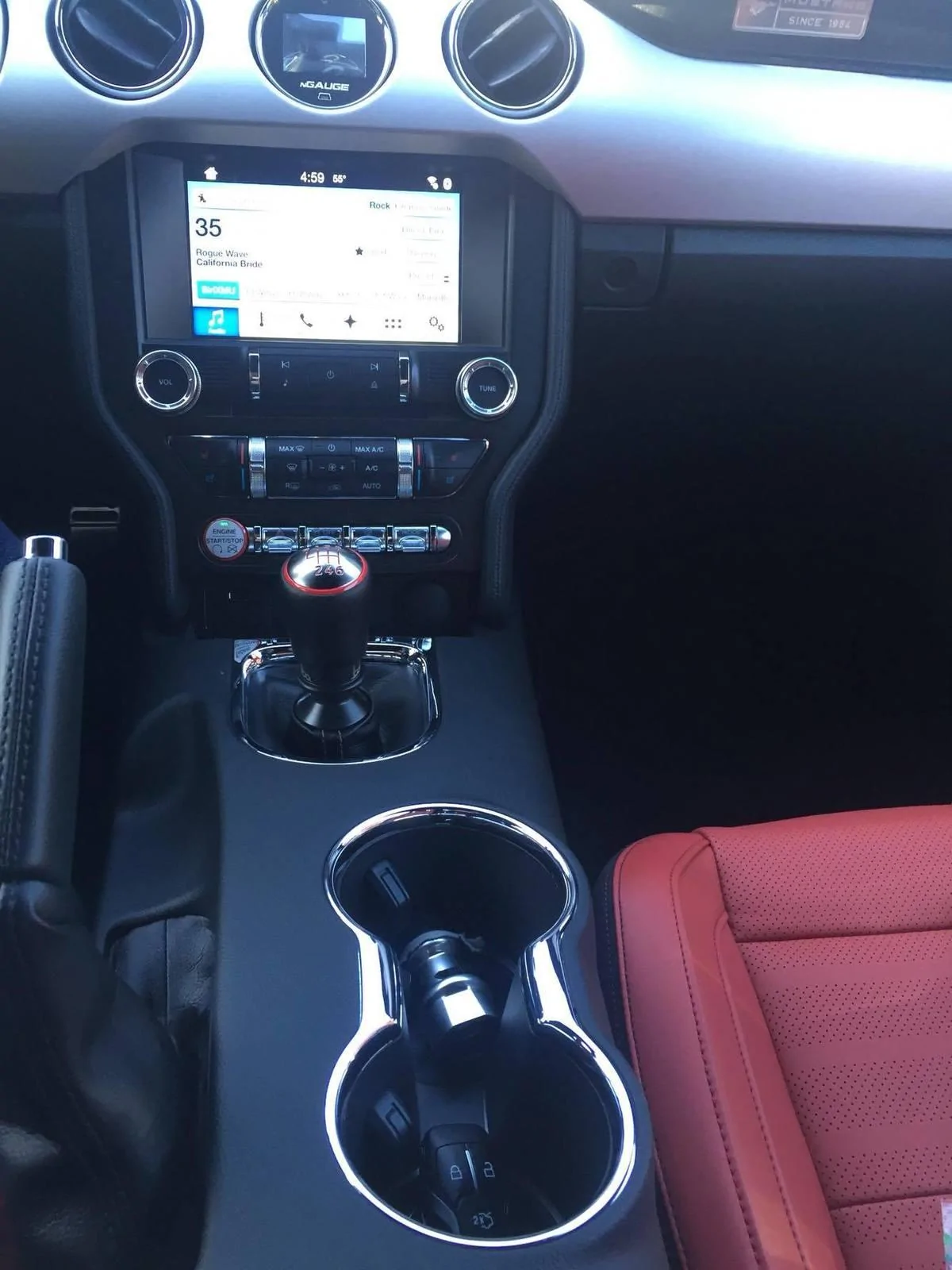

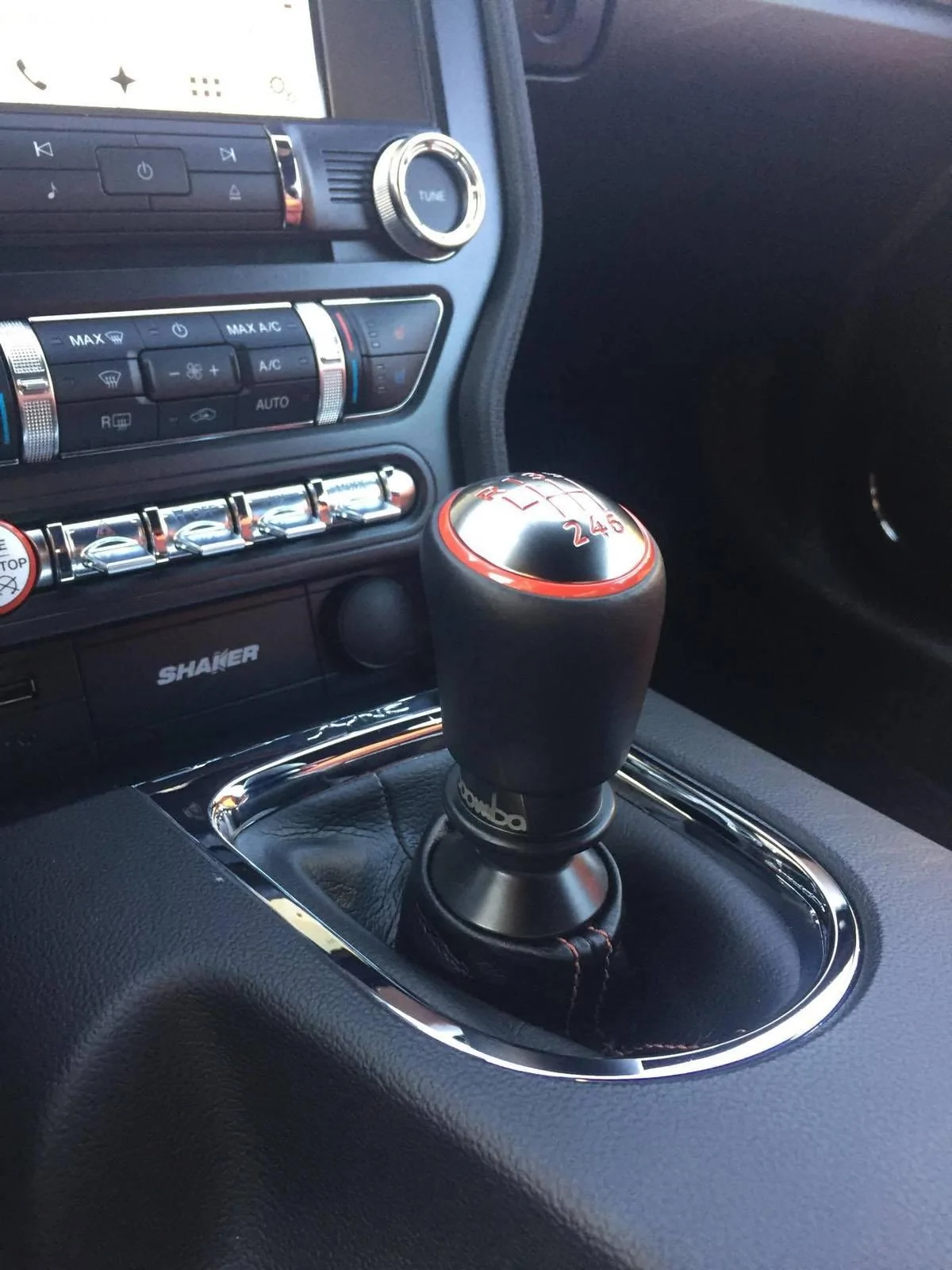

Installed a Boomba shifter handle and GT350 knob today. Have to wait overnight for the Loctite to set, but looking forward to seeing how it feels.

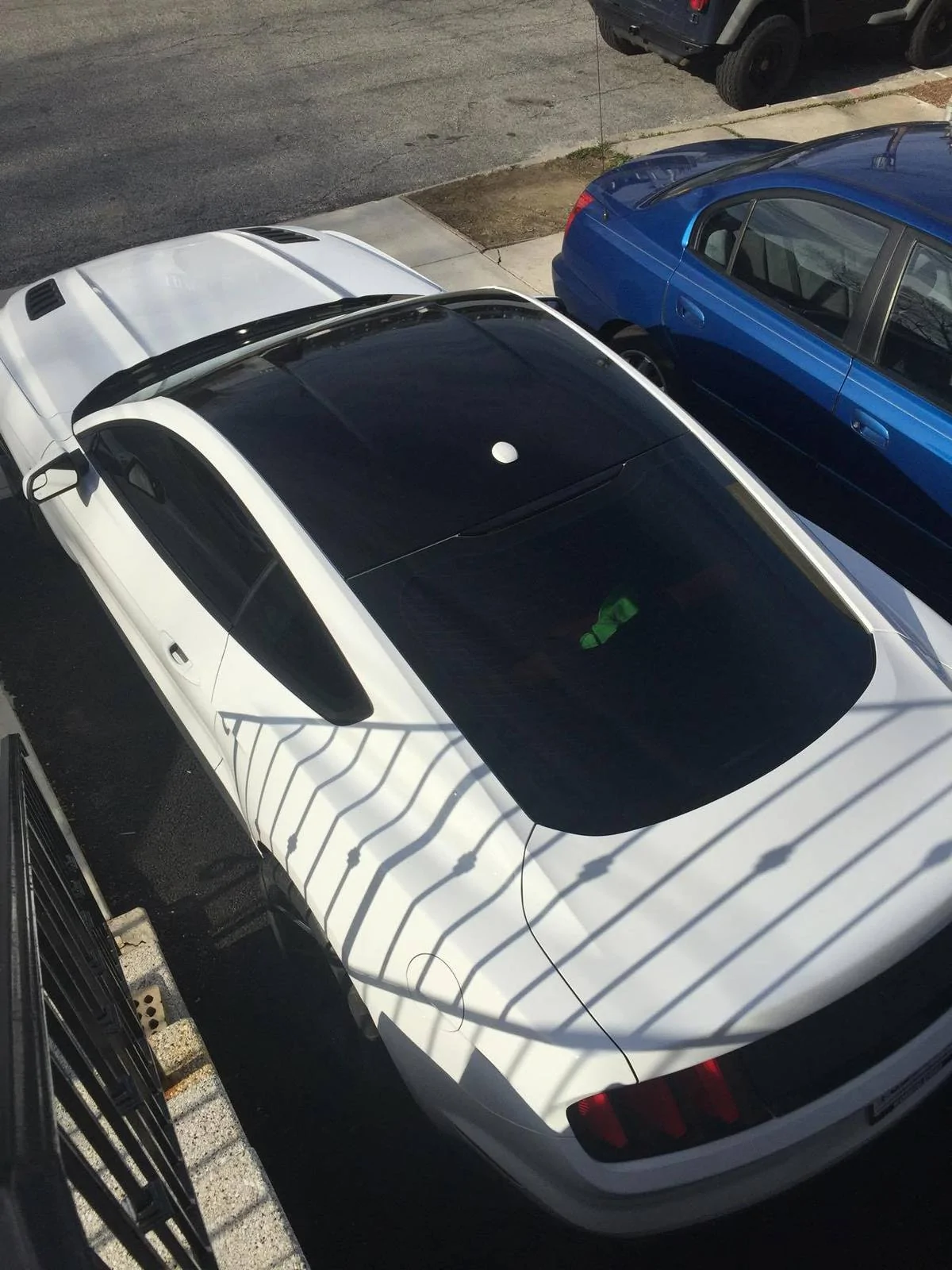

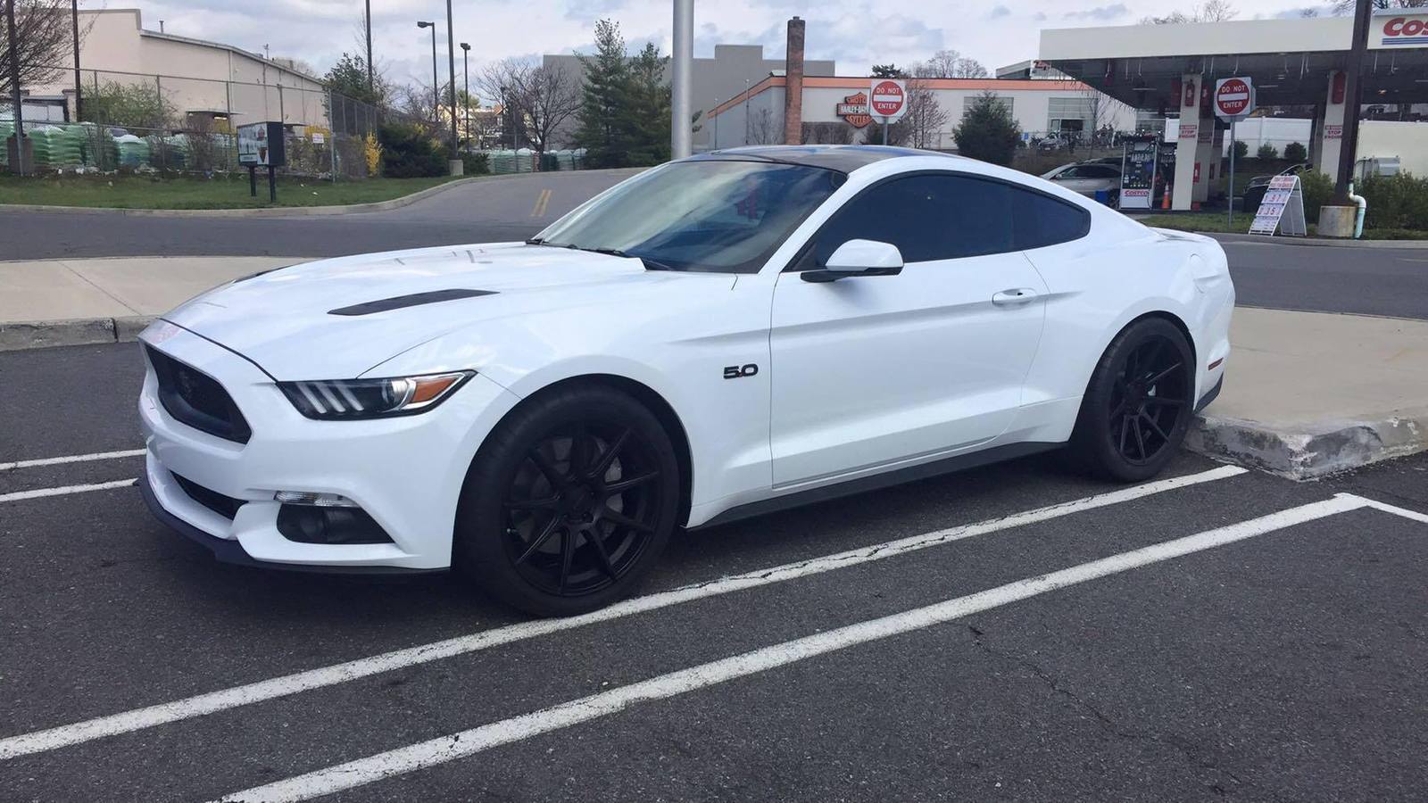

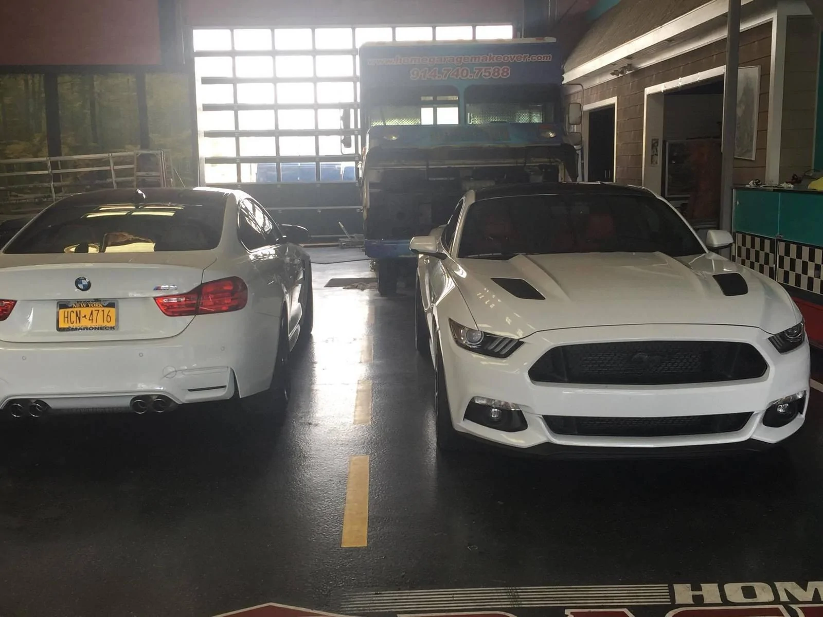

Did some more modding last week, only have a couple pics.
Diode Dynamics switchbacks, interior LEDs, and reverse bulb
35% tint
Gloss Black roof vinyl
Plastidipped all of the emblems
Satin Black Velgen VMB9 with M/T Street Comp 275 and 305/35/20
Think I'm done with appearance mods for the time being. Still need to install the resonator delete, and figure out if I like that sound or if I need to go for mufflers as well. Also on the fence about tinting the tail lights or not.

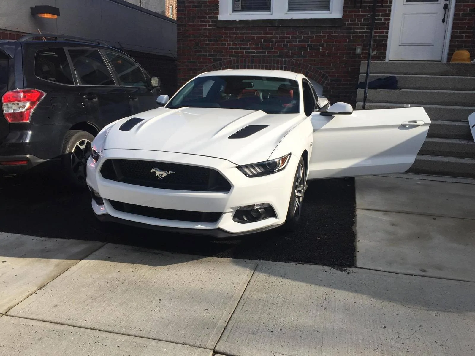

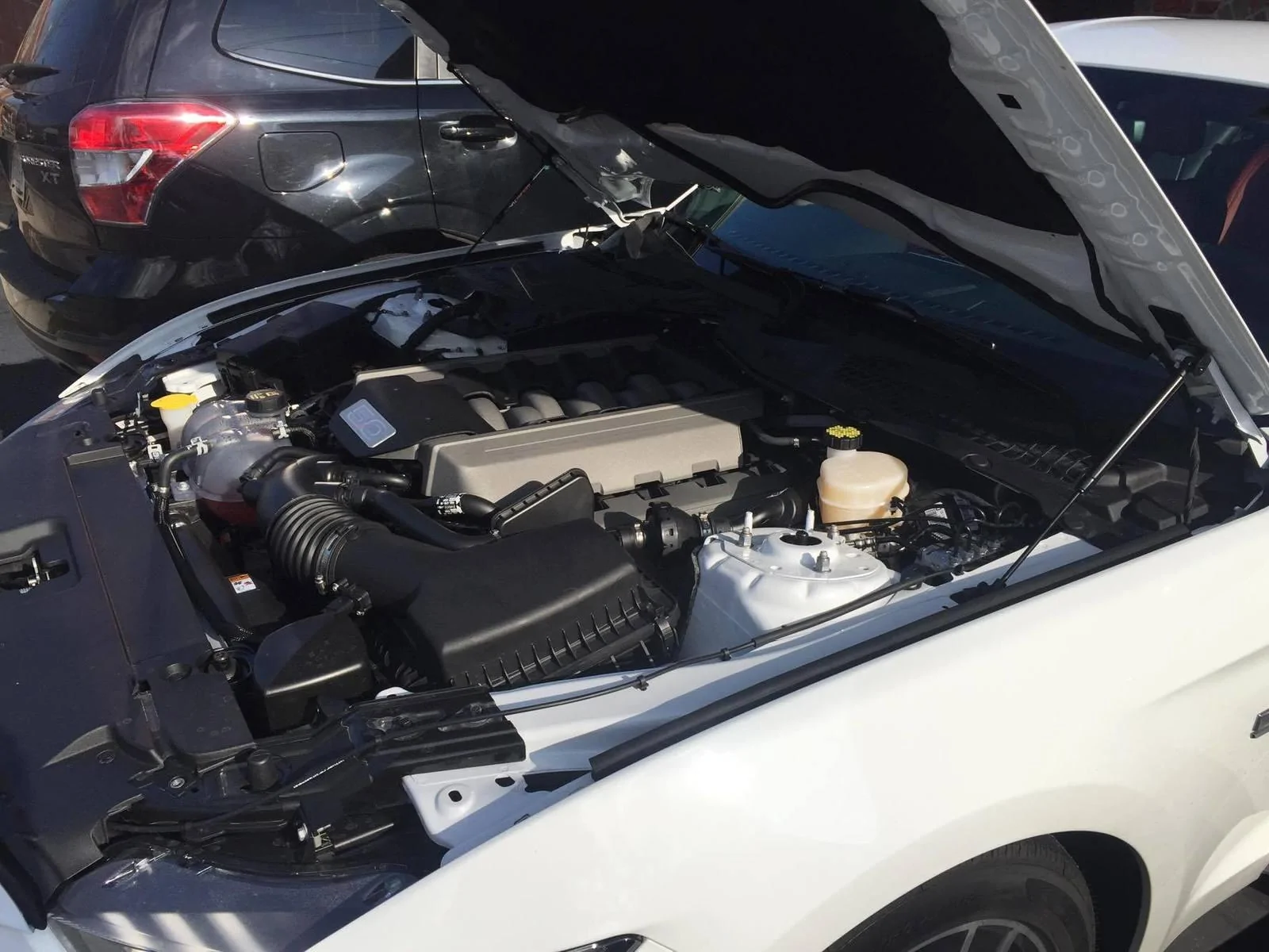

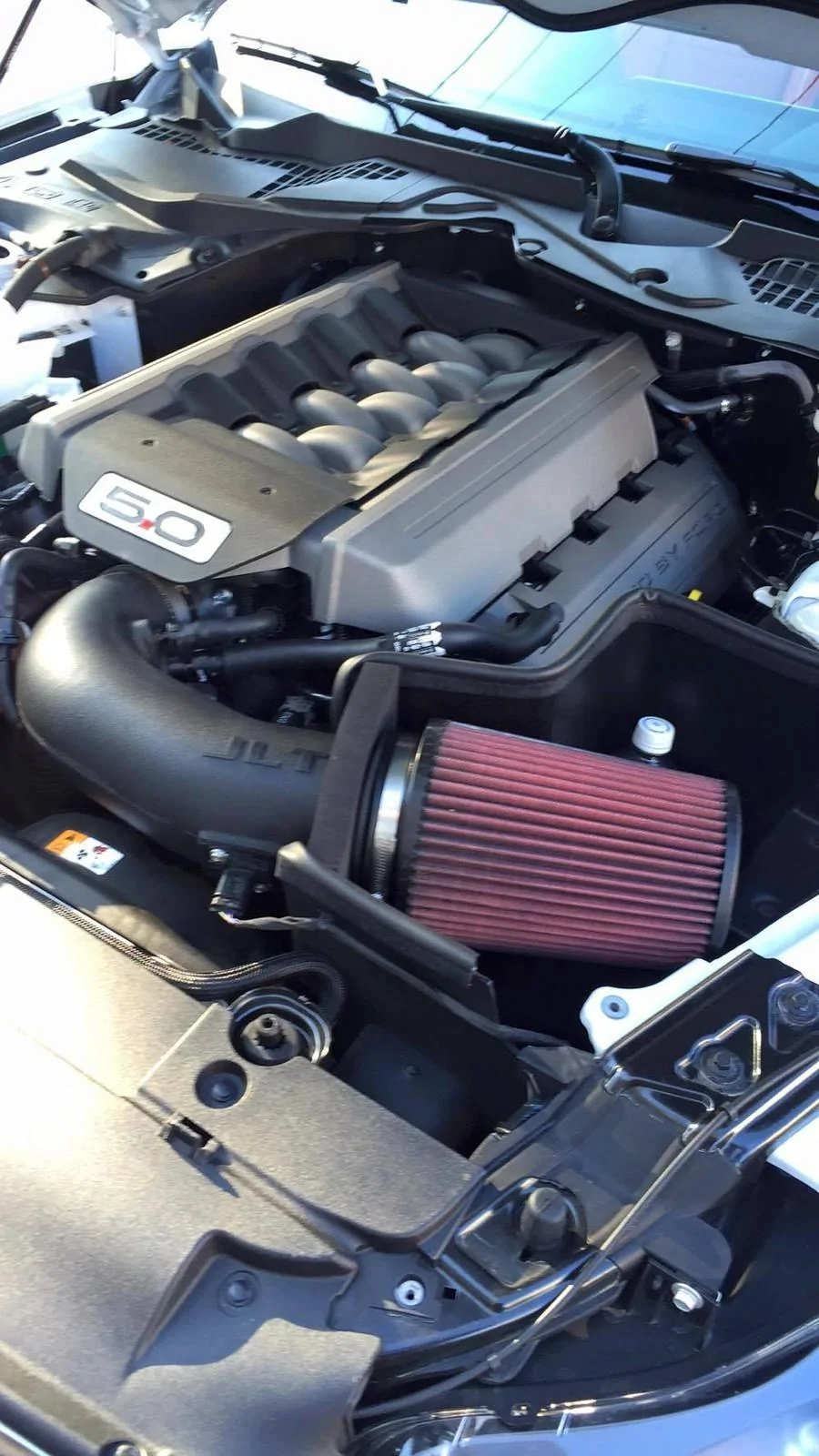

I hit 1000 miles and all is looking good with the car, so I decided to change the oil and flash my Lund Racing FF tune. First, I wanted to delete my grilles and install the JLT...

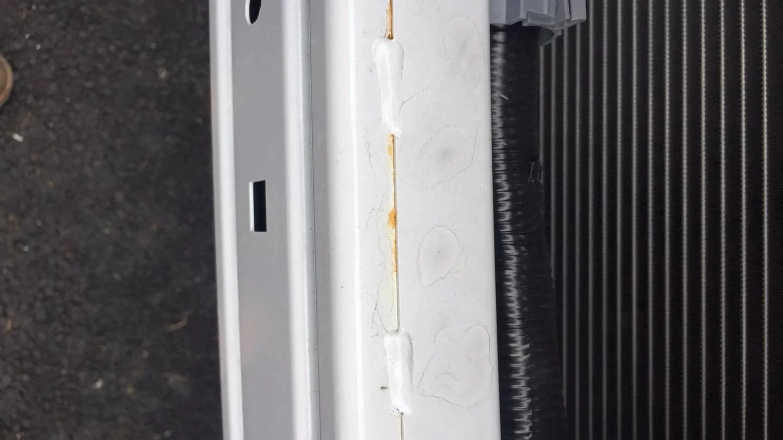

I noticed I'm getting a little bit of rust on the front of the car - to my knowledge, my car has never seen salt. What gives?

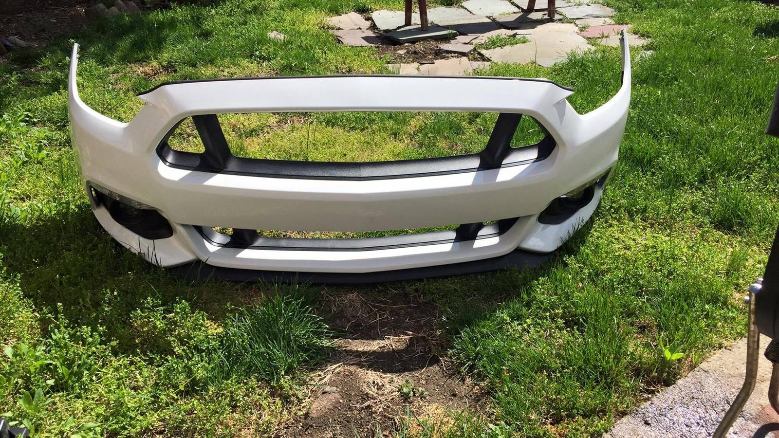

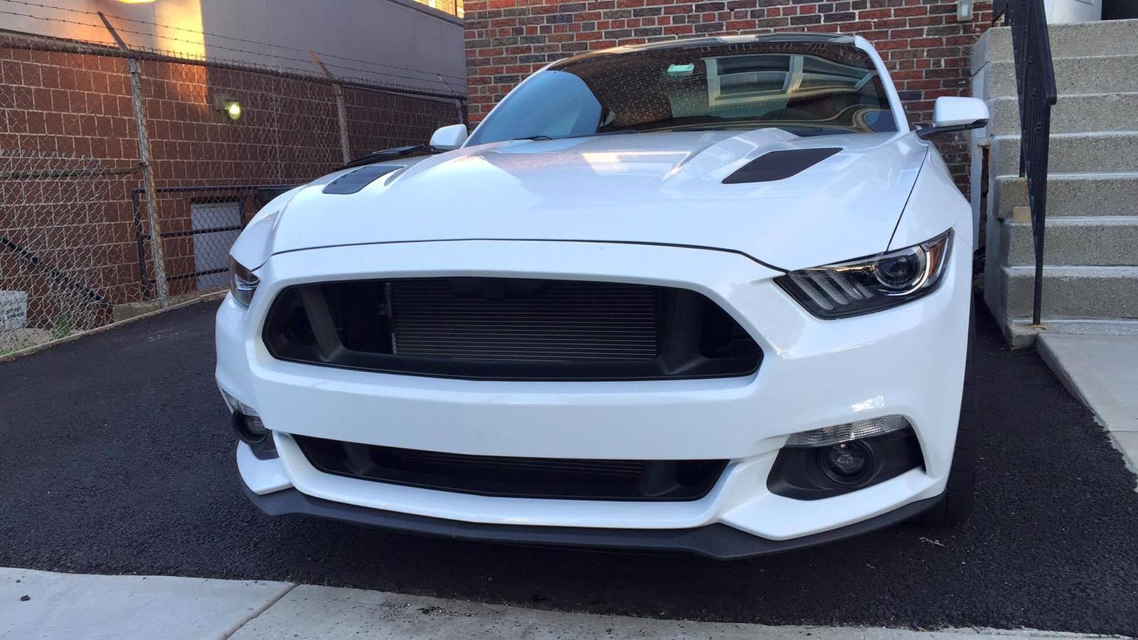

Grilles deleted: Really not very difficult, just takes a little while to get the front valence off. Lethal's instructions are pretty good for this. I had some difficulty with taking the grilles out of the valence until I worked out a good system of pry->pull->pry->pull etc.
JLT installed, thanks to Vinny and everyone else over at JLT for hooking me up with the missing parts that the guy on FB failed to include with my second-hand intake..

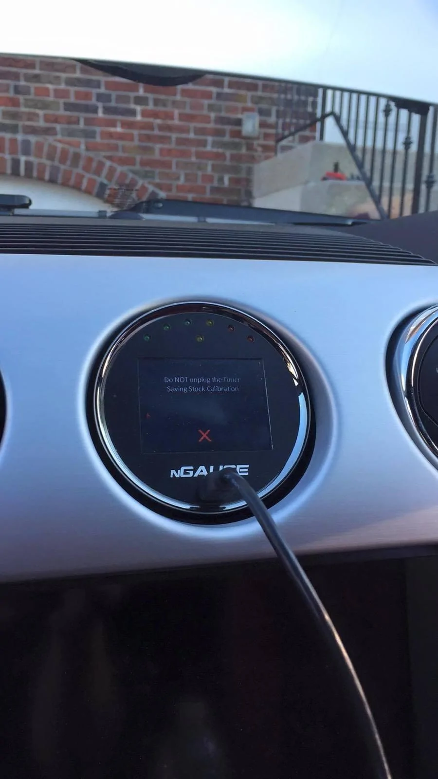

Now time for the tune...
And the finished product.
I haven't had a chance to really run the FF tune, I'm nearly empty so I'm going to go fill it with E85 and give a full review. Between the intake noise and the quicker throttle just driving around city streets, I'm very satisfied with all of it. I also love the way the grille turned out. If you're patient with the dremel and take your time, you can get some nice clean lines with a little bit of additional sanding. Very easy to DIY.

I would get some touch up paint along that seam pronto! Good prep first though.
(Going to look under mine - also bought from Koons a week before you did.)
Yup, just add "scour the undercarriage for rust with a wire brush and rustoleum" to my summertime to-do list.

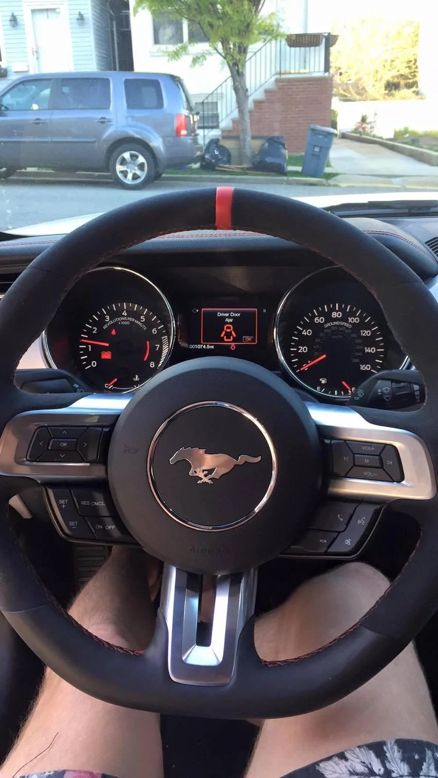

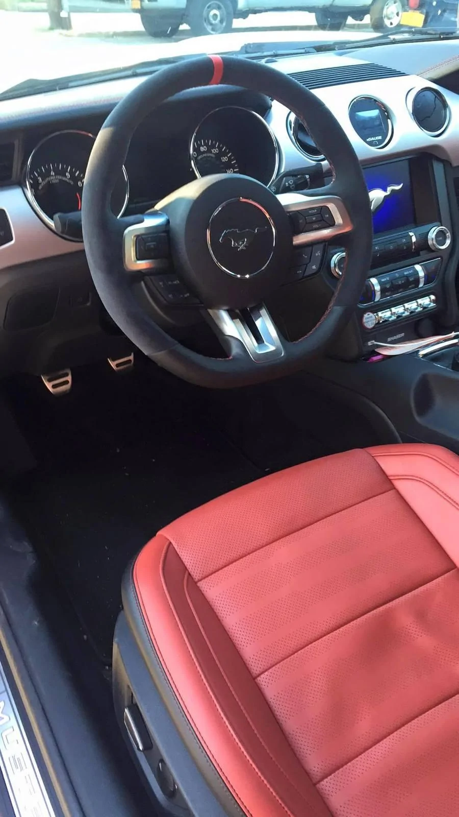

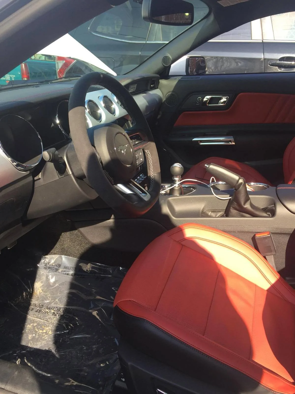

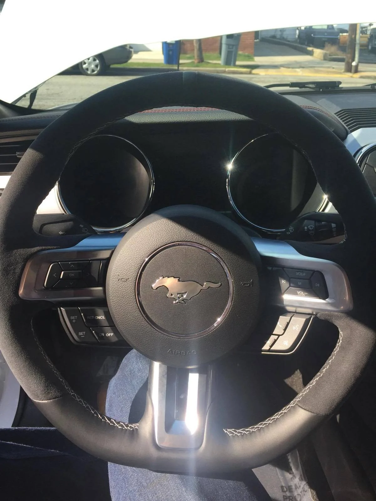

In other news, I installed the GT350R wheel that I got from Benny at Levittown Ford. I lucked out and ordered early enough to get the original pricing.
The install is so easy once you've done it before, lol. The longest part was running upstairs to grab a flathead and wrap it in electrical tape to pry the bezels off, because the GT350 wheel is juuust slightly thicker than the OEM wheel so you can't get your fingers under the outside.
A tip for anyone looking to install their own: Pry from the outside (furthest from the center of the wheel) of the bezel, they pop right off. They will not come off if you try prying along the top/bottom/inside because there are clips all over the place.

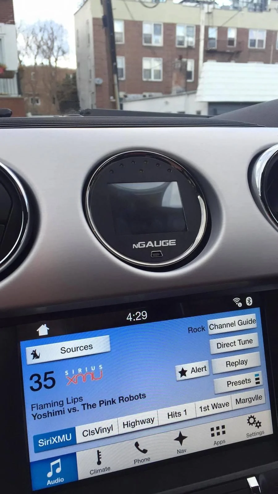

I also got a chance to smash the pedal a little bit with the Lund FF tune on 93 - holy shit. Along with the increased HP, the throttle response is much nicer, especially in the midrange. The car doesn't feel like it takes ages to decide to accelerate between 2-4.5k anymore. Loaded it with e85 today, I'm waiting for the car to learn the fuel before I go have fun with that. It was neat to see the ALCH_PCT PID climb from 15% after I filled up, and see the KNOCKR PID adding timing as it saw higher and higher octane fuel.
