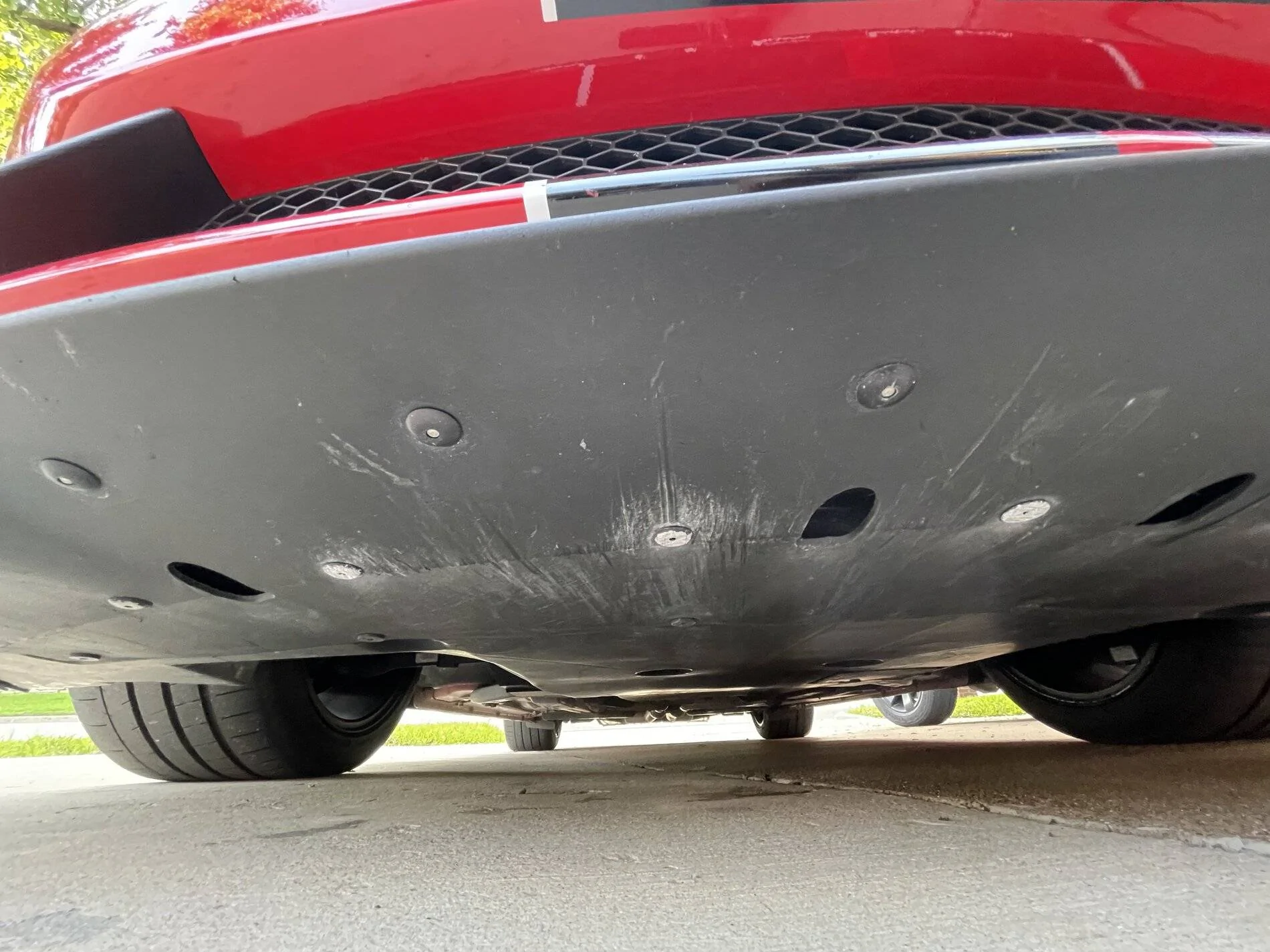

I bought a 2017 GT350 several months ago and after looking under the splitter, I see several of the front attachments are pretty well ground off. Not sure if these are bolts, rivets, push connectors. Does anyone know if an OEM hardware kit can be purchased to replace it all? Thanks!
See attached pic of the effected area:

Perfectly normal. I’m not aware if they’re replaceable, but I’m sure someone smarter will chime in if it is.

They are aluminum rivets
Just drill them out and replace them if you want

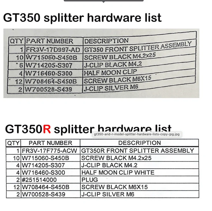

There is no separate fastener kit sold for the front splitter. The splitter and fasteners are sold as one part number. You can purchase the pieces individually. The half-moon white plastic pieces are also used to hold a portion of the rear bumper cover.
Off hand do you happen to know the part number?
Nvm, found in the sticky, FR3Z-17626-E

I screenshot this a long time ago as I knew one day it will come in handy
Thanks for the info huskeee, I appreciate it. I’m starting to wonder if I have an aftermarket splitter. I have the 12 W708474-S450B screws, but the remaining items are quantity 15 and look like rivets with a concave metal insert (about 6 of these are the ones that are ground down in the pic).
Guess I’ll start searching for third-party splitters to see if one exists that uses the fasteners I have.
They look like those

Yeah the rivets are part of the splitter from Ford and they don't sell them as far as I've seen.
