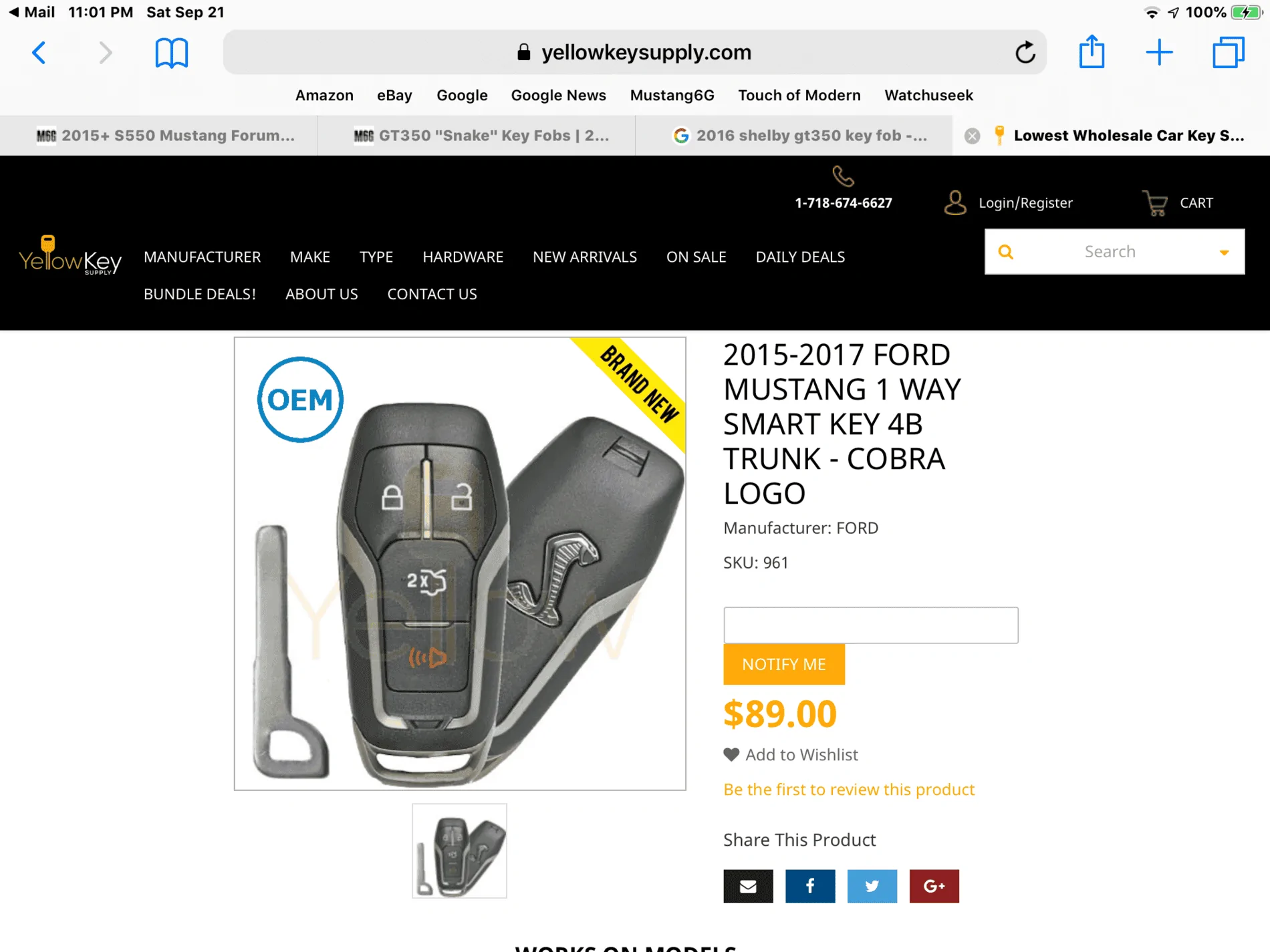

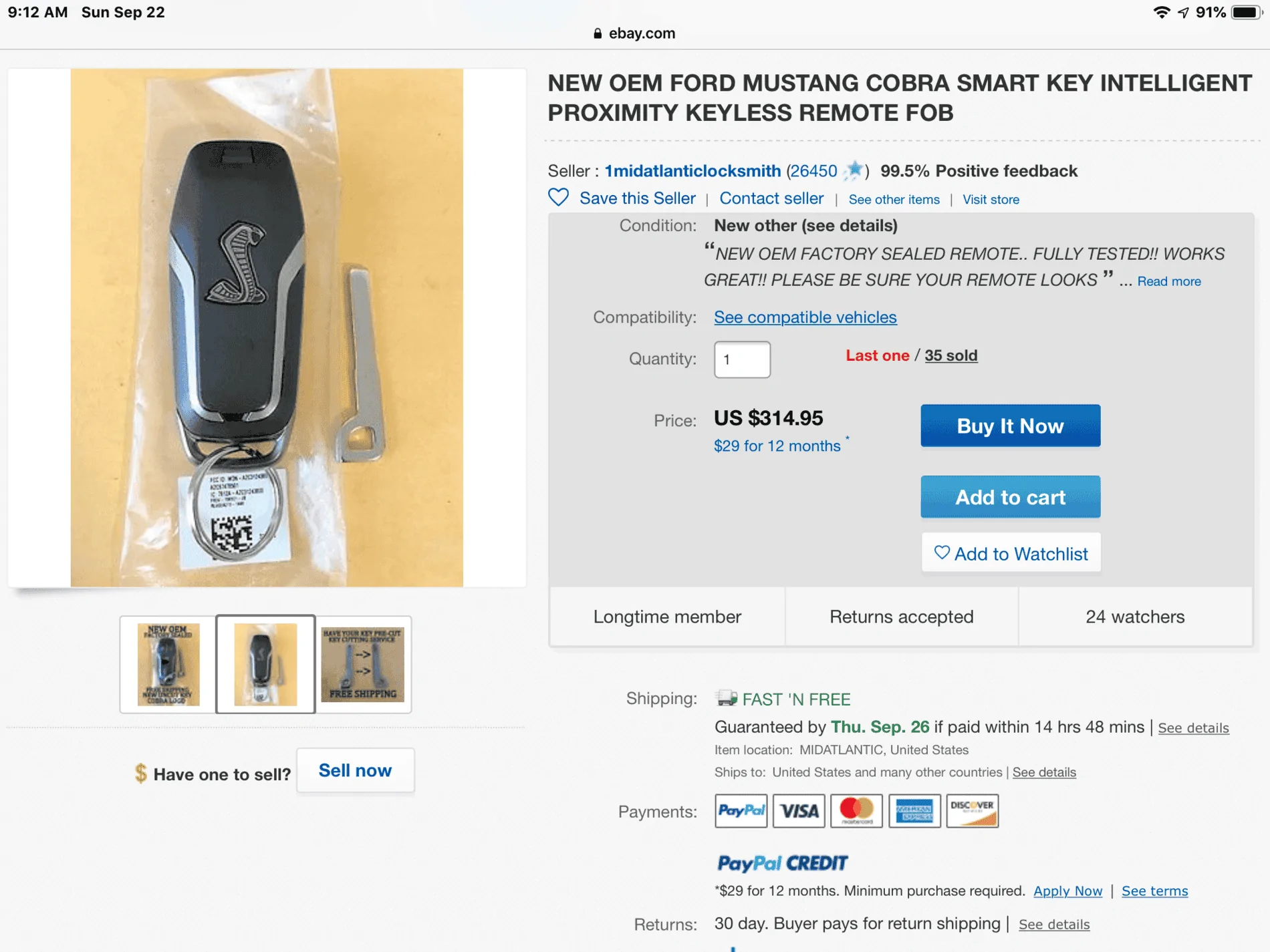

Tank - Understood- thanks
That’s why I was looking to pick up two more and have three. I wouldn’t care it the car came with two, or if they were all “Mustang”. But I figured if I’m going to buy more, might as well be “snake”
But the couple sources I’ve seen are “out of stock”
