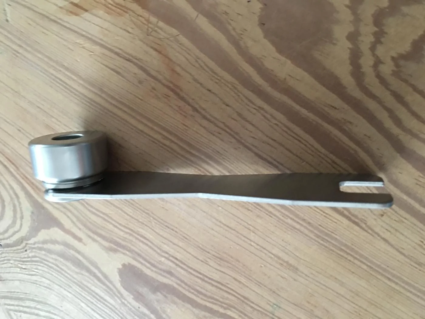

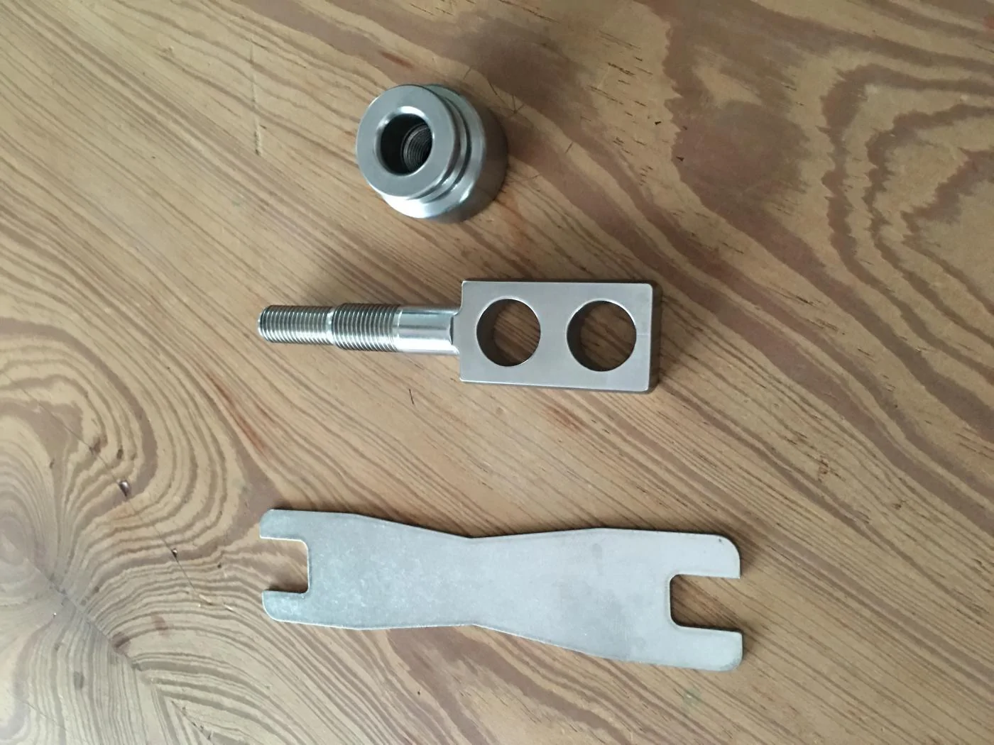

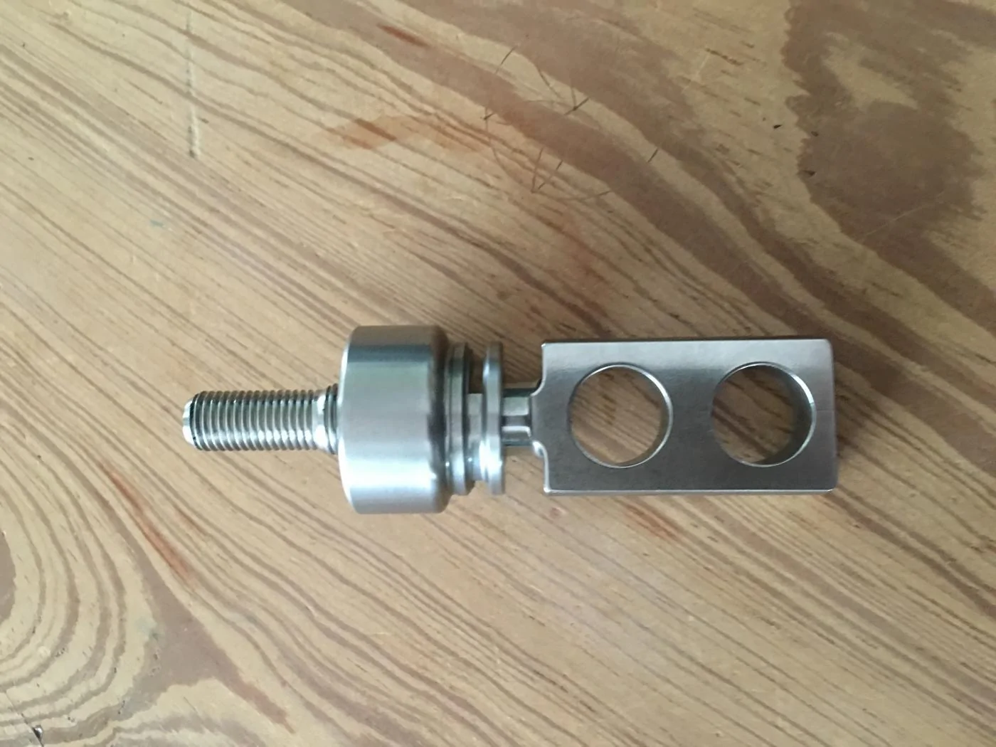

So, just received my MGW GT350 shifter conversion arm kit and it is freaking beautiful! It is a new arm to swap out with one that comes in race spec mustang kit but has the proper threads for the GT350 shifter knob, new proper sized jam nut color matched to GT350 shifter knob and the specific jam nut wrench to get it done.
George has hit a home run with this and I can't wait to get this installed later today. I will attemp to get pictures this afternoon but have t had luck lately uploading.

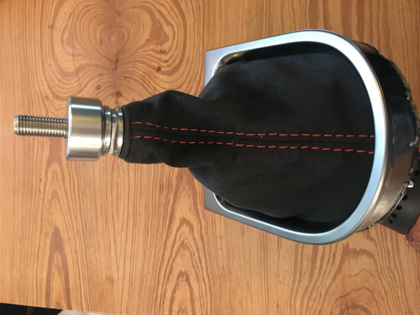

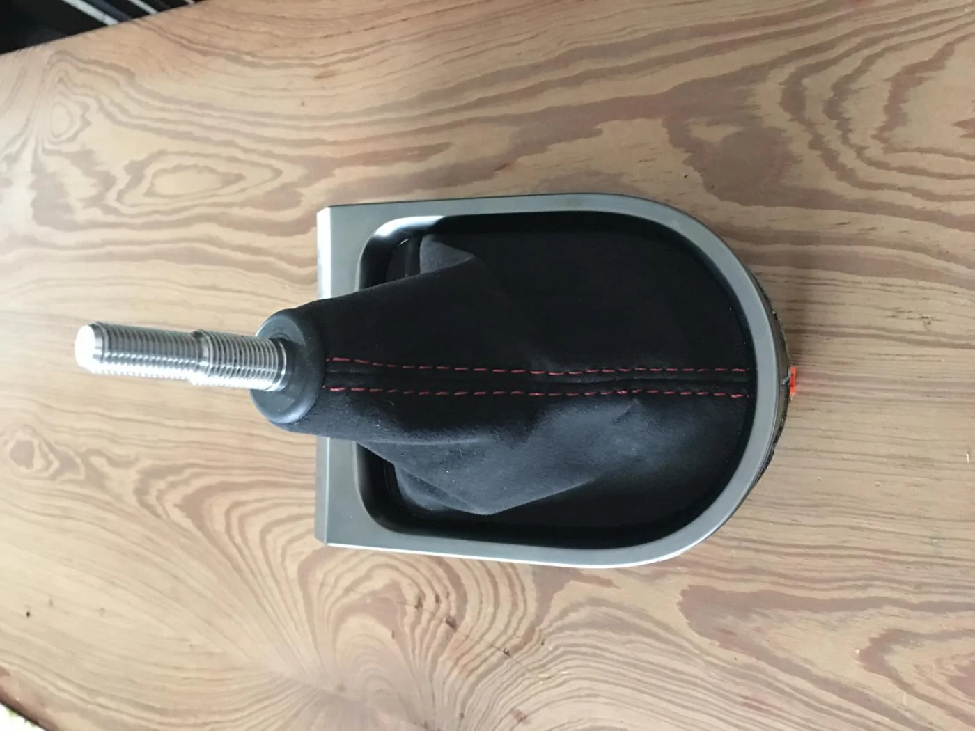

This is the difference between the GT race speck handle and the new GT350 handle that can retrofit on the race speck. The GT350 handle is shorter to make up for the taller GT350 knob.

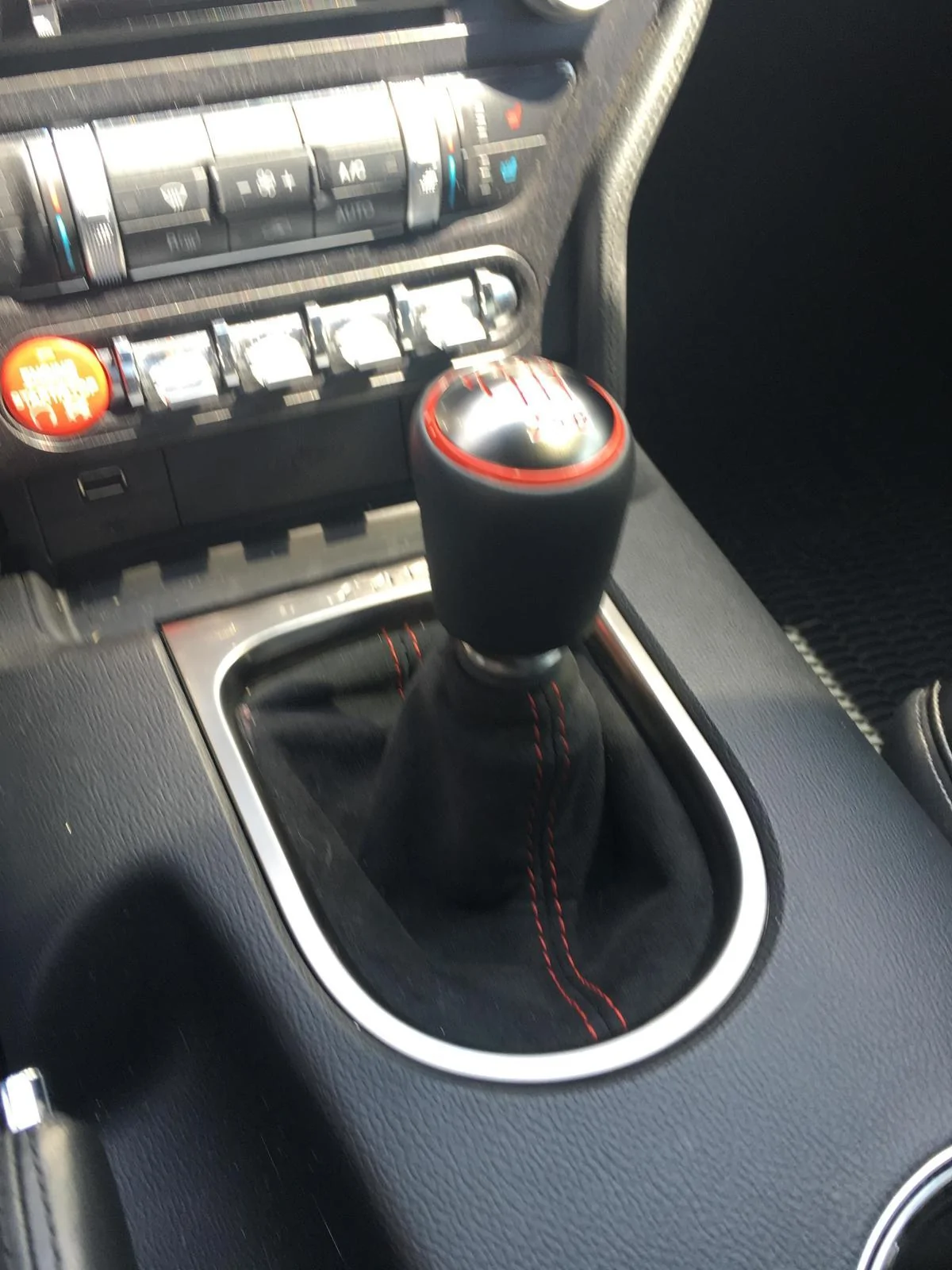

Here is mine installed :)

Cheated with CJPP knob and MGW shifter...love it

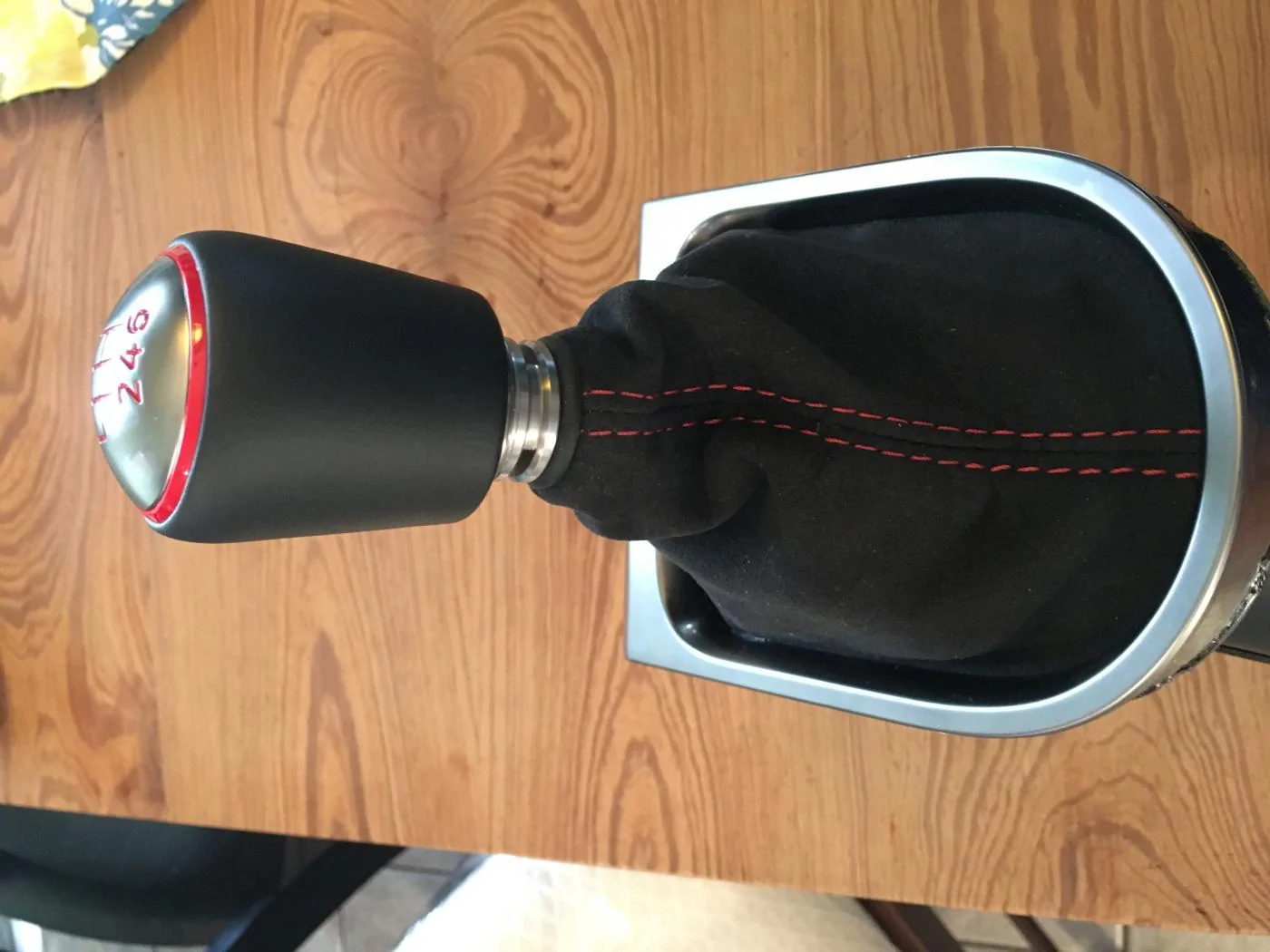

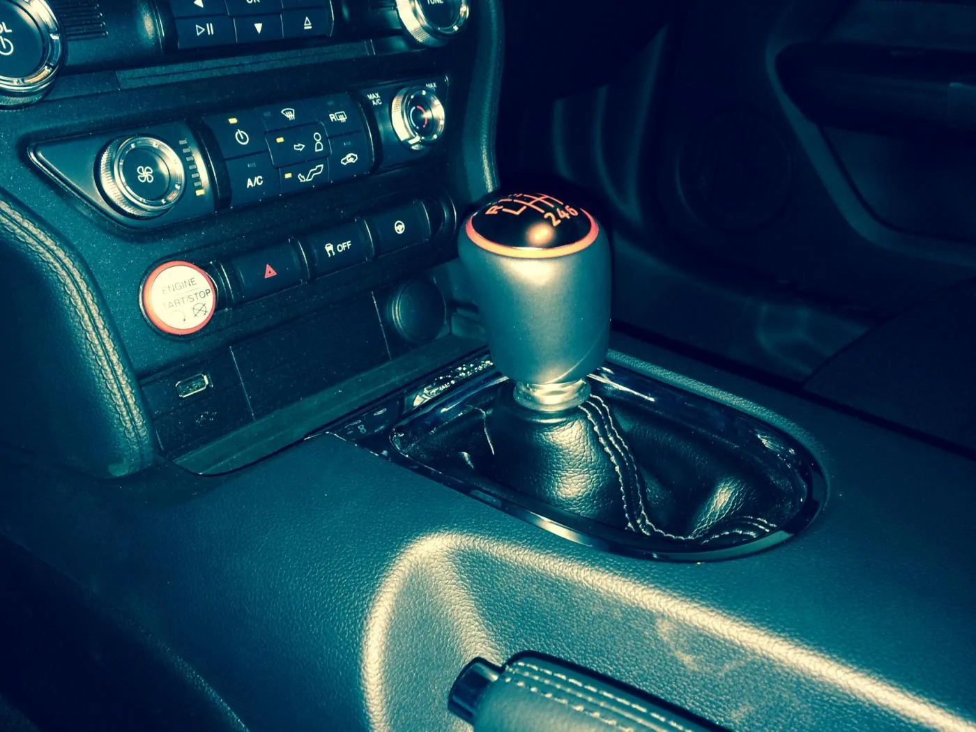

Finally got my MGW with GT350 Shaft & GT350 Shift Knob installed earlier this weekend. HUGE improvement over the stock shifter.
