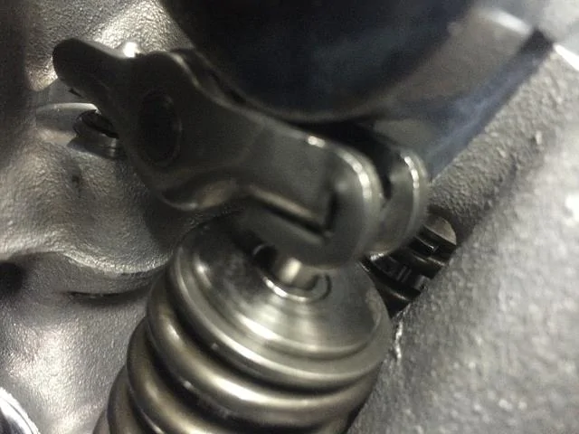

They look like it is clearanced....
I would need a guarantee they are they are as strong as non clearanced ones.

What’s your technical hang up with the modded rockers ? Just wondering
If you have to clearance the body of the rocker arm to clear the cam lobe, then the lobe and roller are improperly aligned.

Nothing that I seen from the relief cut that IMO compromise integrity. The 4 valve design uses freakishly low tension valve springs when compared to high rpm 2 valve.
As far as I’ve read in the past the GT350 cam base circle was reduced vs. Coyote. That’s the issue and the reason for the relief when using Coyote cams.
Rocker geometry remains unchanged.

As far as I’ve read in the past the GT350 cam base was reduced vs. Coyote. That’s the issue and the reason for the relief when using Coyote cams.
This is MMR's photo, it's obvious there is misalignment of the lobe over the roller.
Are we not looking at an example of a VooDoo head with a Coyote cam and rocker installed ?
There is full roller to lobe contact.
Are the two centerlines perfectly centered, No but there is 100% roller to lobe contact.
As quoted from MMR;
Many of you may be asking what this means for you. Basically if you want to run your existing stock or aftermarket 11-16 cams it requires the use of a Modified rocker arm (now available from MMR), the rocker arm has been clearanced to mimic the GT350 rocker arms because the camshaft will actually touch the rocker arm due to the extended valve heights of the GT350 head. Many of you may be asking "why cant I just use a GT350 rocker arm?" . The answer is that the GT350 rocker arm is not compatible with the base circle of the 11-16 cams and will hold the valve open due to its relocated wheel.
