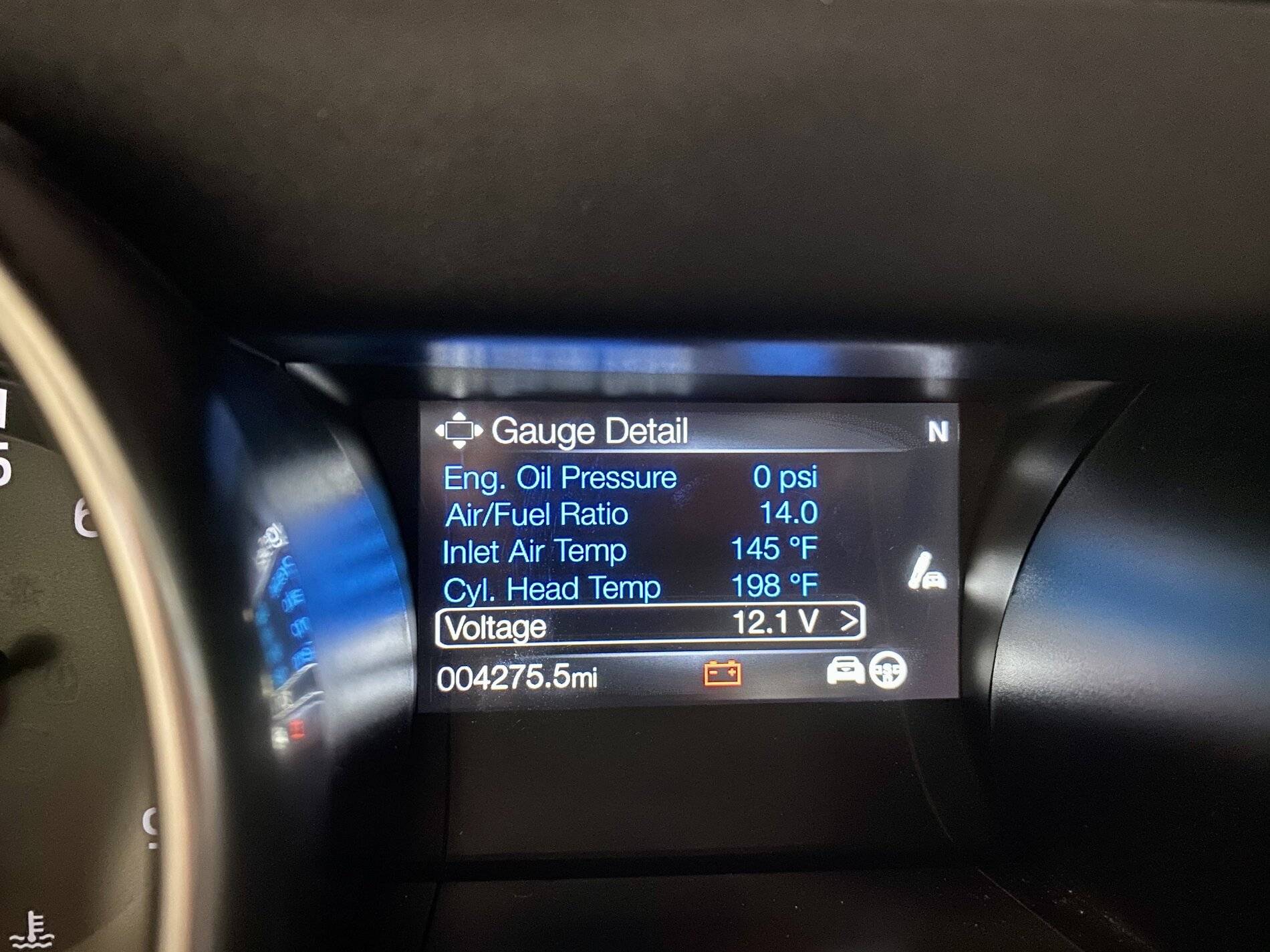

It there a cheat sheet anywhere on what all the readings are supposed to be reading during normal operations.
Ranges, Maxes, etc?

Those are what my readings are around, other than the zero oil pressure, and high inlet temp. But I'll guess the engine was just turned off, and the inlet temp is high because the heat from the engine under the hood jacked it up.
Normal oil pressure runs from about 35psi at idle, to about 110 psi at high rpms. And the inlet temp while running is a little higher(10-20°) than the outside air temp.
