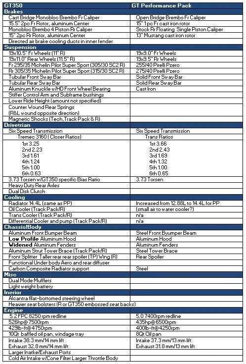

A summary I recently updated:
Just a few more.
-Wider front track/fenders
-Lower hood line/headlights
-composite radiator support
-heavier seat bolstering
-alcantara wrapped flat bottom wheel
-factory cold air intake/cone filter
Brilliant post! :)
Notice the GT350 has Tubular sway bars, does anyone know the size of them? Maybe they are the sway bars from the FRPP handling kit but not sure as they might be solid bars, but unconfirmed.

Brilliant post! :)
The sizes and wall thickness of the sway bars are in the GT350 owners manual supplement.
