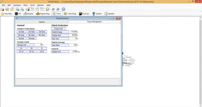

Never heard of clutch protection strategy...is it called torque management?
15guardGT
Dec 8, 2014
91
Rockingham, NC
2015 Guard Green Auto GT
Yes, the protection is actually in the tune..and has to be tuned out..as seen here..and if the conditions are met, it will kill the cars power..
