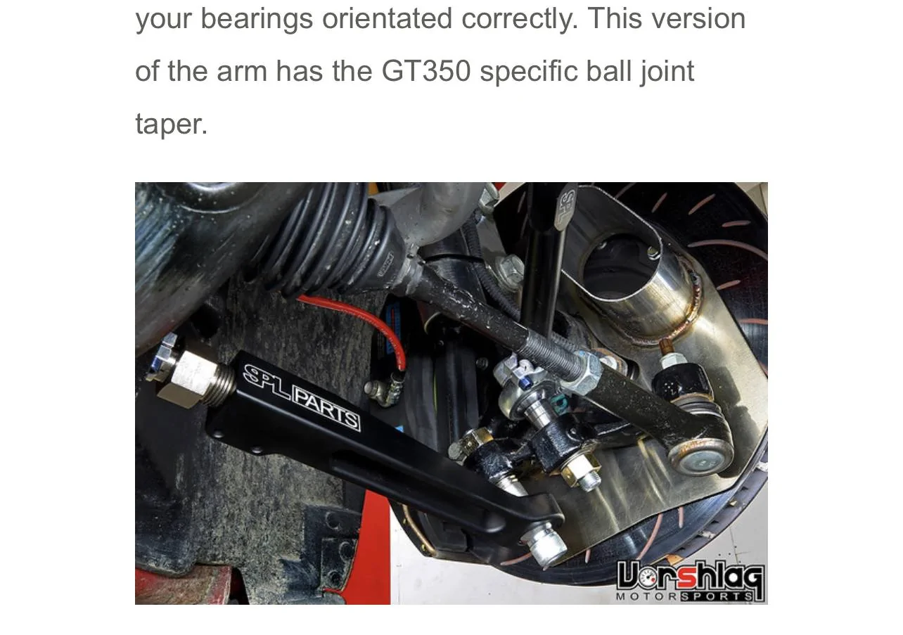

2023 Mach 1 HP
Hmmm nice!!! Edit - go back and re-check that. I found it, it’s the ball joint taper that is different. So you would need the lat/tension links for the 350 for the correct balljoints
