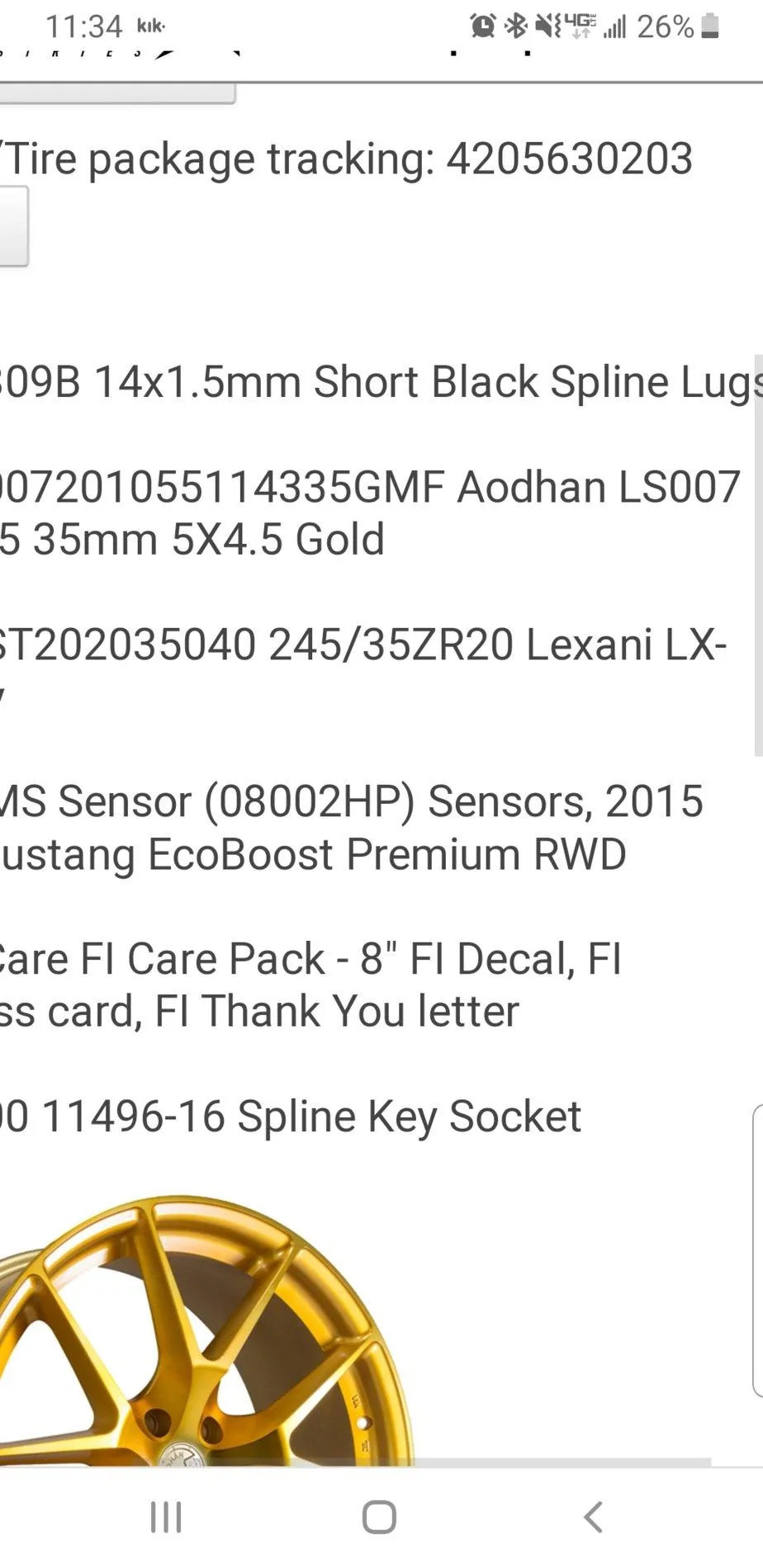

Btw the tires came with this size tires thats what fitment industries recommended.

The wheels are nice but you need to ditch the spacers, maybe do a small 5mm spacer up front to clear the dust caps. The tires are way to small for the wheels though, it's like they stretched a 255 tire on a 10.5" rim and you'll need at least a 285 for it to look right.
Edit: Holy crap a 245, that's meant for a 8.5" rim...just for reference I have a 255 tire on a 9" rim(fronts) and a 285 tire on a 10.5" rim(backs) and the 285 is to small, moving to a 295 or 305 next.
