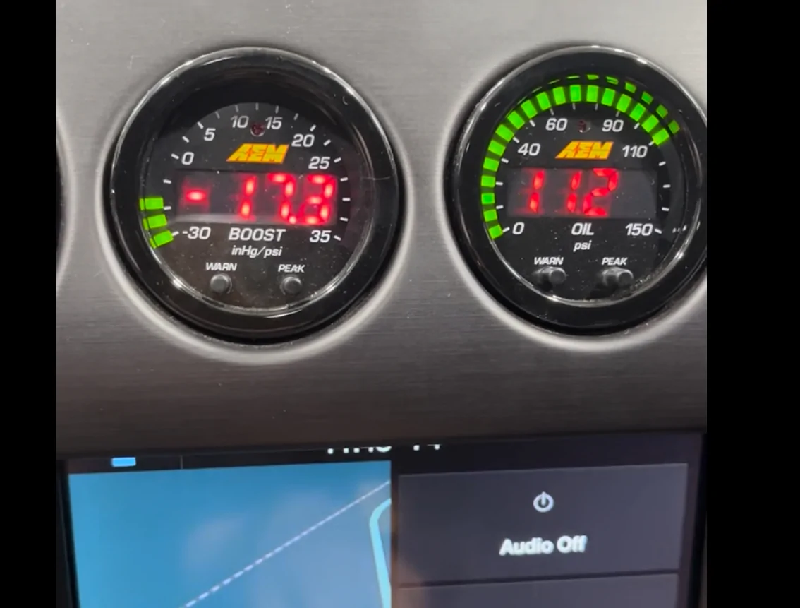

If you have forscan you should be able to enable the factory boost /vaccum gauge in your dash cluster. Theres plenty of videos online how to do it. If you have a digital dash display
Often times not accurate as it is inferred.
Get a real one. Autometer boost/vacuum, -30 to +20

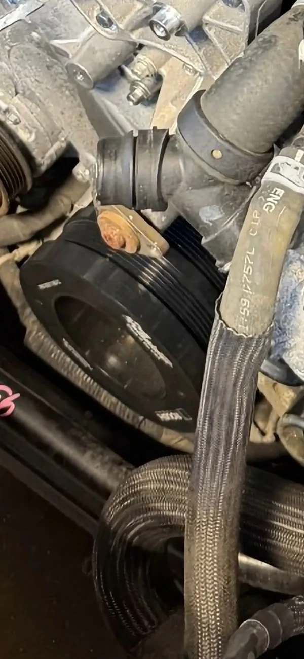

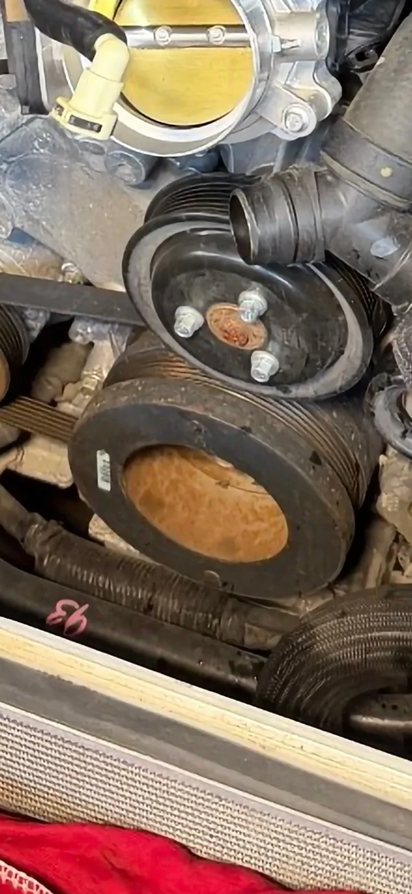

All this talk about OPGs, with zero talk about power level/how much boost you’re running is dumb. If you’re not pullying down, etc then stock OPG is fine. If you’re going for more than 650-700, then it’s not a bad upgrade. High power, high RPMS, running it hard, etc I’d rather spend 2k having them installed (or doing them myself) than spending 10k for a new motor because it broke and spun a chain, et.
