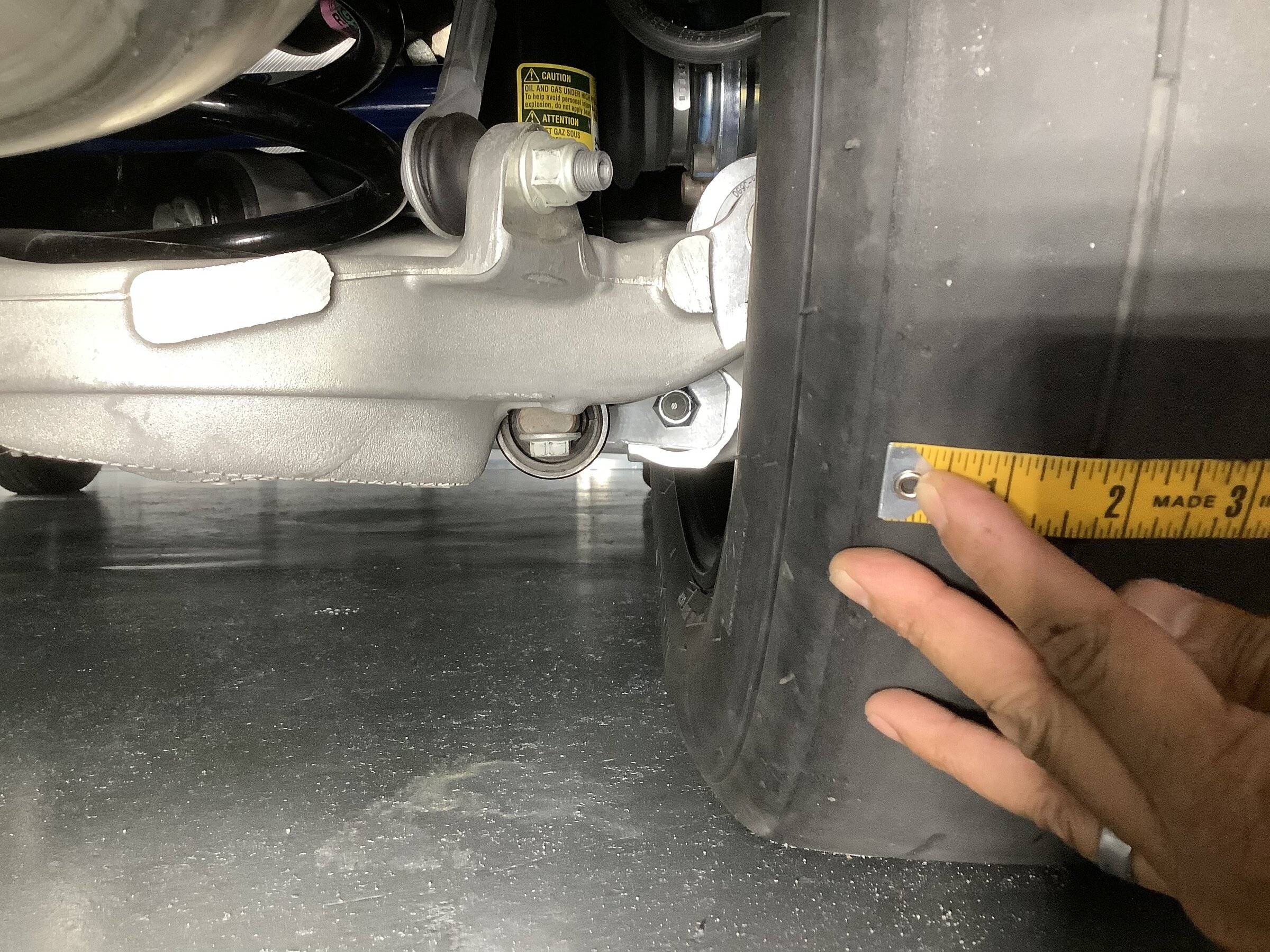

I have MT 305/45/17 ET Street Rs on my car. They are a 28” tall tire. Not sure exactly what measurements you need, but I’m on factory springs and I can fit two fingers between the fender/wheel well and top of the tire.

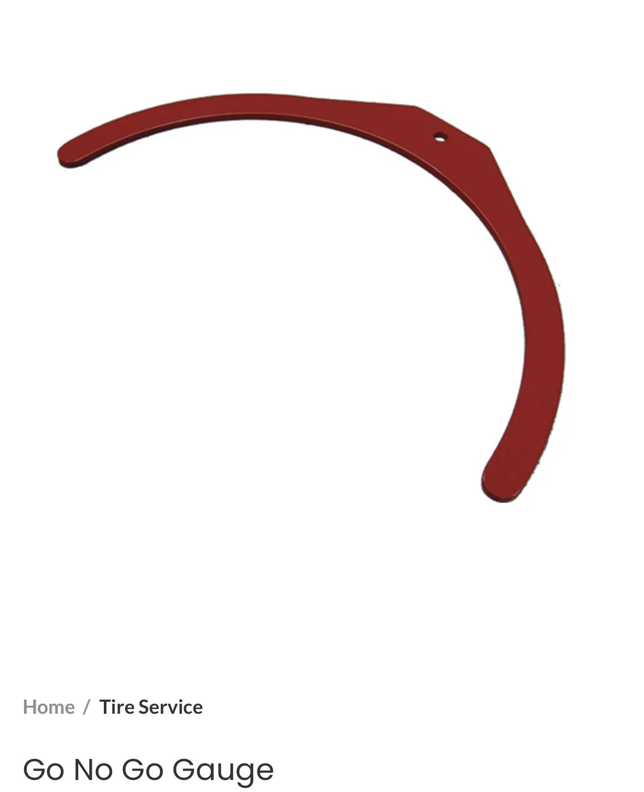

A go/ no -go gauge is just an instrument used to make sure items are within certain tolerances. In your case they are going to use a device to measure your tire to make sure it fits with in the tolerances that you posted above and make sure you are within specifications/ tolerances of the class ( no more than 11.5”s wide when tire is at 20psi).

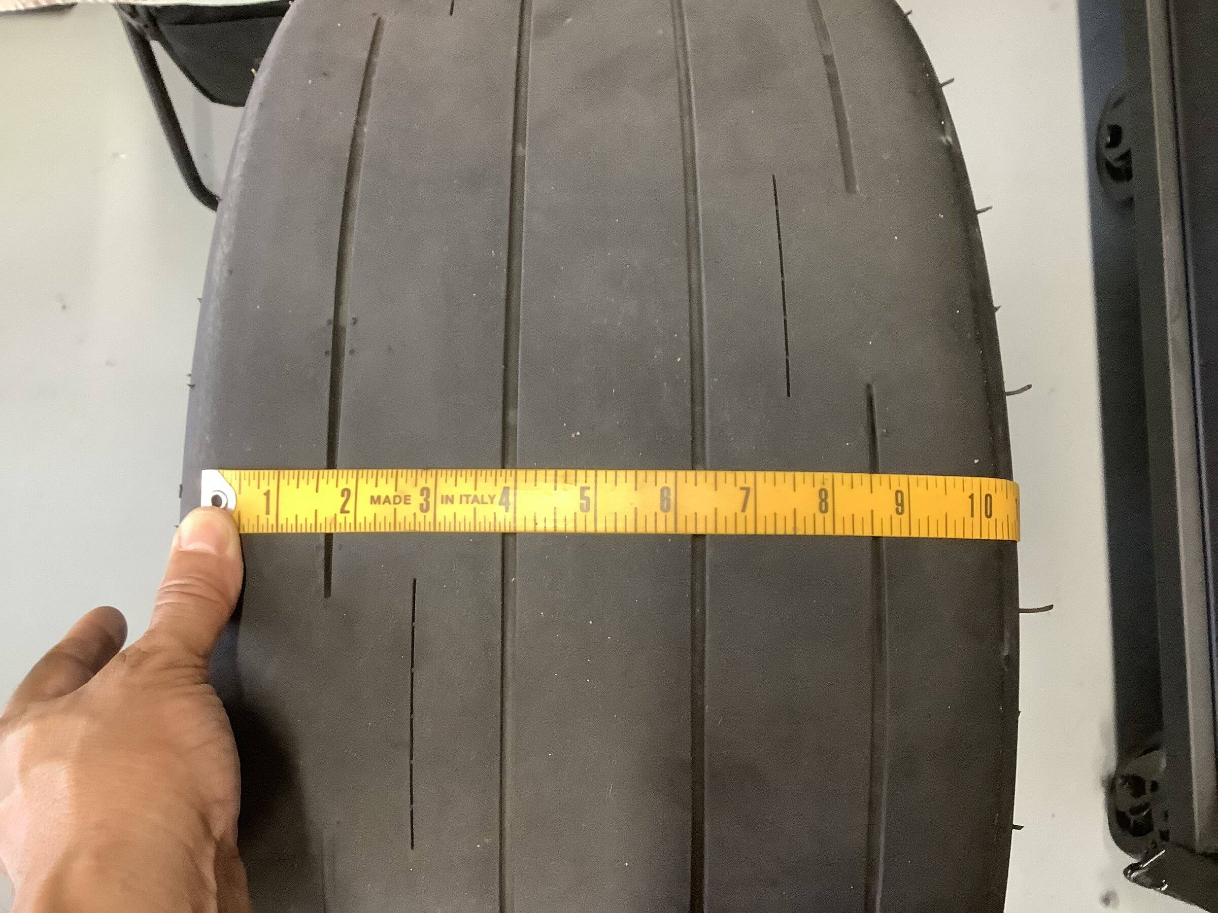

It just so happens that I took the rear tires off today to check balancing accuracy. Here’s what I have for a measurement with the tire off of the car at 26 psi of air pressure. I think you’ll be in compliance with the rules, as the 305/45/17 is a commonly used radial tire for drag racing.

@NGOT8R I wonder what they would measure with weight on them? Probably still be with in the tolerances but you do have to factor that into it all along with them being at 20psi.
For the greater good of the Mustang community, I’ll take another measurement with weight on the car at 20 psi, once I take it off of the jack stands.

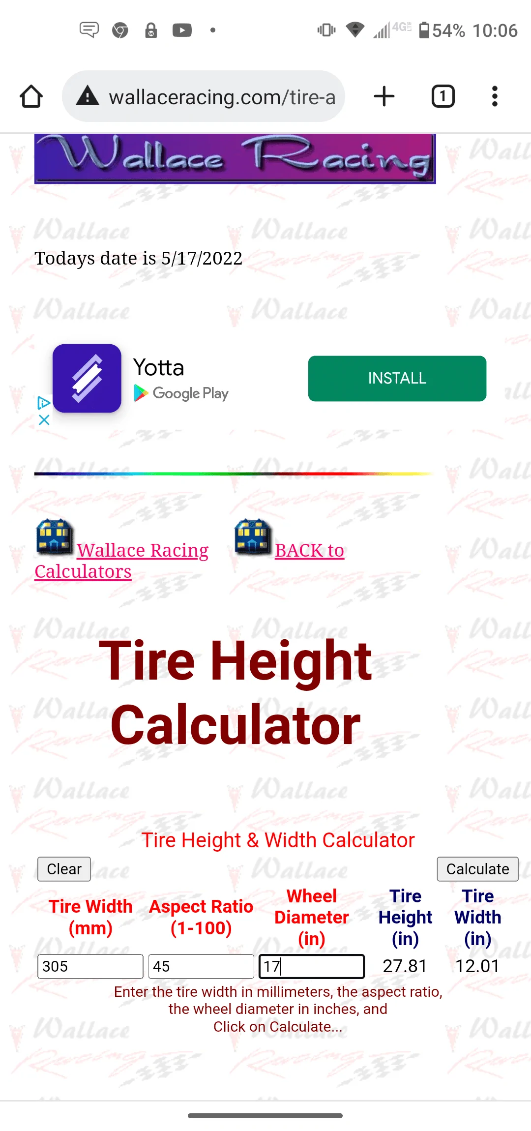

According to Wallace Racing's calculator; The tire is 12.01" in width...
My recommendation,is to run the 275/50R-17 rear tire, plus at set of skinnies on 18" wheels up front.

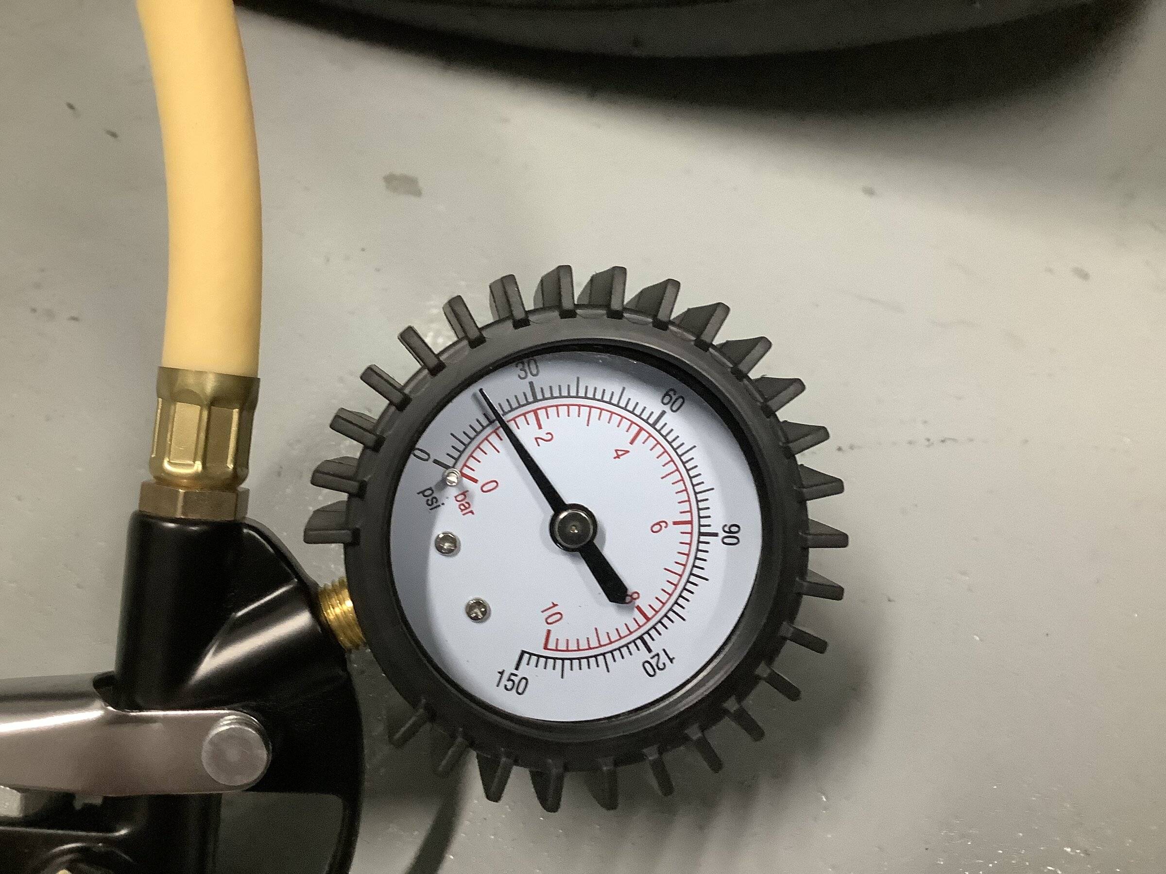

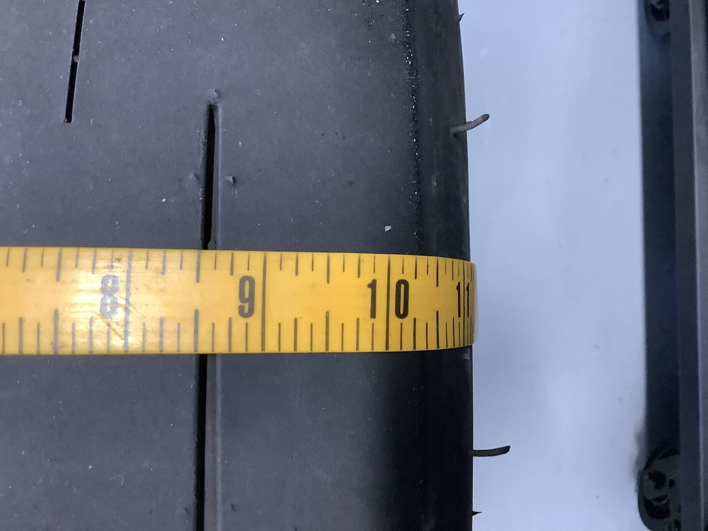

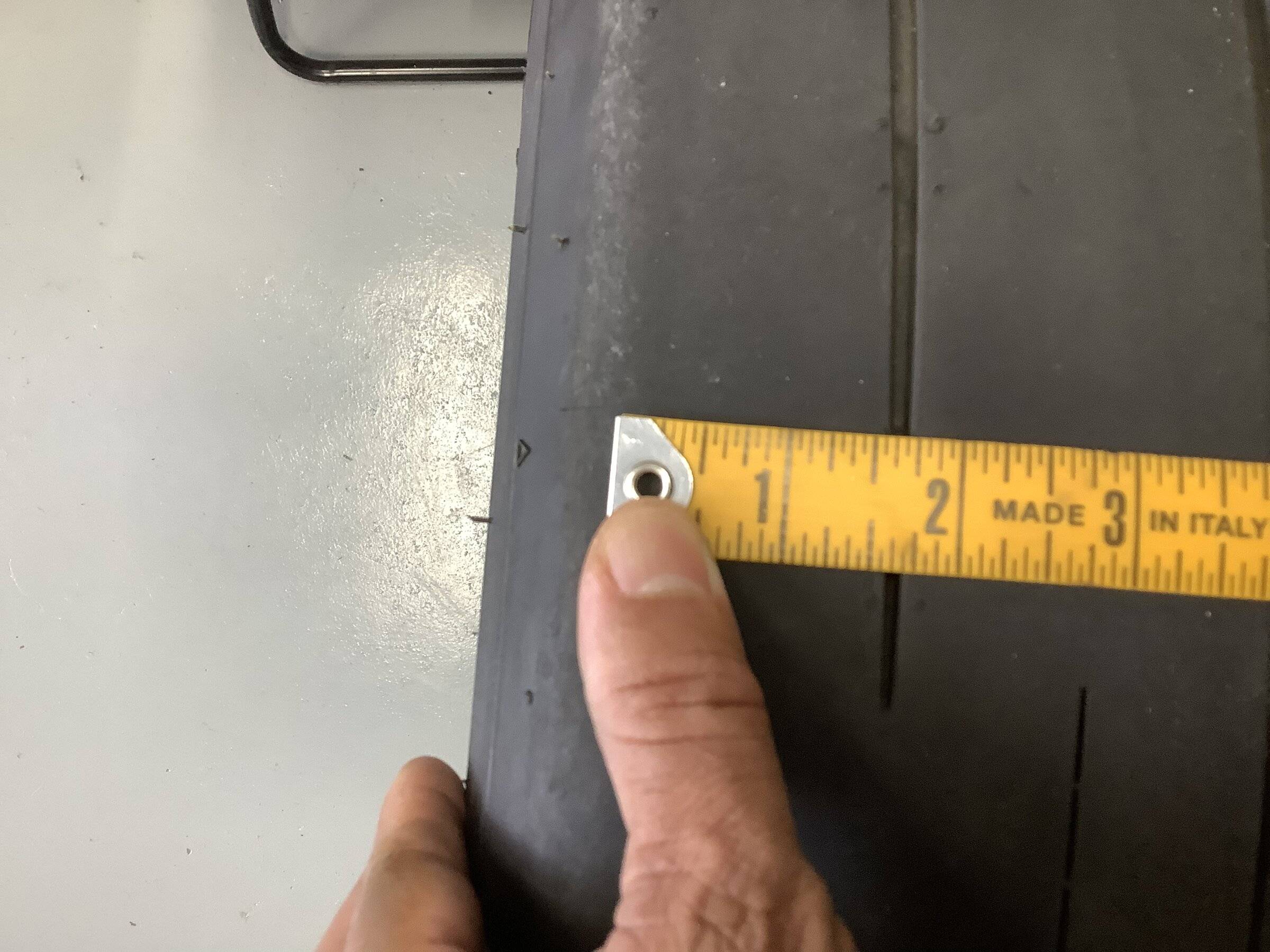

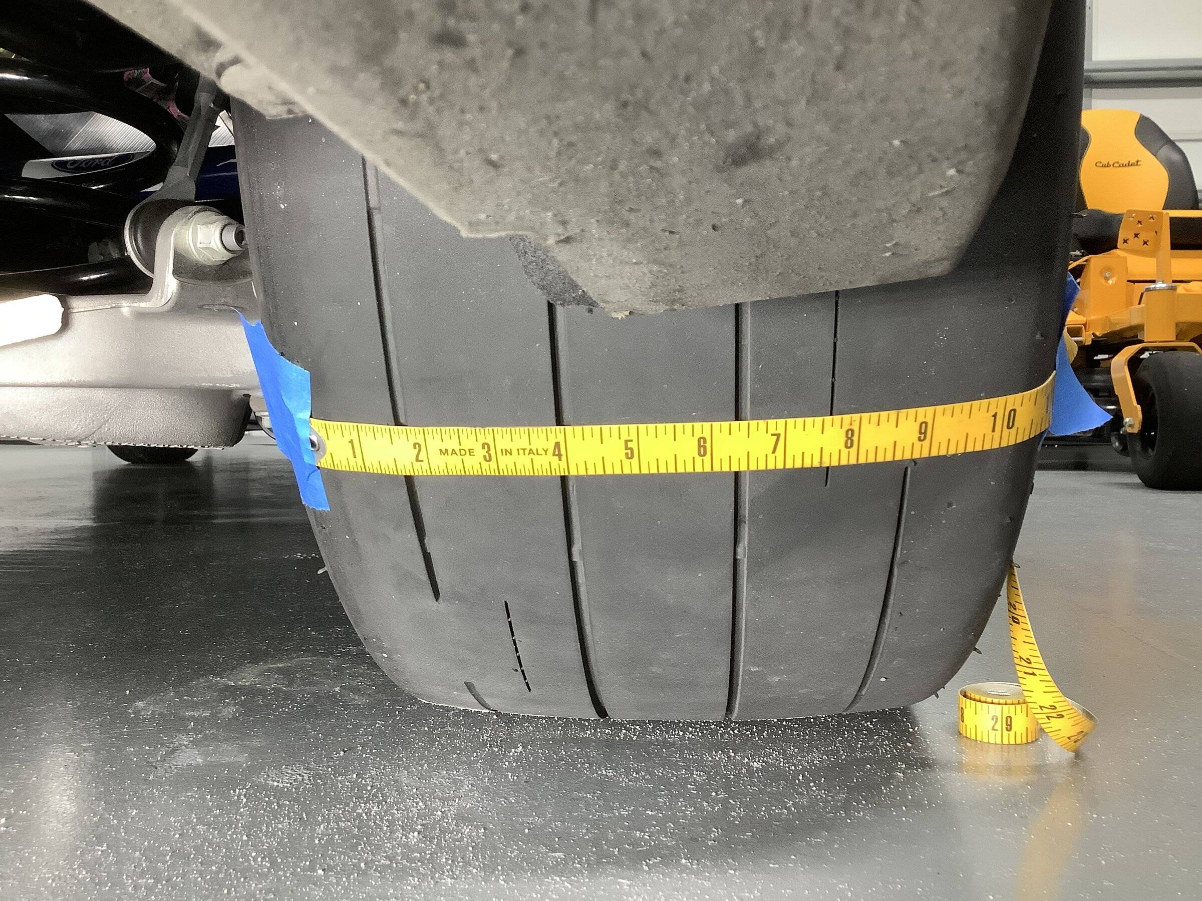

Here are the measurements on my ET Street 305/45/17 Rs folks. The car is back on the ground and both rear tires have been deflated to 20 psi.
