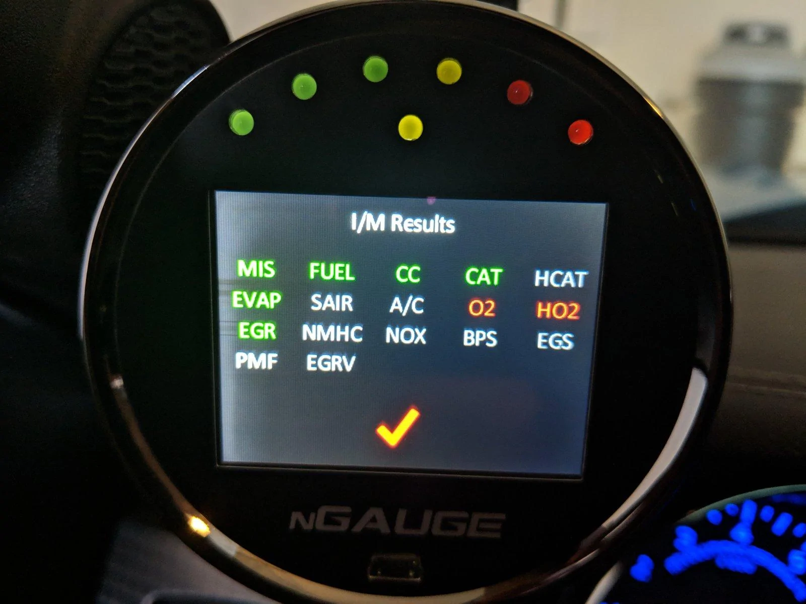

My tune supposedly has them on and I can't get O2 and HO2 to go green. Everything else does and I've driven a good 4,000 miles of city/highway mixed driving. I've got catted headers, but no spacers on the O2's.
I'm going to do some O2 diagnostics this weekend with a scanner before I go back to Lund.

Here is what mine looks like with catted headers and about 5,000 miles while tuned. I think I can still pass with two red, but I'll have to double-check.
