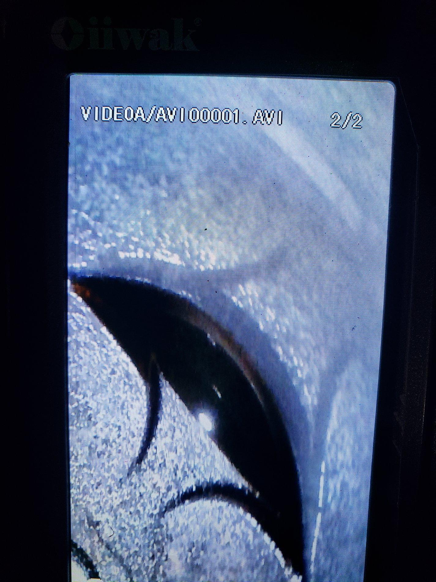

Just another follow up....replacing plugs last night and ran an inexpensive bore scope into the cylinder to see what I could see...quality isn't great but I do believe there is a decent amount of fuel sitting on top of the piston. The scope picture quality wasn't good enough to determine whether what appears to be scoring is actual damage or not. Never-the-less, its more empirical data to give the dealer.

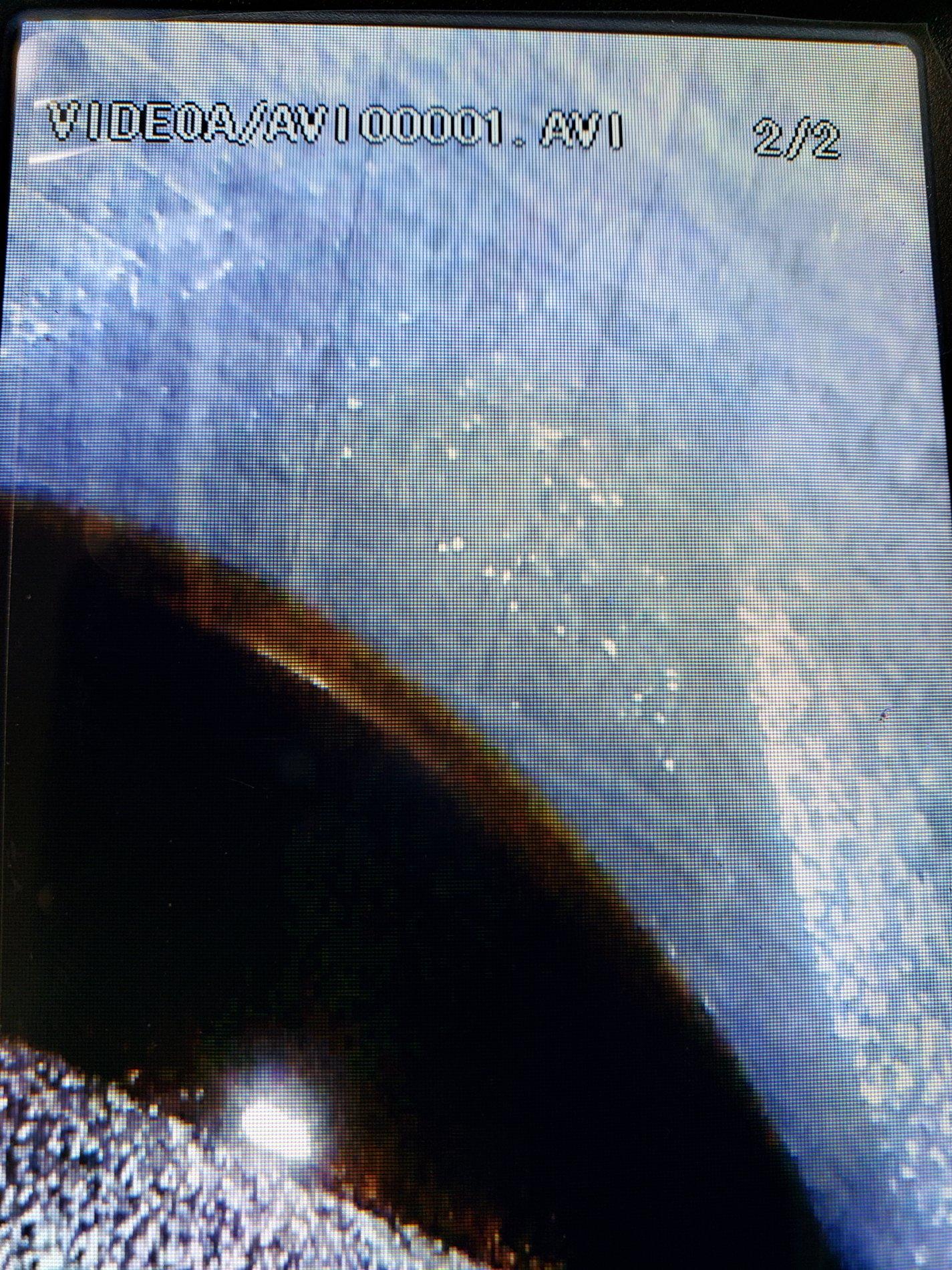

Here you can kind of make out some marks on the walls but it is faint.

That looks like oil, not fuel. Gas is pretty much clear. Looks like you have quite a bit of oil getting into the cylinder. I'd do a compression test right away.
