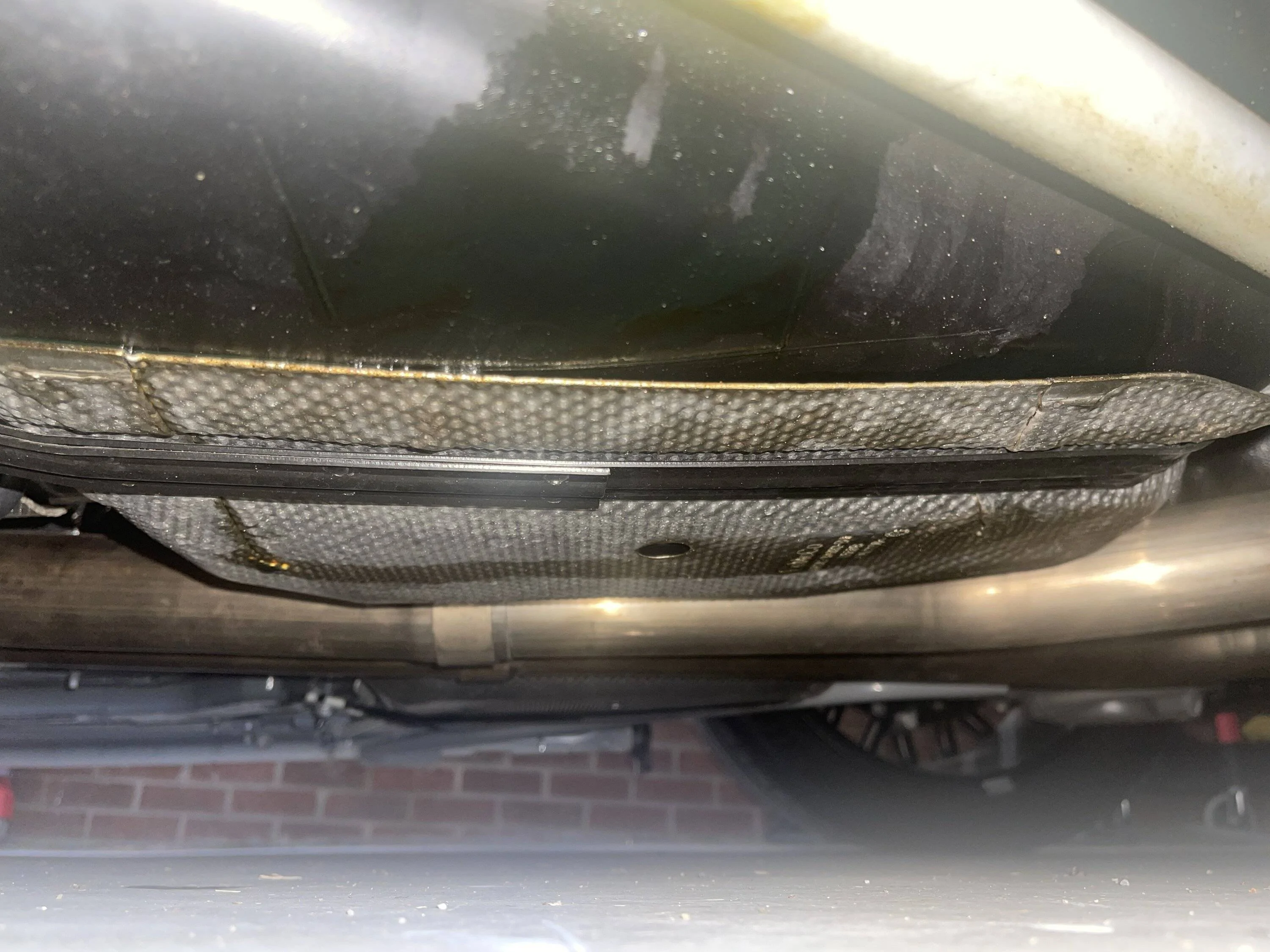

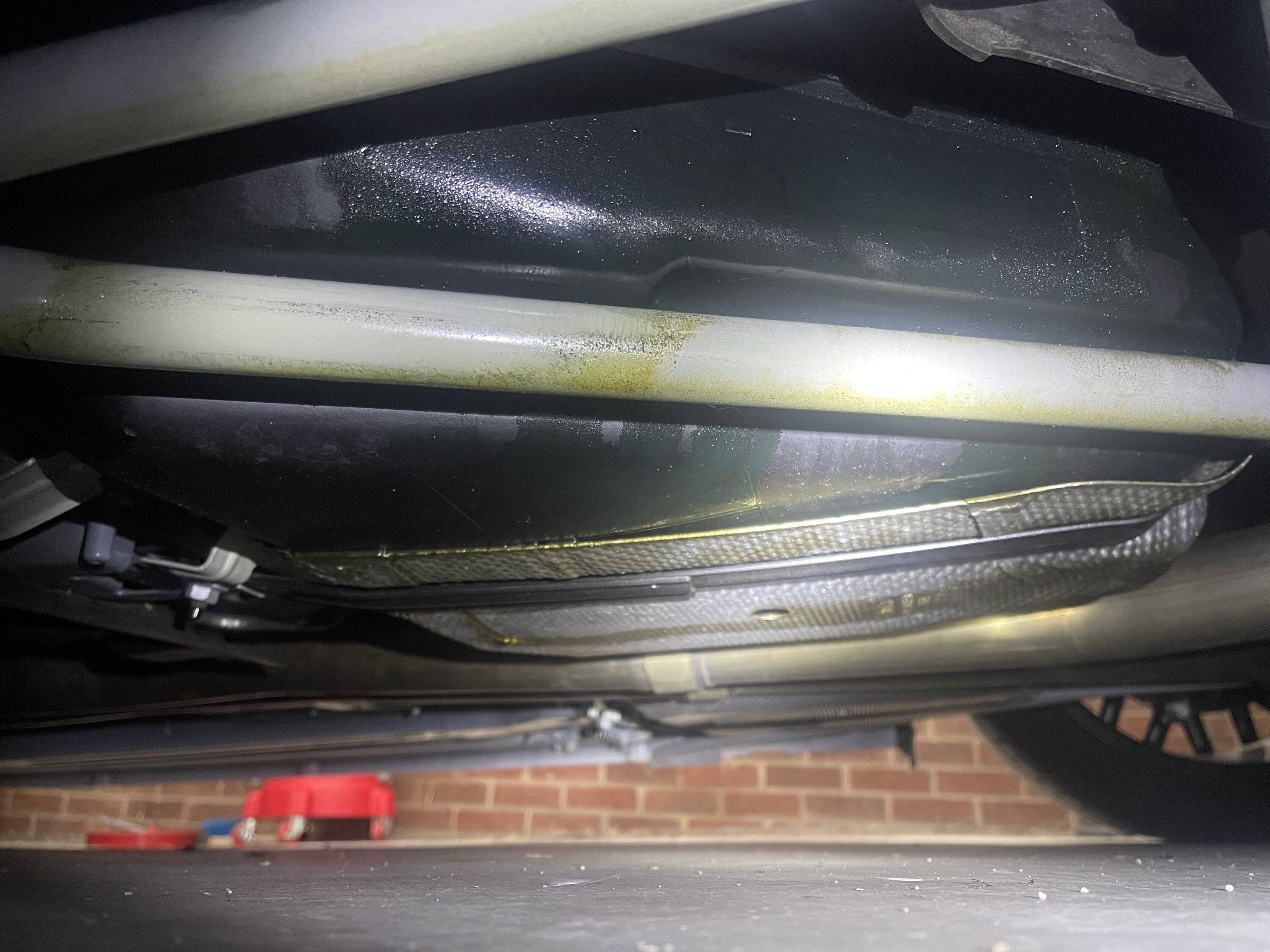

Anyone have there gas start leaking out of nowhere on the driver side part of tank?

That's why you have a warranty. Please let us know what is found when it's repaired.
Good chance something you ran over punctured the tank.

Could be the filler neck maybe? You need to find the source...

This. You need to know where it's coming from. Could be filler neck, return line, a bad seal or???
If you have a borescope you may be able to find the source with that. If you have to drop the tank, or have it done, try to have as little fuel as possible left. A full tank is heavy and awkward.

It’s only with a full tank of gas I’ll get it up in the air once I gets some days off I hope it’s just a gasket.

You can also remove the back seat cushion and access the top of the tank through the rubber covers over the fuel pump and sending units. A bad O ring seal could cause the leak.....
