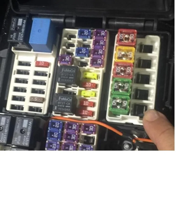

I pulled the 'fun' plug when I did my dyno as per Whipple's instructions.
As you can see, the plug has a loop of wire on the side you are unplugging, this circuit is the keyed power to the ABS/TC module, so by unplugging it you are only disabling the TC/ABS system.
Pulling the fuse works equally as well on the Dyno, but I believe the fuse may feed other modules like some have stated (without looking at the power distribution diagram).
Here's and easier way to look at the issue.
There is a reason that plug is there with a loop of wire on one side, and easily accessible under the hood.....it's for dyno testing at the factory. Stands to reason, you would use it for your dyno as well.

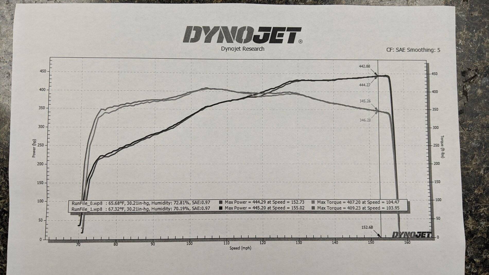

On a bone stock car on a dynojet, I did a run with the plug plugged in and one disconnected.
Connected: 444.29 / 407.2
Disconnected: 445.2 / 409.23
Pulls were back-to-back and there was a bit more variance between 110-130 mph.
Cute. Means nothing. The discrepancies are due to when he went WOT, and at what RPM he went WOT. I've said it before. Turning off the nannies via holding the the button is all you need to do.
I wasn't making an argument for or against it, just stating the result. IMO, I agree with you after looking at this. I had heard people talk about major differences before which it why I was curious to put it to the test since I was getting 2 pulls anyways.
