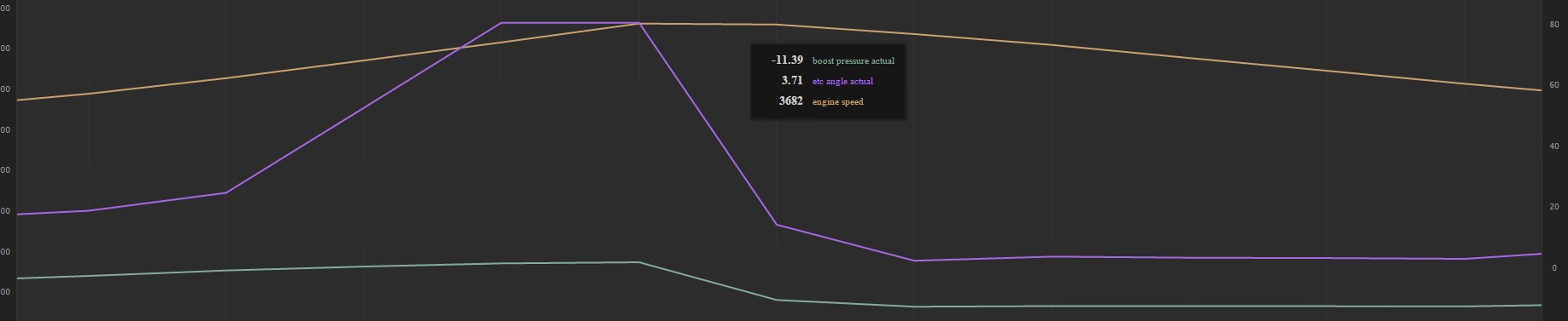

Because a 10psi spring is going to be too stiff and the car doesn't produce enough off-throttle vacuum to open the BOV 100%. There is potential to cause compressor surge and damage the factory turbo.
Spring color is silver with black line. You can view Tial's spring chart HERE.
When choosing the proper BOV spring you need to monitor what your immediate off throttle vacuum is. Here is an example from a bolt on EBM.
You can see the purple line is coming down which is the throttle closing, the green line is boost/vacuum, and the orange line is RPM. This shows a shift event that was in boost prior to letting off the throttle, this is exactly how you want to determine the proper spring. You can see here it is -11.39inHG which falls into the 7psi spring range.
just to clarify this
Tial's 7psi spring is actually painted black
Turbo Smart's 7psi spring is metal/silver with a black line
:thumbsup:
It's basically the same :p. Tial just does a quick spray with some paint at one end, its never a solid color.

I'd recommend dropping it down to a 7psi, just personal experience I have had thus far with the stock turbo and the vacuum these engine's produce.
Why black? Black is rated 8-11in/Hg. Ecoboost is generating ~20in/Hg in idle, means shouldn't it be Yellow or Plain.
