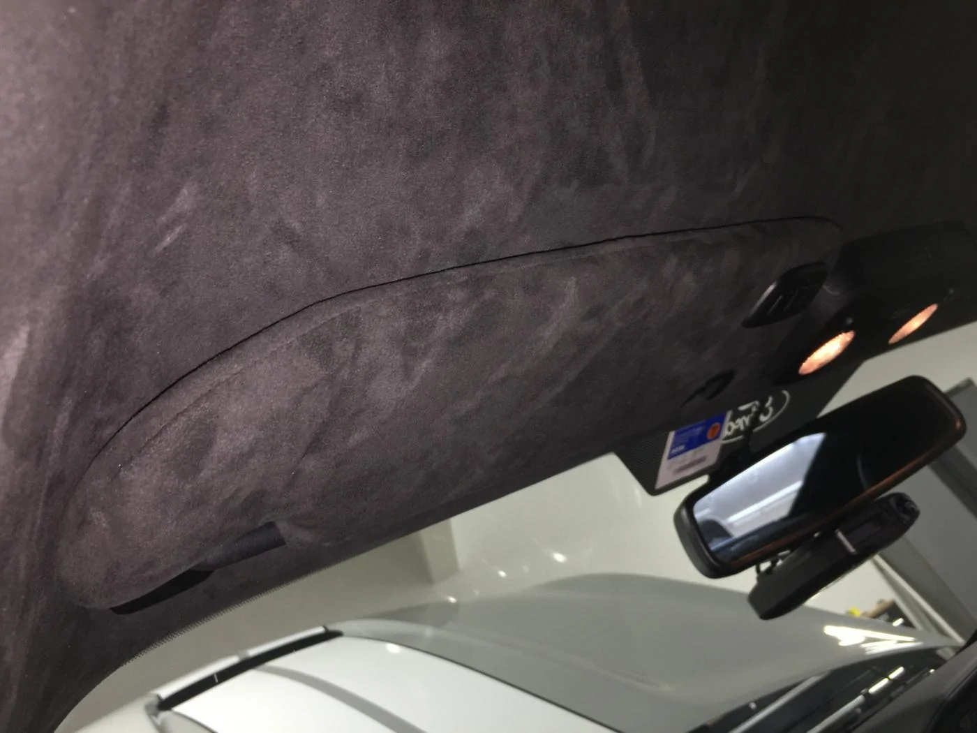

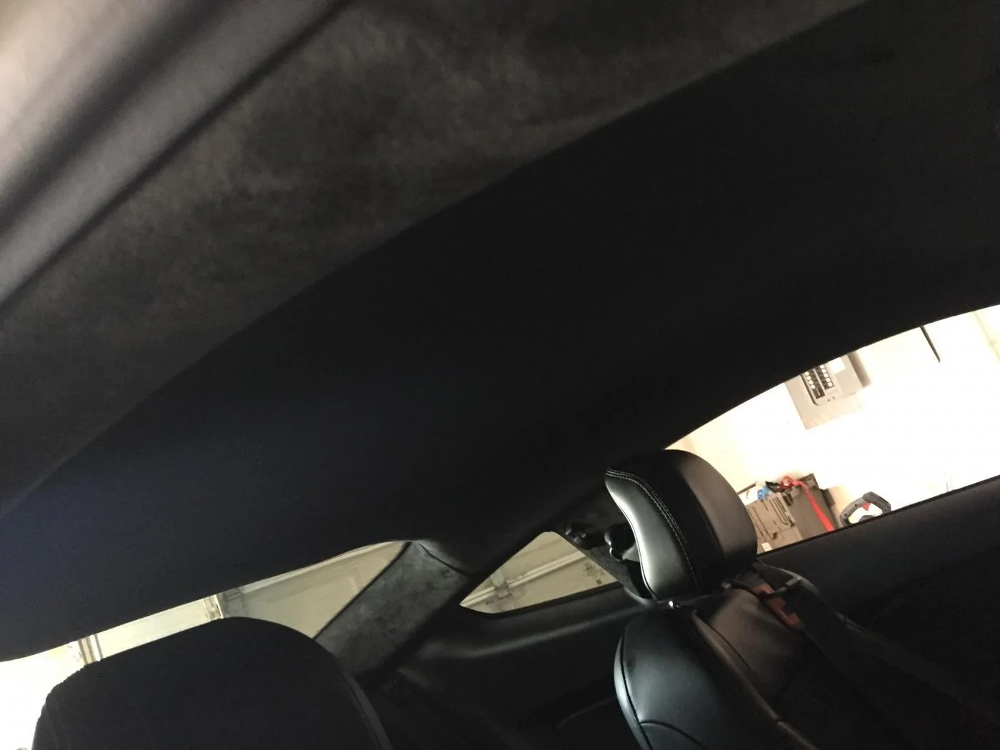

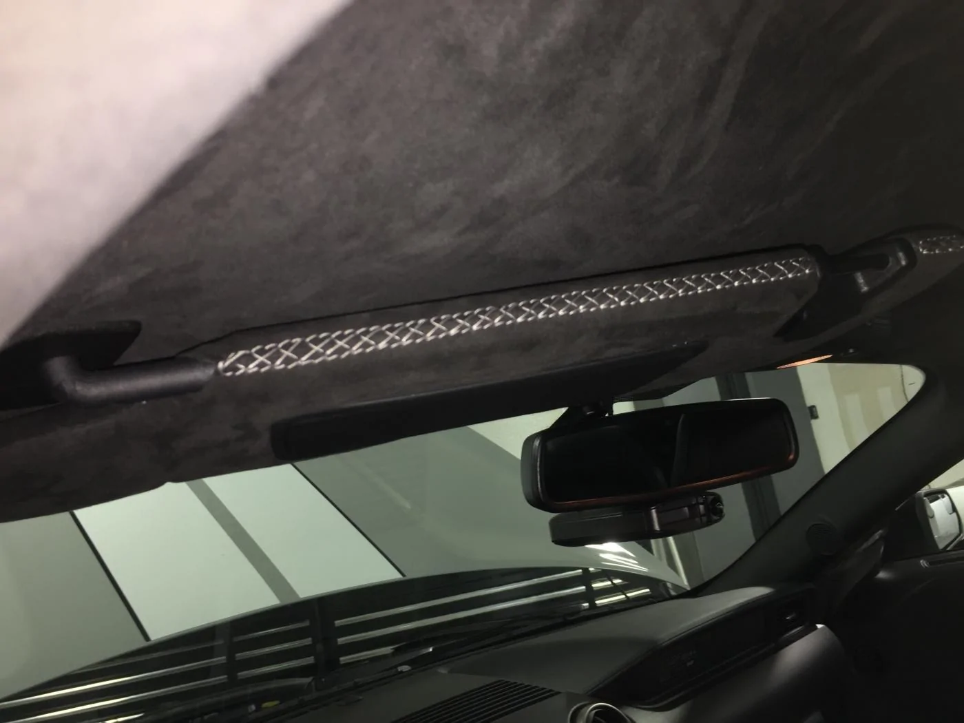

can you share a link to the materials used. looks awsome!
I got the shifter boot, ebrake, and arm rest from cjponyparts.com they are JPM coach works which is now defunct. Americanmuscle.com also sells them.
JPM still has his other company jpmsuplyco.com he sells the real Alcantara material which is made in Italy and what Shelby used on our cars. I used 9002 charcoal "panel" which doesn't have the backing so its easier to wrap around your trim edges. The invoice included will be from some Germany company which is the distributor and ships directly to you. The code on that will be 9202 for panel its the same product. From order to at your door is 3 days. The edge on the material roll is embossed "Alcantara" so you know its real. You need 1.5 yards for the headliner and quarter windows. I ordered 3 yards it was enough to do the visors plus sides and back of the center console along with the headliner and quarter window panels. I have enough material left to do maybe the glove box lid.
If your car is a track pack with the recaro's there is actually 2 different colors on the seat. 1) charcoal which is the minor color and 2) black which is the major color. My charcoal wrapped items balances them out equally.
The painted parts was done by Automation auto body to the standard paint code using Spies Heckler paint which is also German.

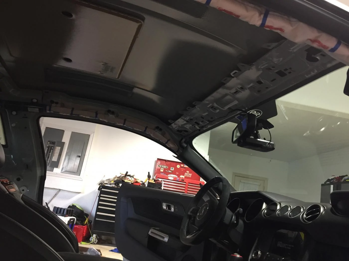

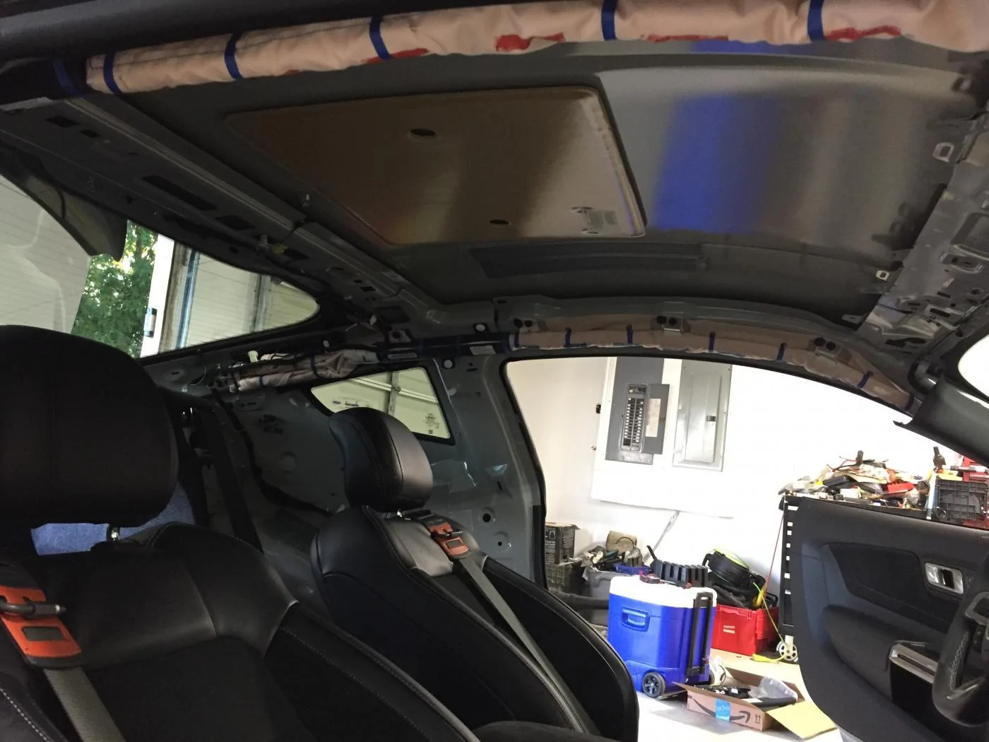

A few pics with the headliner out took less than an hour to remove everything this was my first time working on something like this but I am mechanical inclined.
