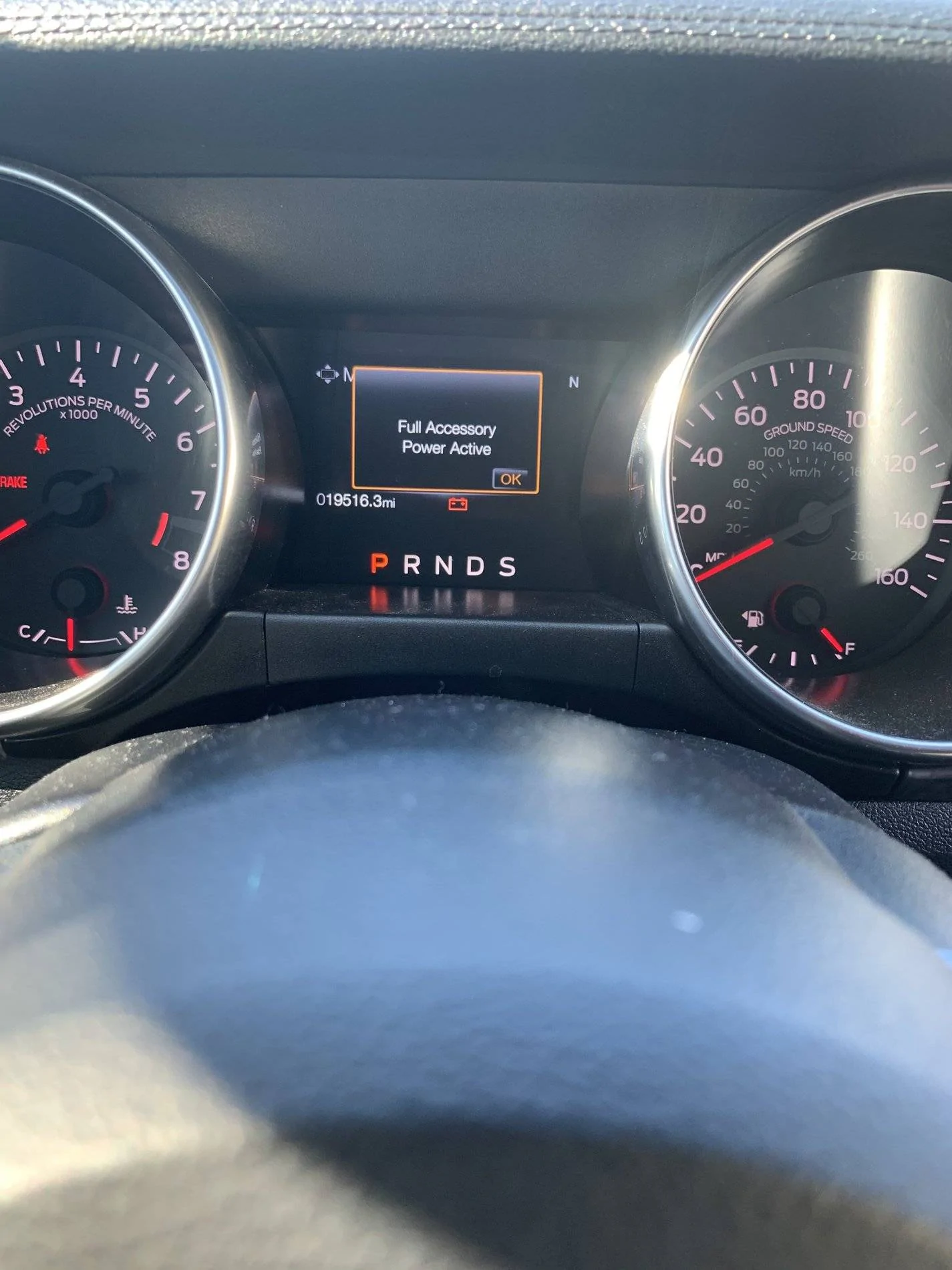

This is the message & symbol that appears when my car suddenly shuts off.

That message comes up when the electronics are 'hot,' but the engine isn't running (you should get that the first time you hit the 'engine start/stop' button, before startup). You should still be under warranty; take it to a Ford dealer.
