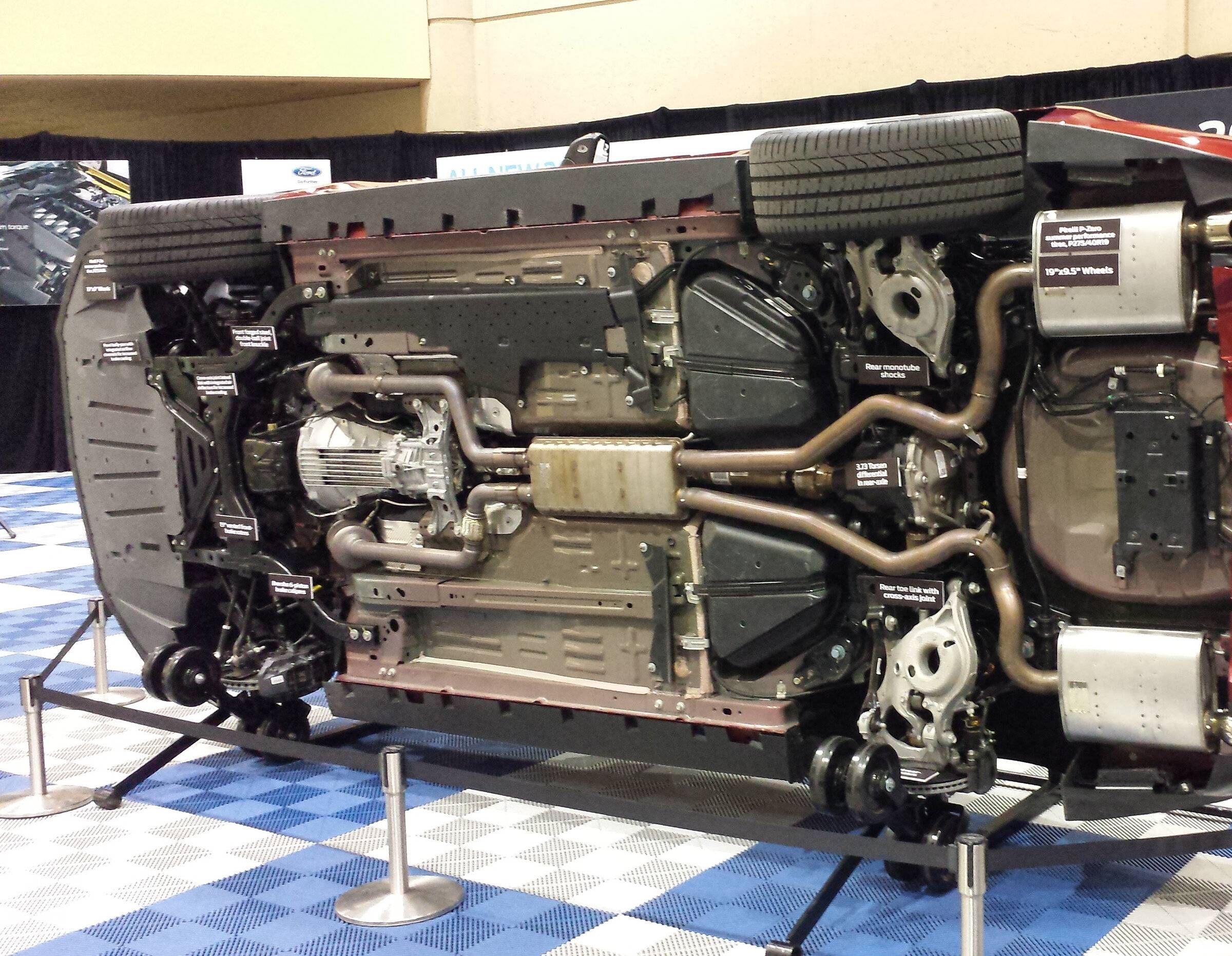

Alright fellas, looks like I drilled into the top of the tank by accident while making the hole for my rear seat delete. It's right at the top where the hump is in the middle. I can smell gas so I'm pretty sure it's punctured. I stuck some JB Water Weld in the hole to patch it temporarily. I ordered a new tank today because I'm a little nervous about fuel potentially leaking since the exhaust is down there.
Anyone know what's involved in removing the tank? I assume the Diff needs to come out. My mechanic said he can do it, but just curious if anyone has removed their tank before? Pretty annoyed with myself right now.

I believe the entire rear subframe, diff and all needs to be removed to get it out. I haven't looked at the shop manual for that item though.

According to the shop manual for my 2016, the exhaust and drive shaft need to come out. The rear cradle/differential can stay in place.

Thank you sir! That sounds much easier. Was worried about the subframe not aligning correct again. New tank will be here today.

Looks like:
* Unplug everything up top (you get to take your rear seat delete out),
* Remove exhaust,
* Remove drive shaft,
* Remove two straps,
* Somewhere in list is unplug(?) filler tube.
