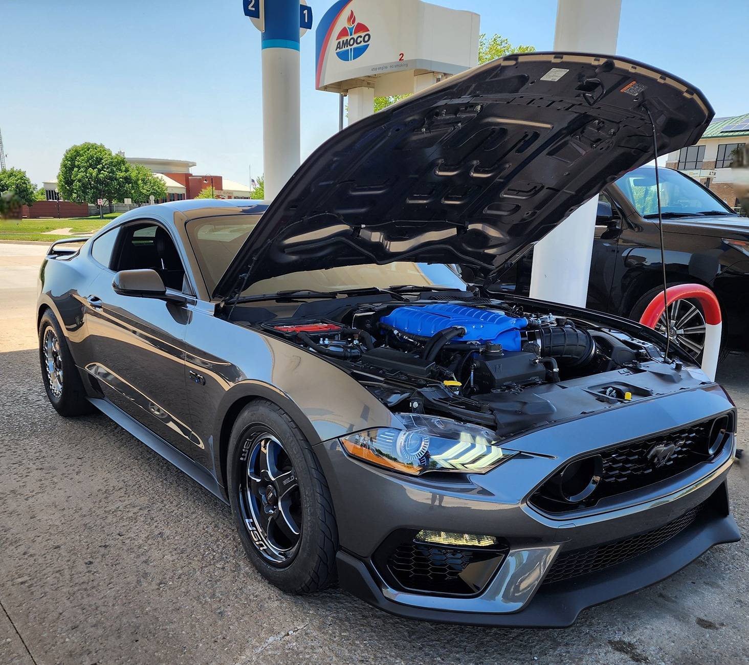

I installed a gen 6 stage 2 whipple last weekend and am trying to install a fuel pressure gauge to keep an eye on it. It looks like the only place I have room to pull fuel from is the front of the driver's side fuel rail. My issue is that it is a -6 orb and the sensor is a 1/8th npt (it's all autmeter). I've had some people say I should adapt it from the -6 orb to a -4 and then remote mount it but im trying to figure out what that looks like. There is very little room and as it looks I would need an adapter from -6 orb male to -4 an male to a -4 and female 180° fuel line to the fire wall and then I'm not sure from there. Any advice is appreciated. Pic of the whipple install for attention.

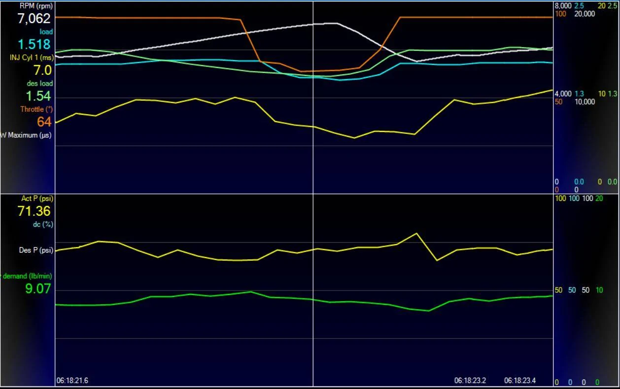

Just a PSA here, but wanted you to understand how it works. The gen3 measures fuel rail pressure in the rail at a dizzyingly fast data rate, for both the PFI and GDI sides. It then extends or truncates the injector pulsewidths as needed due to fuel pressure fluctuations. The logic is also always calculating the maximum port injection "window" (time available to inject fuel during any given cycle) and comparing that to the required injector pulsewidth to achieve desired A/F ratio. When the logic determines that the needed pulsewidth *would* exceed the PFI window, it converts the available fueling to an airflow, to a load, and finally to a torque, then modulates the throttle to achieve the calculated airflow limit. See, the actual fuel pressure isn't, by itself, a problem. It's only one input into lots of math that ultimately will close the throttle to maintain desired lambda. I've run into this limit a few times and I have datalogs where you can see what's going on. Instinctually, when I feel the loss in torque I back out as fast as I can, but when you see the data log you can see that I was painfully slow as compared to the lightning fast response of the PCM.
That said, all those OEM protections that could and should work to our advantage are often disabled by tuners, even unknowingly. The torque model, injector data, TB model, and safety factors must be accurate, and protection "switches" remain on in order for it to work.

Again, just FYI but here it is in action:
The fuel pressure is actually fine, but the logic predicted that it *would* run out of available injector pulsewidth so it cut the throttle to ensure it wouldn't go lean. I didn't even know this happened until I looked at the log, since it only partially cut throttle from 6700-7100.
