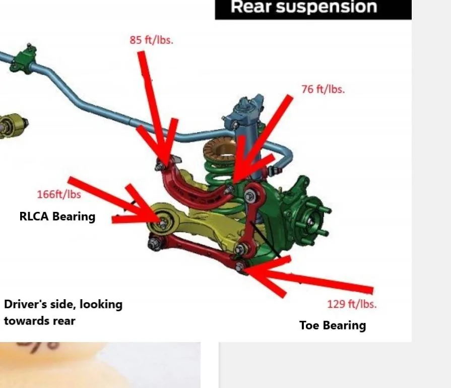

Yes they do. You can just barely see them on the struts in the picture, and the rear shocks have them too (under the dust boot).
That part is not the toe bushing, that is the RLCA bushing that is equivalent to the BMR BK081 or BK055 bearings. The RLCA connects to the subframe in two positions; the rear position has a bearing from factory but the front does not. This part is notoriously troublesome to upgrade because of the awkward shape of the RLCA and the factory bushing is extremely tight.
The SuperPro part (or BK055/BK081 or the Steeda equivalent) goes where it says "RLCA Bearing" in the attached and the FRPP toe bearing (M-5A460-M) goes where is says "Toe Bearing" in the attached. From the factory, both of these are bushings, PP or not. The other end of the toe link (beneath the RLCA bearing in the photo) is a bushing on non PP cars but the PP toe link has a bearing instead.

Ah ok that pic helps a lot. Thank you for your patience. I always thought the other end of the toe link connected to the rcla bearing/bushing. I will now get the PP toe link, the toe link to knuckle FRPP bearing and the superpro rcla bearing.
