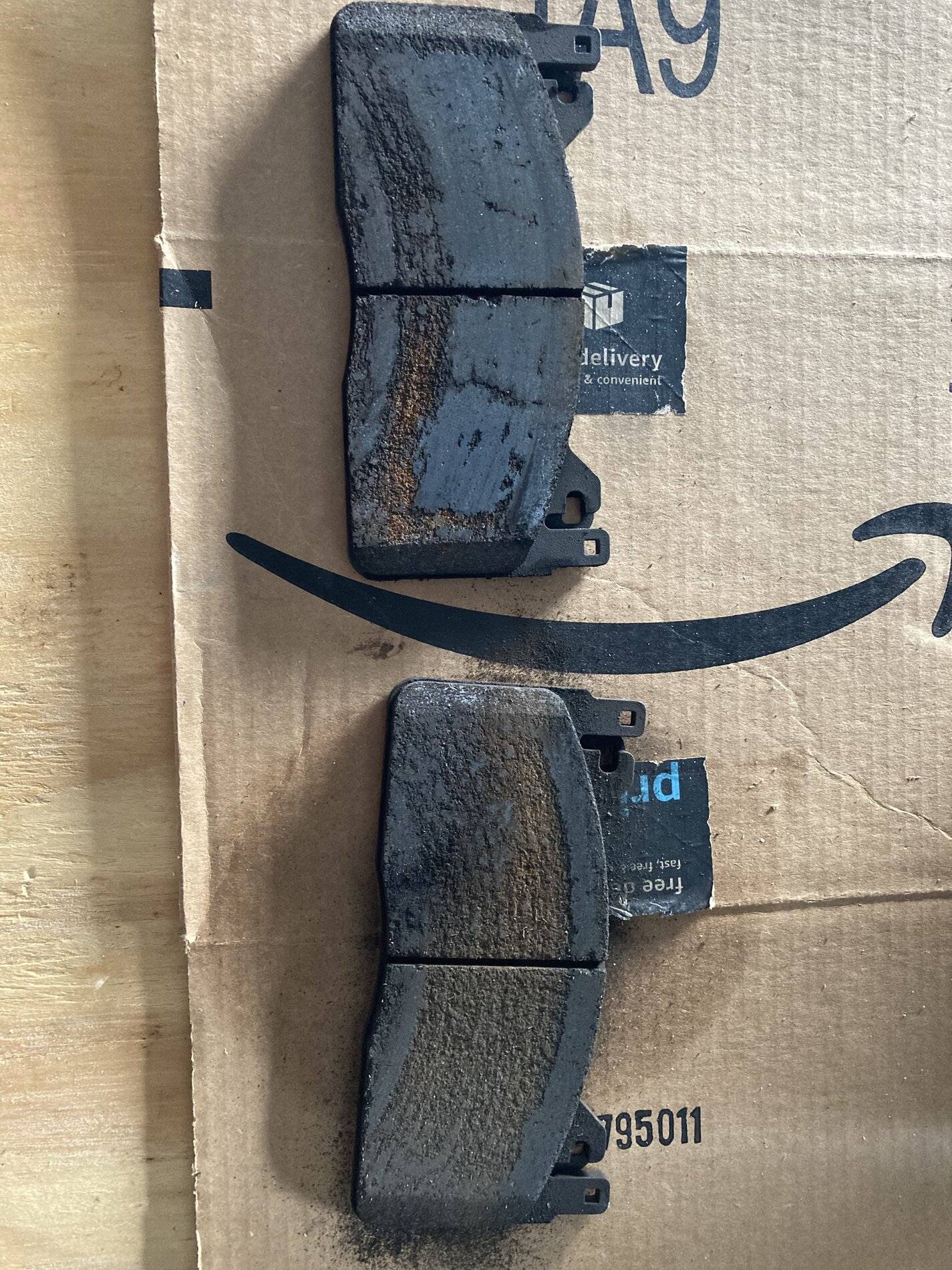

My two cents are the OEM pads work great on the track until your skill level reaches a certain point. I did four track days and 14k road miles on the original pads. I replaced the front pads with OEM and returned to Sebring for a day at the track. I noticed on the way home the noise while braking at street speeds was much louder than normal. When I pulled the pads, this is what I found:
That is from one day at Sebring. Granted, I am now going much faster and braking much harder, but it was a shock that I only got one day.
I am experimenting with Hawk DTC-60 this coming weekend at Sebring. I plan on only using those for track days; I'll switch back to OEM for street driving.

Wow. That doesn't look normal. Seem defective.

As @Caballus said, that's not normal. Those pads are damaged and scorched, but they're not worn out. Are you absolutely sure they're not fake? What about the rotors? Are they ok? If you got that much damage on the pads and you didn't boil the brake fluid, then something's just not adding up.

The brakes worked fine stopping me from speed. I was getting vibration though. I now not only have new pads, but four new rotors too.
The damaged pads, if fake, were very well done. Ford box and sticker that showed the part number. I ordered them from a Ford dealer via the Web. I think it was Lakeland Ford.
I have never had an issue with brake fade or the pedal going to the floor. I think I'll chalk it up to defective pads. Or perhaps I just put too much heat into them. I am getting faster.

Well then, they're probably real. But wow, they look really toasted.

Be interested to see what the rotors look like after that.

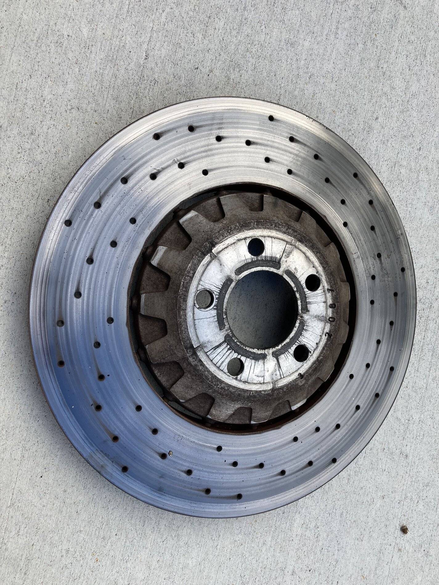

I don't think the rotors look bad, but they are warped. This rotor has 16k road miles and 5 track days on it. Granted, days at the track as a noob are not all that hard on brakes.
I am still amazed at well the brakes on this car work. I have many scary memories of asking too much of the brakes on my 65 Mustang and 89 LX 5.0.
