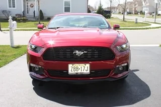

Went ahead and ordered the Craigs custom bracket!

Good. Just a couple of hints.
1. Make sure the portion of the bumper where the bracket attaches is super clean. Also heat it up a little with a heat gun or hair dryer.
2. Do not use a heavy license plate frame like I did. Go with something lightweight or none at all. Mine started to pull down. I took off the frame and all was well.

I just installed Craig's bracket and like it so far

Will do, ill make sure to give it a good alchohal wipe down too.
I wasnt planning on using a frame at all, just straight plate. Will that work?
Thanks for the tips!

From the Craig's site.
We did not test this mount with any heavy metal style license plate frames, only plastic frames and covers.
* NOT MEANT FOR USE WITH HEAVY METAL STYLE LICENSE PLATE FRAMES.
I had a metal Mustang 50 years frame on the car for almost two years before i noticed that the bracket was pulling down. I would stick with a silicone or plastic frame if you want one. Otherwise plain is fine.

I have the Craig's one as well. It works.
Just make sure you have a super clean surface. Install on a warm day or warm up the surface with a hair dryer. The kit comes with adhesion promoter that creates a strong bond with the VHB tape. Let it sit 24 or 48 hours before attaching the plate bracket. All this info is in the installation instructions.
