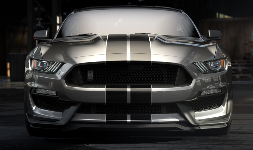

Yeah thats the reason why I didn't do the grill delete. I liked the look but I know ford must have had a good reason to block of the grill and the gt350 also has the grill blocked off.

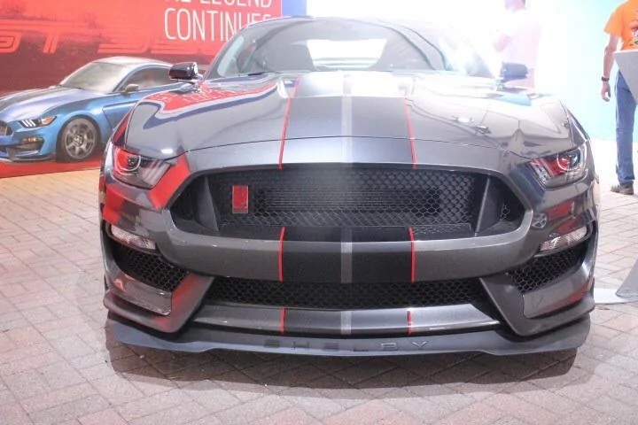

Well that looks legit and it looks like the cutout is even smaller on the 350 than it is on the GT. Now im curious why they are doing that.

I agree with Trackaholic here but also wouldn't have a problem opening up a few extra holes only where the air intake tube is.

The amount of opening in the grill is carefully chosen by Ford to do a number of things. Get enough air to cool the radiator, limit the air entering the engine compartment to decrease lift and improve aero for fuel mileage.
Now can you benefit from opening up the grill more? Possibly if you remember opening the grill is only part of the system and what you gain in one area you might lose in another. To increase air flow through the radiator and not adversely effect other things you have to allow for more to leave the engine compartment if it leaves through a hood vent and fender vents like the GT350 you can afford to have more opening in the front. The GT350 doesn't need a lot more air going through the radiator it is still a naturally aspirated car and makes 525 at the crank. A car making 625 at the crank and using a supercharger or housing turbos in the engine compartment has good reason to want more air flow through the engine compartment, heat exchangers and radiator.
