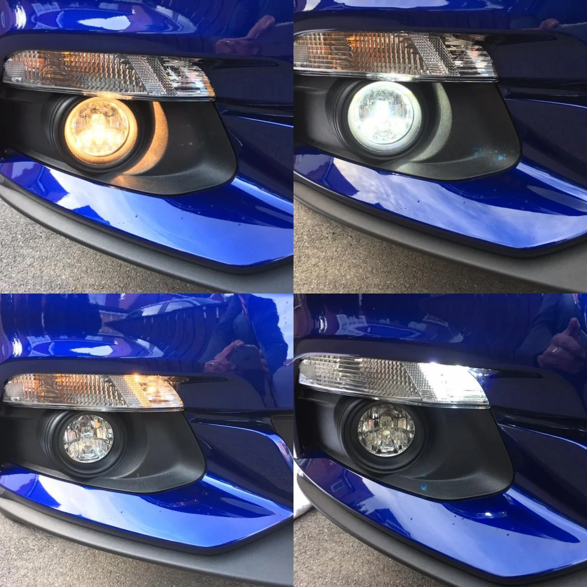

Konik DRL bulbs just landed, ÂŁ6 VAT added ... no problem with that, again though ÂŁ8 Royal Mail International handling fee. That bit grinds my gears, international handling fee my arse, they haven't done anything.
