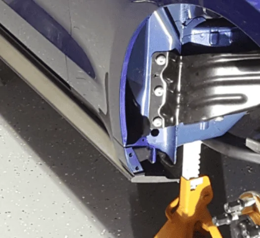

Just for completeness, photo confirms all three holes are round :
I randomly found the photo on a post that BMR had done about jacking rails !
WD :like:
