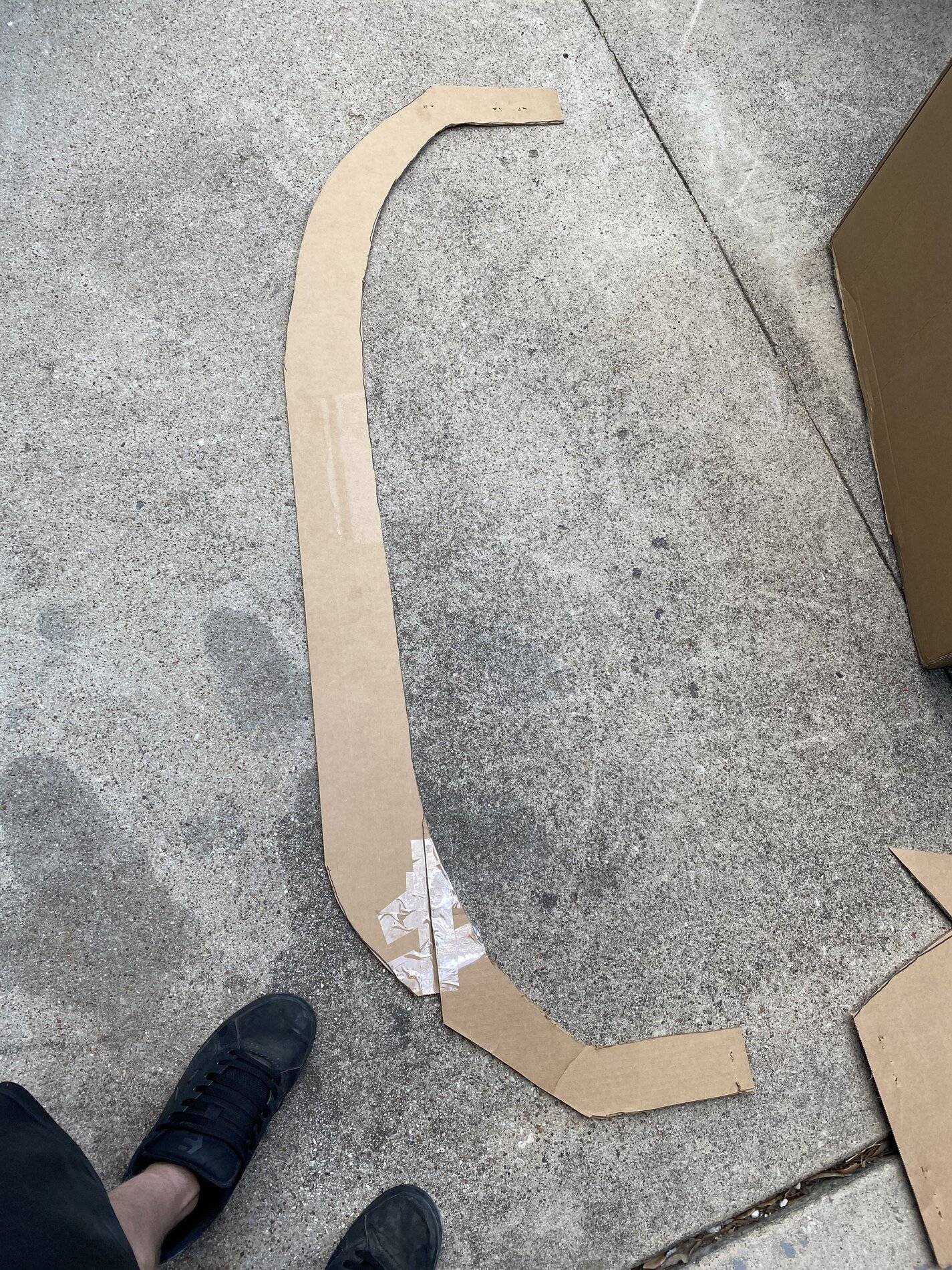

got the template made for a plate im making but havent had the time to get the aluminum cut yet, stupid work always getting in the way haha

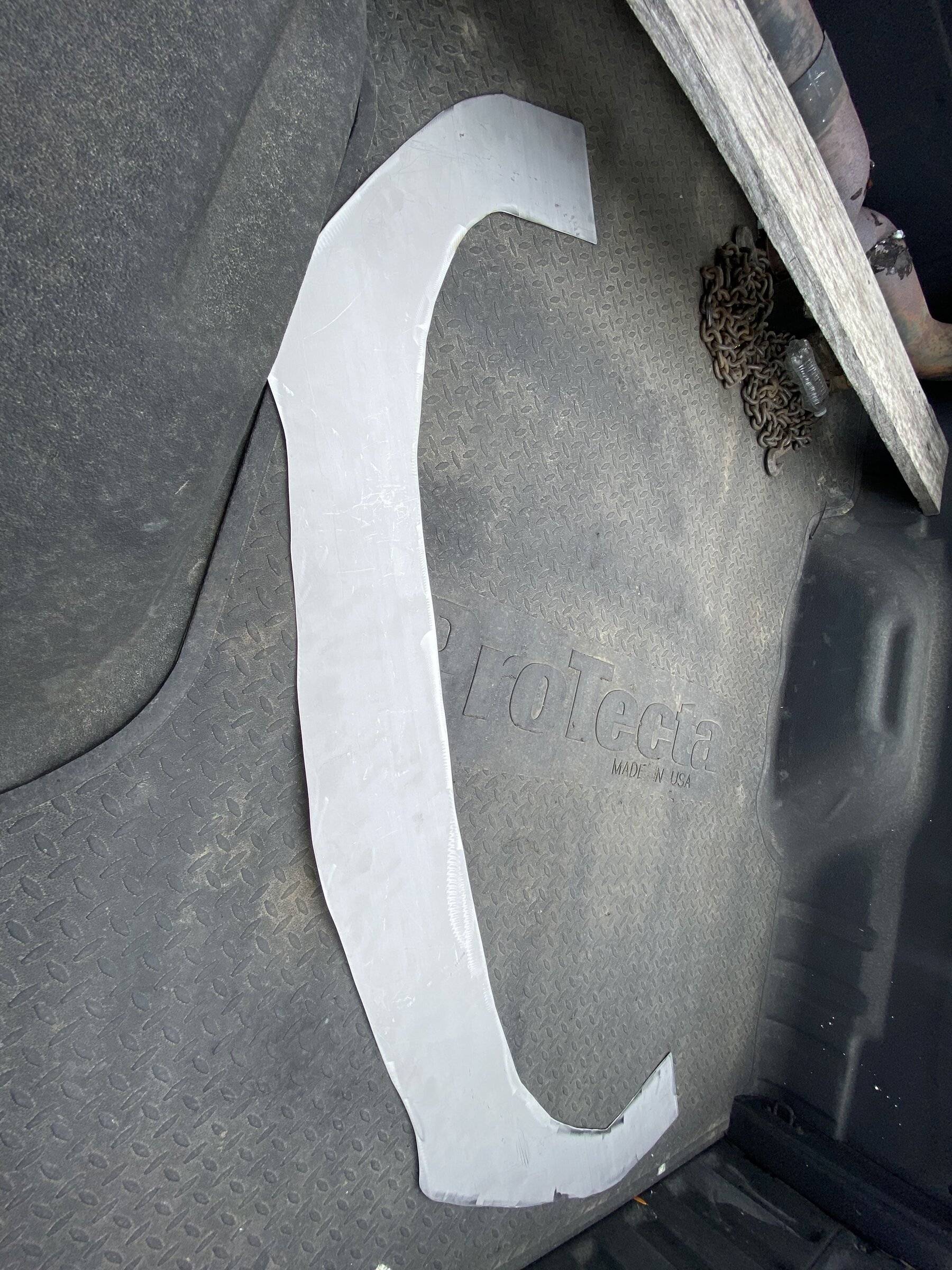

finally got it to my buddy at a machine shop to make the plate so hopefully ill have it soon but the bumper is back from paint ill try and post it up shortly!

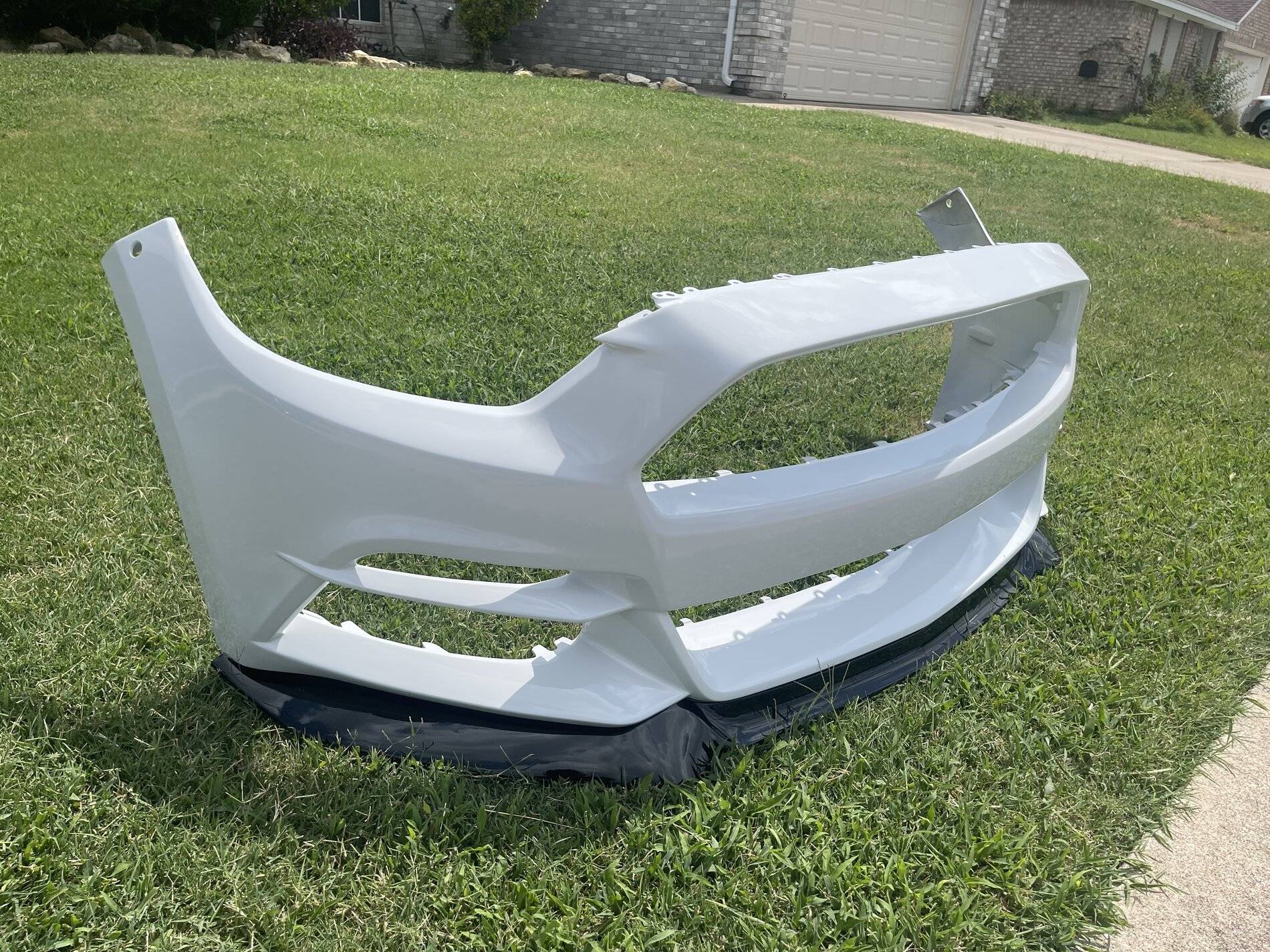

Here it is painted at least

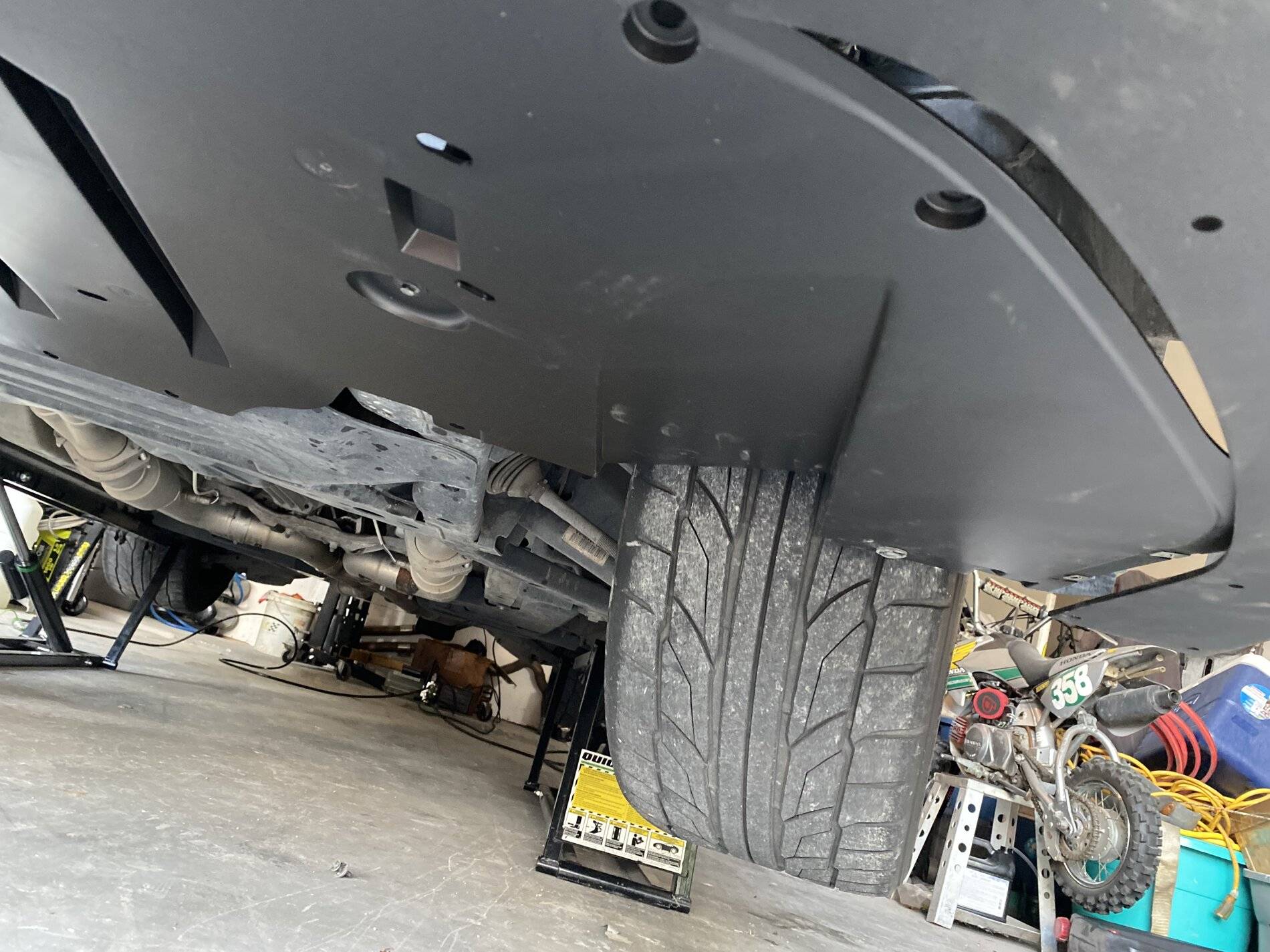

Here is the gap between pp belly pan and it and the very rough template I made lol

Been a little bit but got deployed last min back in October but here’s the piece I had made to take up the gap between the pp belly pan and the bumper, I’ll get more pics this week when I go to install it
