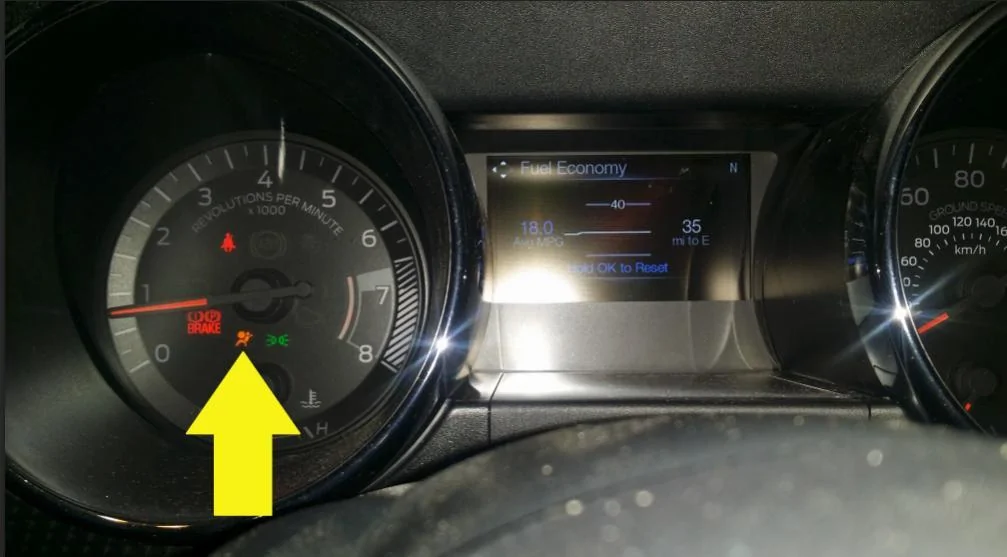

Front air bag light went on today....taking it to dealer on Monday, hoping for the best. Anyone else have any issues similar? :tsk::tsk::tsk:

I had the same problem. They ended up replacing the entire seat belt mechanism after trying to fix the existing equipment twice.

Strangely enough the light turned off when I picked my dad up last week, turned off immediately when he sat in the passenger seat. Fast forward to this morning it turned back on and I just gave the passenger seat a good push and the light turns off...

Might just need the passenger weight sensor reset

Mine is at the dealer now for this. They sold the car to me with the light on UGGH. Don't they even look at the cars they sell ?
There are so many features on the car that I figured the light was supposed to be on but when I went for my free oil change the mechanic said it was on and needed to be fixed so I had to set up a appointment to leave it for a day. Hope they don't screw up the car cause nothing squeaks or rattles.

Bringing this one back to life. Mine came on tonight and wont go off...any other fix it yourself?

You can fix this with Forscan. You just reset the SRS ECM and as long as there are no real problems it will relearn the new zero on theresence sensor and work a treat.

Just had this myself...it was the driver side knee airbag. Intermittent... they ordered a new one after the diagnosis showed the voltages being outta wack.
