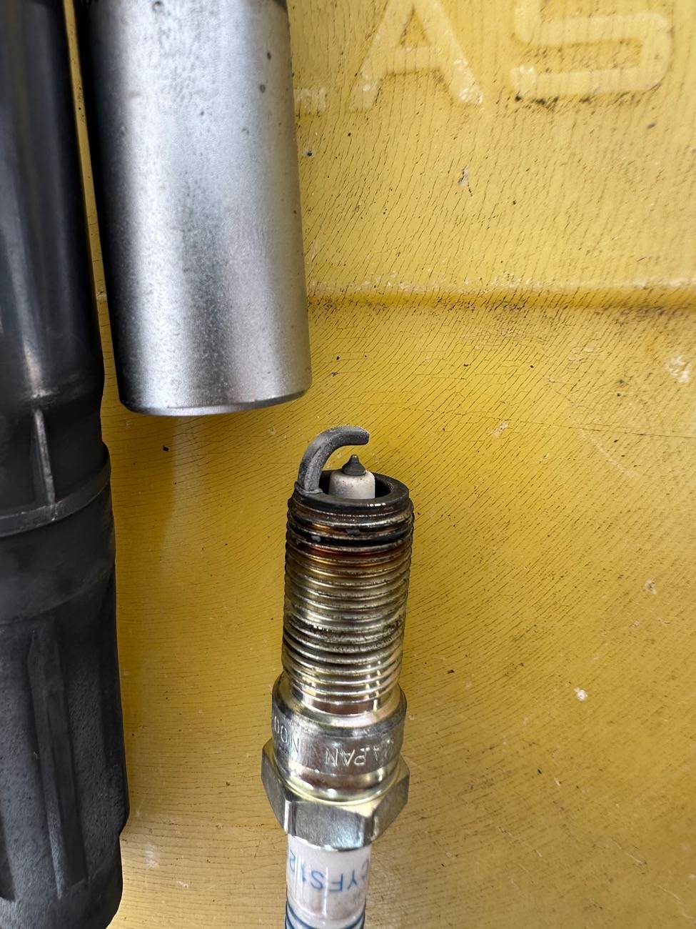

Since i own my 16 gt350 it consumes around 1 liter which is around a quart every 800-1000km or 500-600 miles. It now sits around 70000km or 44000 miles. It has seen plenty of race track and all in all doesn't miss a beat (as long as you refill the oil). Now since i have some time and i have no warranty or any help from Ford anyway i tried to self diagnose where the issue originally stems from. I bought a compression/leak down tester but the adapter doesn't fit so for now i only checked the spark plugs which look totally fine in my opinion. All of the spark plugs look the same.(the one in the picture is from cylinder 8 which i read was the problematic one). I also replaced the PCV valve but still need to check if it got better. I wonder if the spark plugs are completely dry where does the oil come from?

To answer the question on your particular car you will need to do the compression and potentially the leak down test as you plan and perhaps bore scope to make sure the cylinder walls are ok..
Most likely your car is one with the looser fitting rings. I say that because there are engines of the same year build as yours that burn no oil. Were tolerances off or suppliers different, etc. etc. to account for this? Who will ever know.
You don't say for certain but I'm assuming you owned this car throughout its life to have that knowledge of its consistent oil use. With that many miles and what you describe as a lot of track use you may be due for an engine refresh anyway. If nothing other than rings is the cause of excess oil use then replacing them will probably greatly diminish the added cost of oil use in your car.
At 53000 miles I got tired of a quart per 400-500 miles despite being told it was "normal", demanded a compression and leak down test and had the engine replaced under extended warranty. No oil usage, same driving technique, for 7000 miles now. I am much happier.

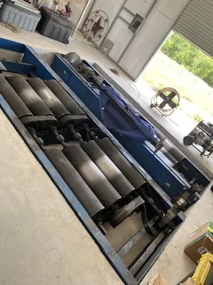

lol…no worries there, I learned almost 20 years ago that breaking an engine in gently is the wrong idea.
… notice the light shiny area on the rollers 😎
