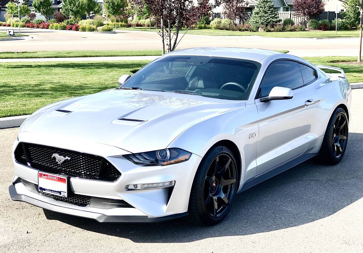

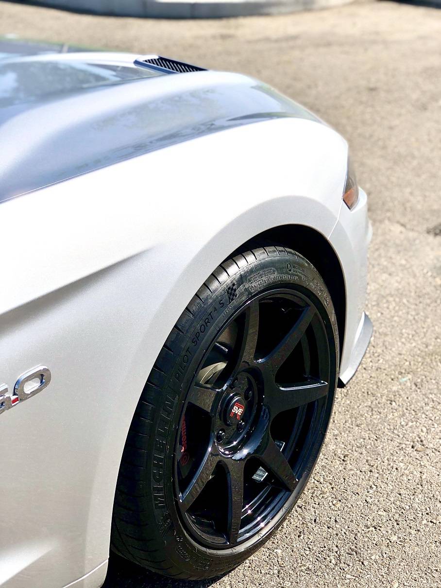

I have a Mustang GT PP1 with the black 19" PP1 wheels. I really like the style of the factory PP1 wheels, but I wanted lighter weight, and opted to stay with 19" wheels, both because I think it looks good, and I could reuse my factory tires (added benefit). That said, not all 19" wheels are created equal. Some have spokes that go nearly all the way to the edges, like the SVE R350 wheels, making them appear larger, compared to some wheels where the spokes stop 3/4" or more shy of the outer edge of the wheel. I'd shy away from the latter.
That said, I put on the SVE R350 19x10 +35 all around a month or two ago, and they did not leave me wanting 20" wheels. Nothing against 20" wheels, but I think these in 19" look great (on my car):

It looks like the local tire place quoted stock tire fitment. Your set up looks good. My son wants me to put black wheels on my car.
