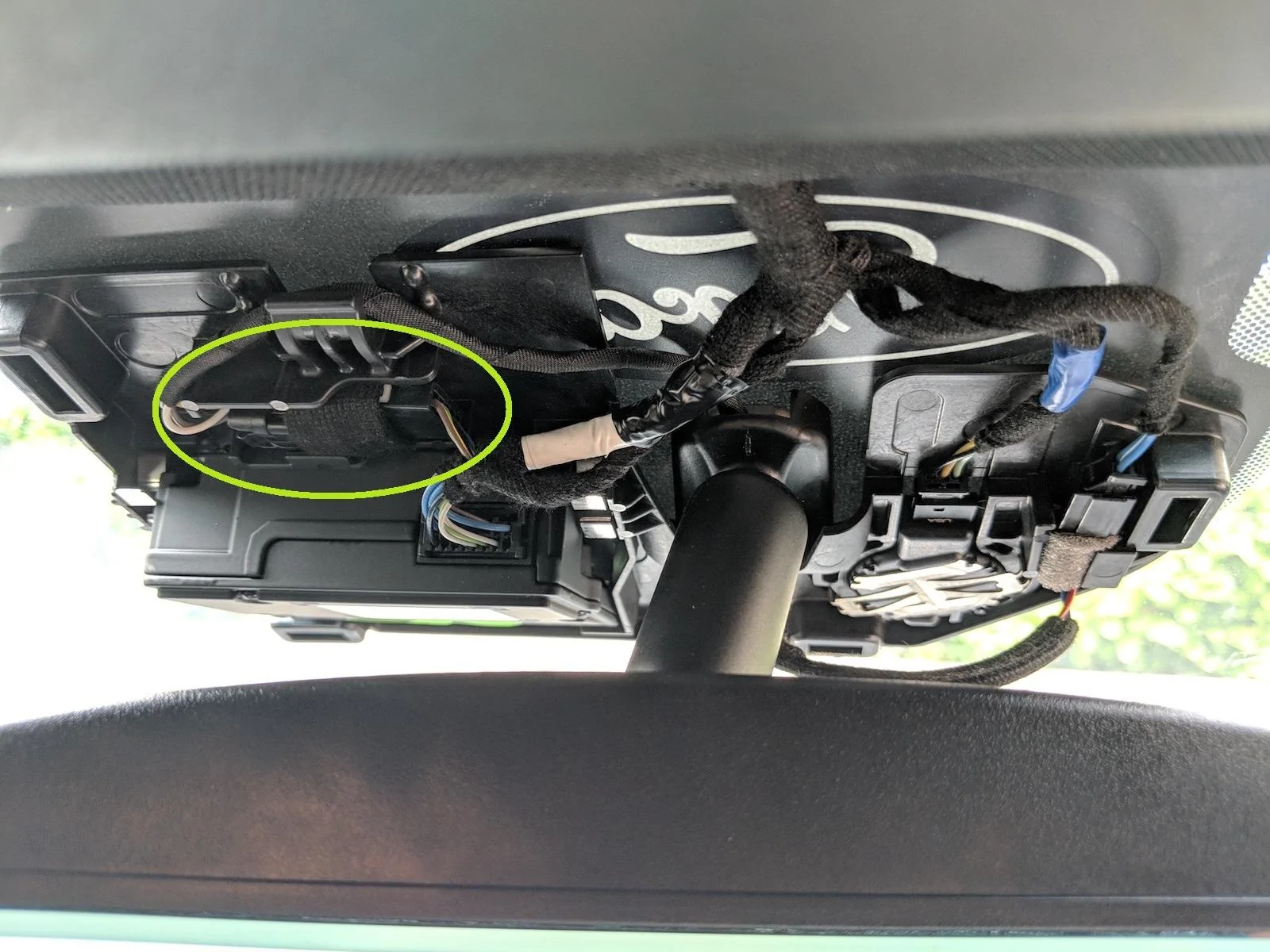

Here's the harness. What sucks is the old plug is so big its hard to put anywhere. I may just have to tape it to the back of my mirror... Won't see it from the inside but I guess if you look through the windshield you will. I tried to stick it in the overhead console/light area but I have other stuff up there and it wouldn't fit. You may be able to get it to fit.
I made a short and long version. If you want one, let me know via PM! Sending one out to db252 for his mirror.
