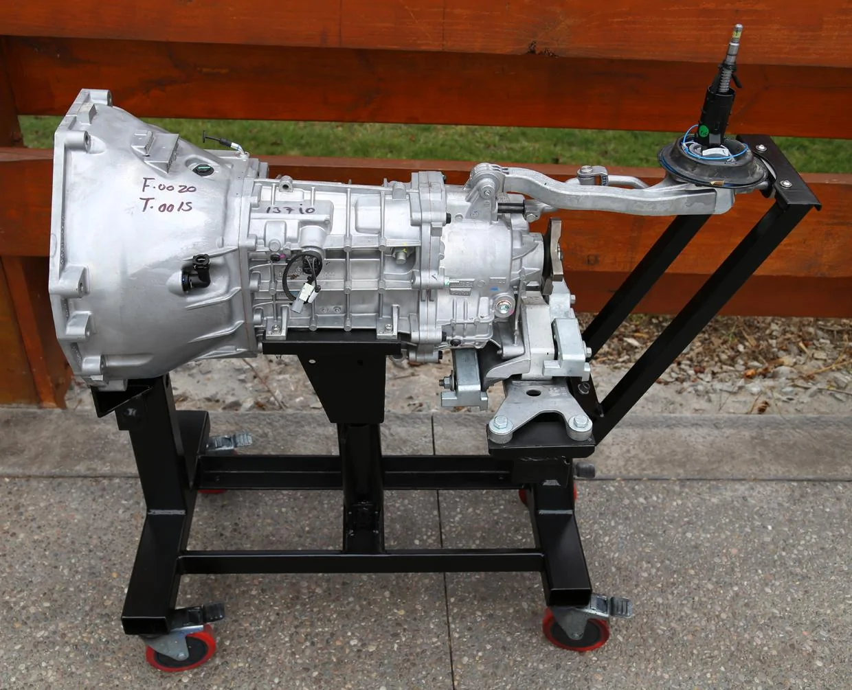

I suppose I wasn't clear, I was referring to [MENTION=19066]Epiphany[/MENTION] pictures showing the weight/isolators added to the '18 trans.

Those cap screws (and washers) securing the trans mount are not factory (as I recall) - what gives?
When I replaced my factory two-piece steel driveshaft with a QA1 CF shaft I optimized the driveline angles. I rotated the rear differential housing slightly and lowered the rear of the transmission roughly 1/8". I tried various combinations in order to get the best numbers possible and as such I procured longer transmission crossmember-to-body bolts (in this case, socket headed capscrews). The factory bolts are very short and I needed longer ones to allow testing various thickness shims/washers. I believe I showed much of this in the driveshaft writeup I did here.
Good eye regardless.
Since the '18 now uses the twin disc clutch and dual mass flywheel, maybe the isolation was added for these?
I haven't followed the GT enough to be versed on what the 2018 clutch is comprised of and how it may or may not differ from previous year models. It is certainly interesting that the dampers are used at the same time the engine in that car got a bump in power.
