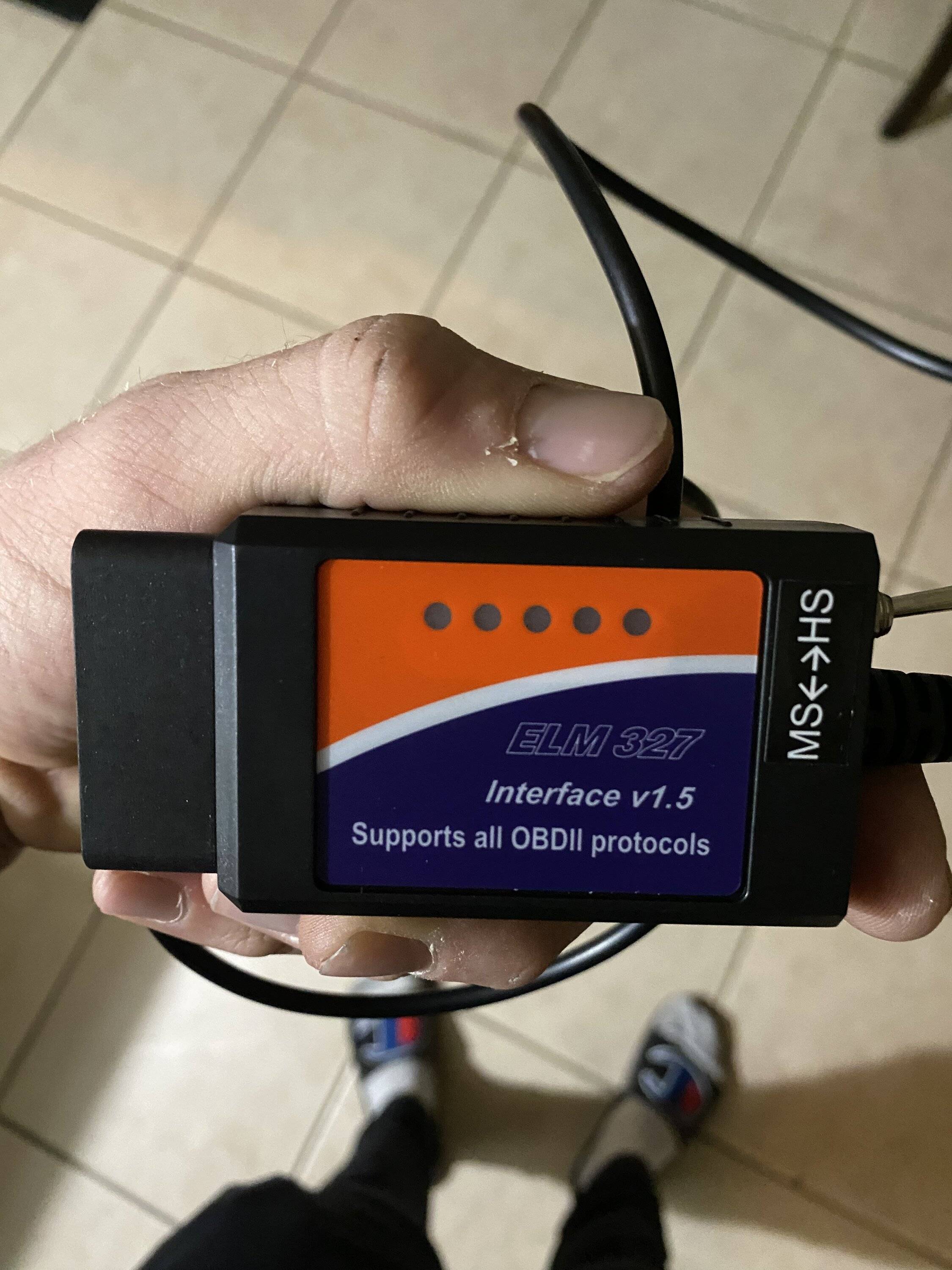

Also here’s the device I’m using. Installed the proper drivers for it.
