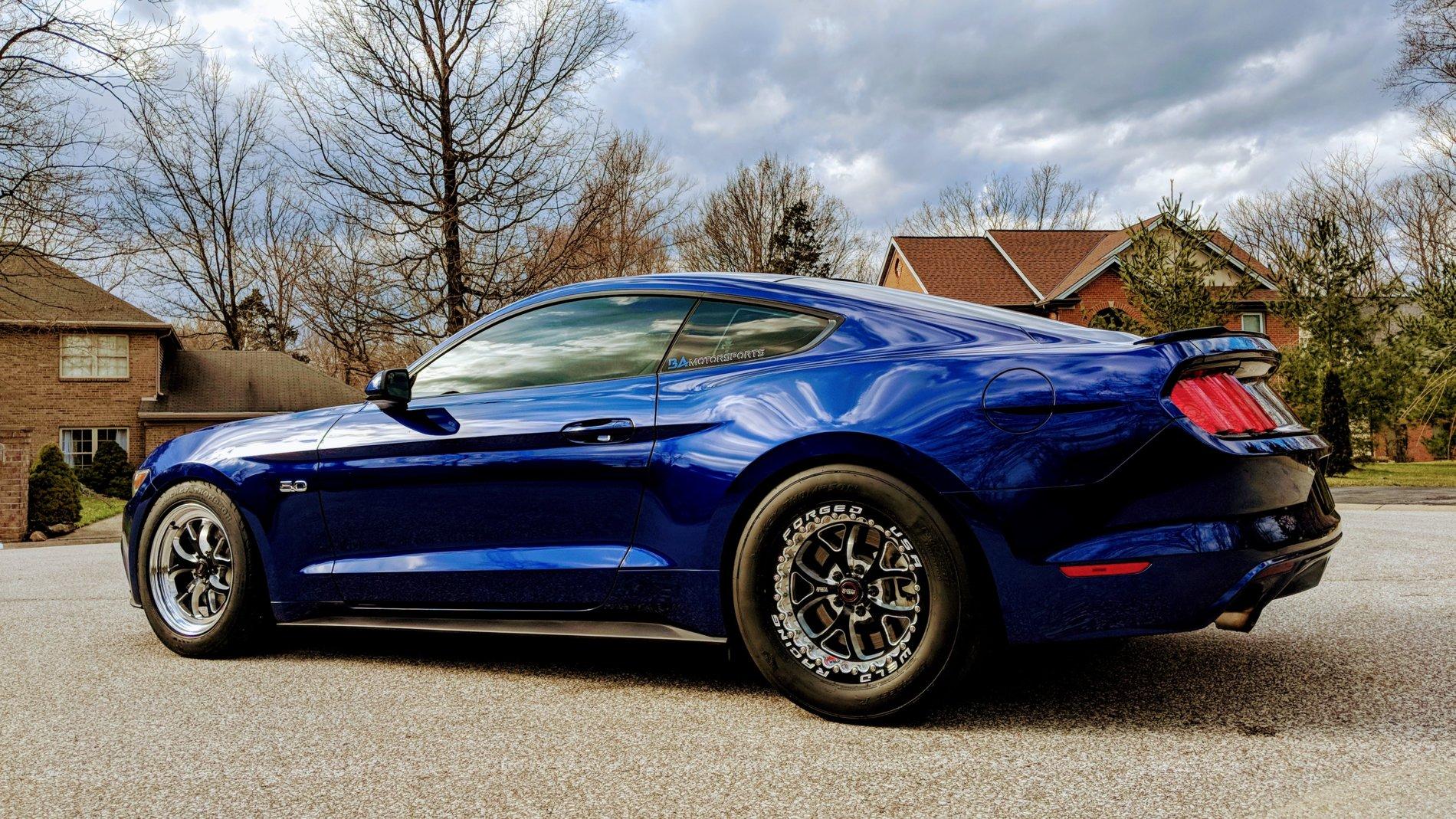

Who said the 10.5s don't fit? They fit fine as seen in the pic. MT 26x6x17, rear is 305-45-17 et street r
In new to chassis, I was asking based on the comment by the PKauto dude...yes your car looks viscous!!!!!
What do you 60ft like that? Interested in selling?

Went 1.42 60ft on those. I sold them already. On welds now.

Oh sweet jesus yes haha....in case I come across wrong I wasn't being a smartass, I simply wanted to know if it picked up...my God yes it looks awesome!!!!
No worries, won't see a gain from a wheel swap as weight is comparable. Adding more power so it will def pick up the next time I'm out.
