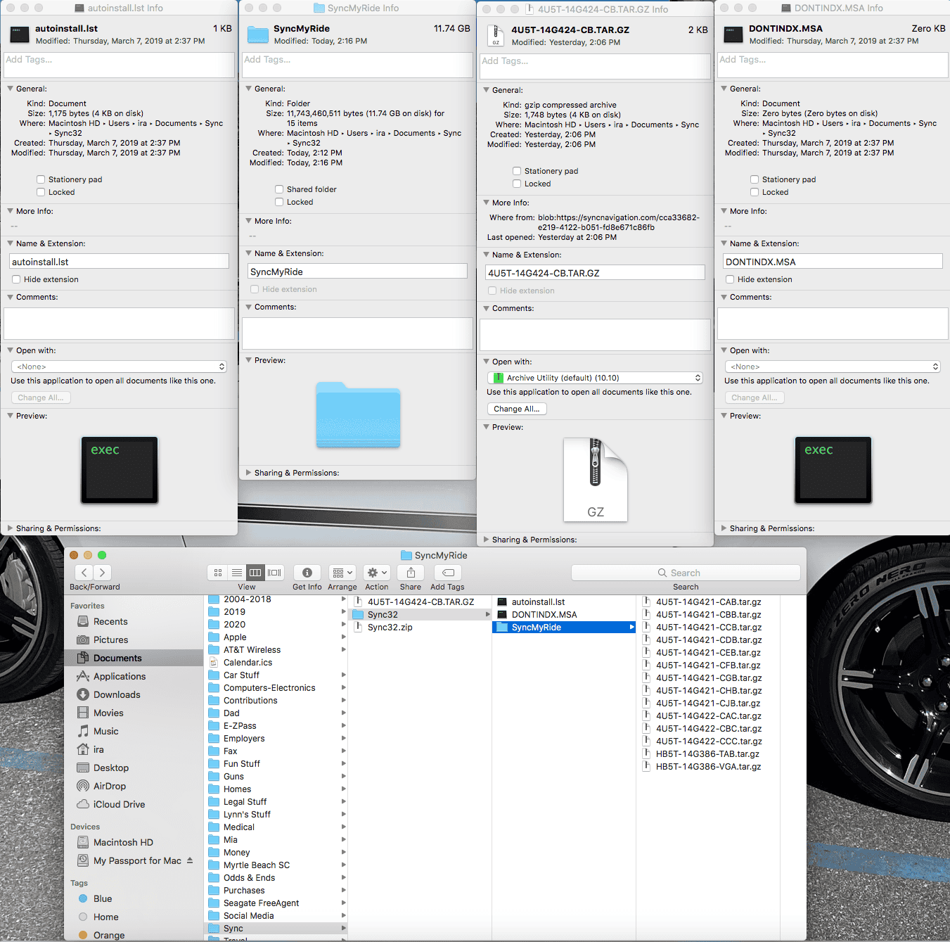

OK, so reformated my drive, unzipped the Map file and reloaded. Here is what I have. Can someone please look at this and see if the files match or are even close? Thanks.

I loaded all 3 files, one is the license and extracted everything into the primary folder meaning if you were to click on the USB drive on a pc ALL the files would be right there not divided into different subfolders. I haven't done the install yet, have no experience doing this in a vehicle but just assumed the very basic nature of these on board computers wouldn't have the ability to drive into or search around inside a variety of different folders. I could be WAY off though.
At a glance (the USB is out in my car at the moment), I think it may be that the license file needs to go in the SyncMyRide folder on the SyncMyDrive flash drive, not in the flash drive's root.

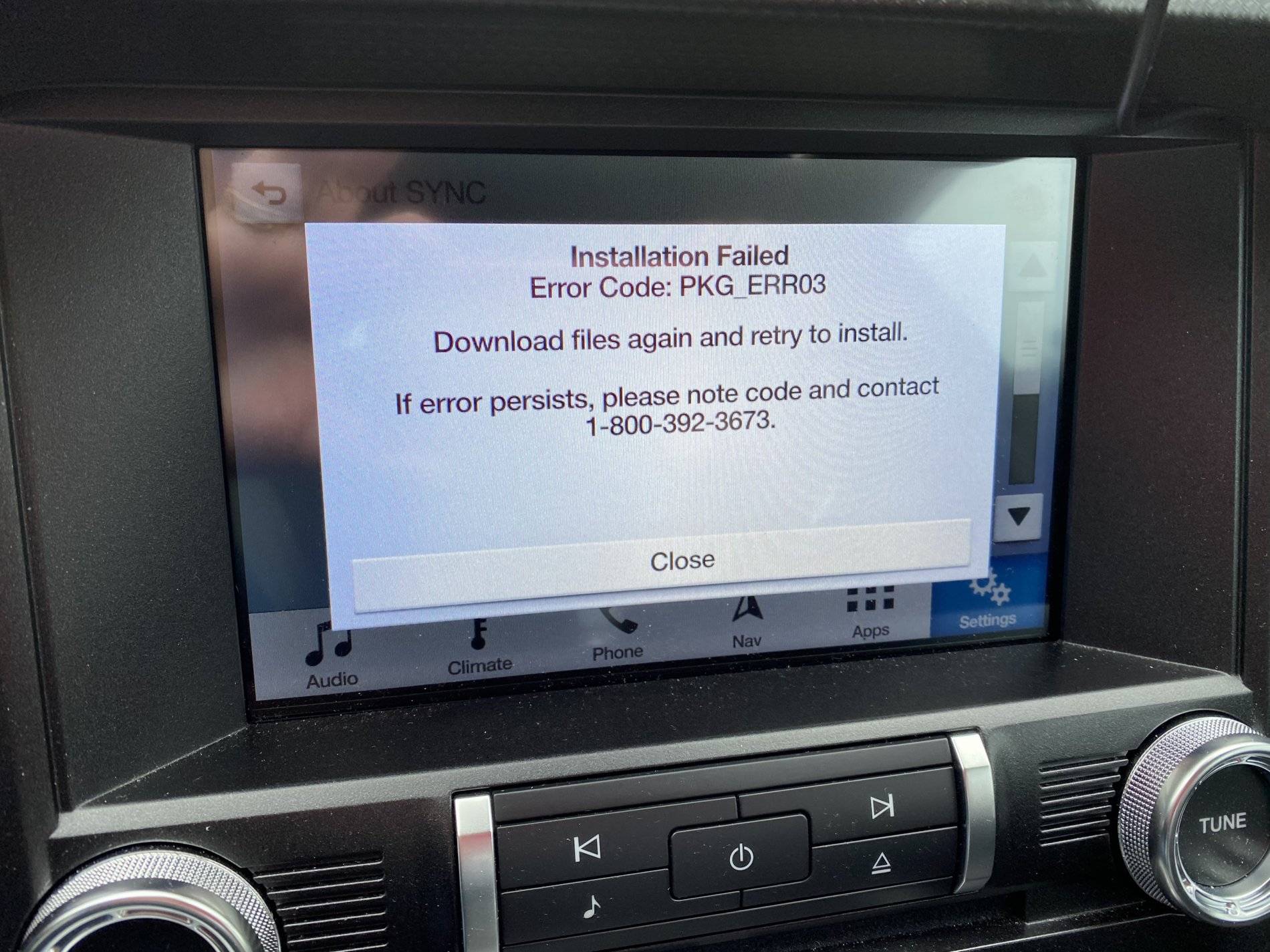

My update crashed right away error05. So, I'm going to try making a FAT32 USB drive. Will be watching here to see if anyone else was successful. The zip file is on my desktop. I'm going to extract everything to the stick then drag the license file there. Would appreciate knowing if it needs to be done differently.
Edited to add: To use a term I recently learned, I finally RTFM and error05 is simply the fact that the license file needs to be in the sync my ride folder. Since the USB is in the car, and the car is at home, I'm making a new stick now from work and will attempt to install some evening this week.

Yes, sorry I did the screen print before I copied it over.
