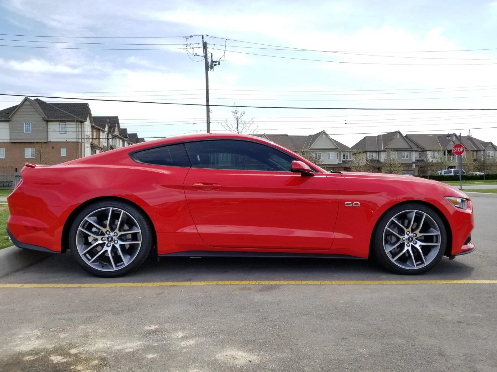

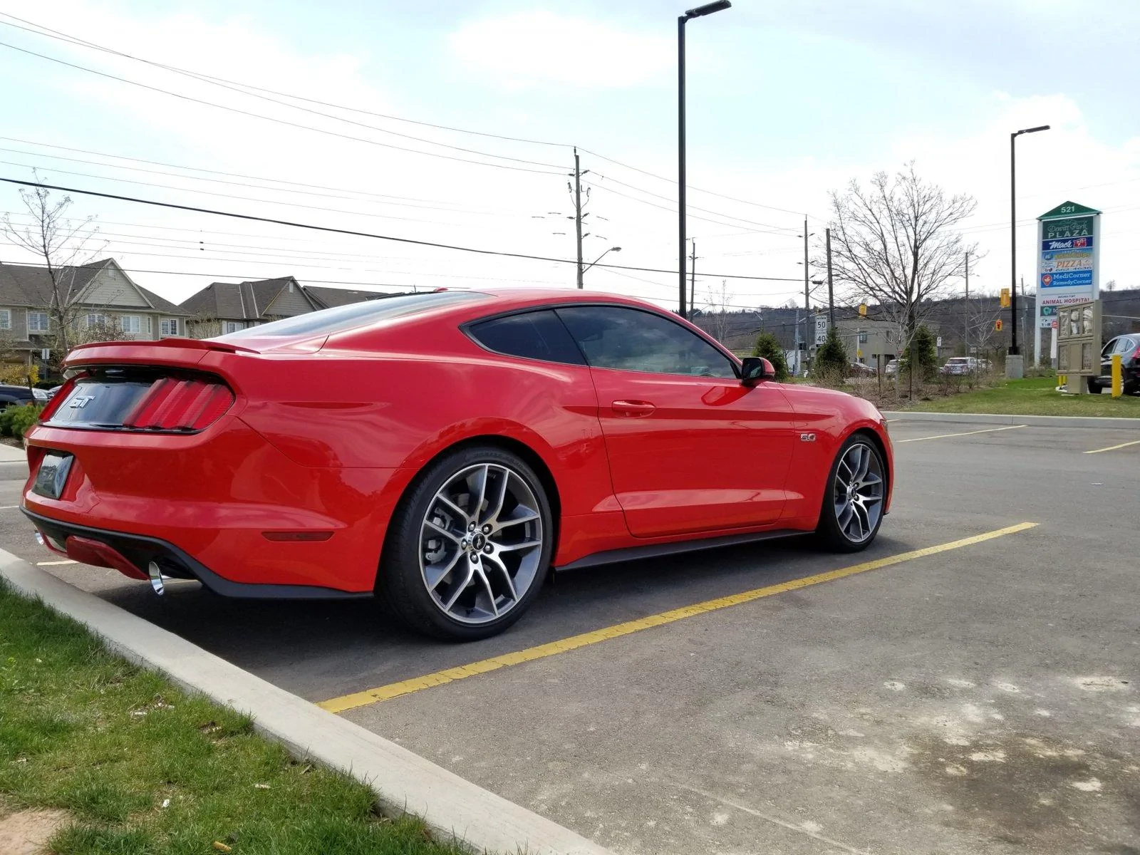

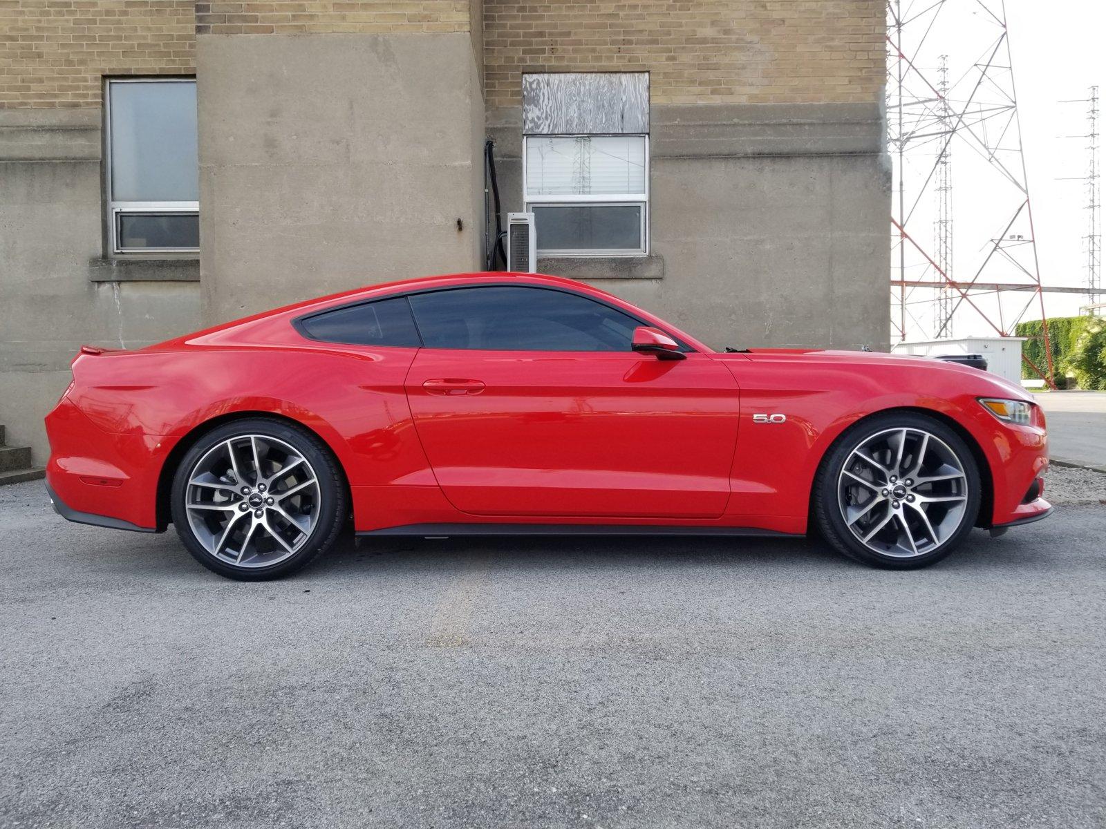

Installing Ford racing street Springs on my PP 2015 Mustang GT on Tuesday.My car only has 5,000 miles on it so I think my dampers should be fine. Just looking for the drop. Ford will be doing the install an alignment. Anything else I should consider ?thank you.
Your g2g. The Ford 5300-X springs were designed to be used with the PP dampers and is what comes in Ford's street handling kit. PP shocks / struts with 5300-X springs.
The drop in the front is a little less than an inch and it seemed about the same out back possibly a bit less than the front. View attachment 330497
