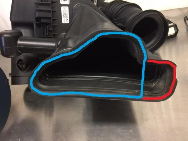

Maybe we're confusing terms? When you say inlet, you're talking about the part that brings the air in from the grill right? I set the 2 side by side when I pulled the stock one out to install the FP part and the stock one is bigger. They aren't even the same shape completely, that's why it has to be trimmed. If you didn't trim it, you can still force it on there. That isn't a good thing though and didn't make the installation better. If you look at the section where Bill trims the rubber, on the stock box, there's a square piece of the grill inlet that is being blocked off if you don't trim that. Look at your stock intake if you saved it. On one end, there's a square section, that's missing on the FP inlet. The other end is more of a triangle. As far as it being 3x bigger, I think you might be talking about something else, maybe the box?
No, I'm talking about the same part. Whatever the case is, theres no rubber blocking anything on the grille-to-inlet piece, I just checked it earlier (and its 8 degrees outside :( ) so I'm not taking that abomination back off the car just to cut a line in the rubber.

Here is the best way I can explain it. If you look in the CJ Pony Parts video at 1:40 where Bill has the inlet pointing towards the camera, look at the shape of the opening. All of that is exactly like our inlet opening, shape and size except for the bottom part. Look at my pic below of the stock inlet. The part I highlighted in blue is common between the 2. The red part is on the stock bigger inlet and blocked off by the GT350 inlet.
Maybe they updated the kit, because my inlet came in a separate sealed bag and fits like the purple line here if that was the back of the grille. I can see daylight around it. It is much larger than the stock one. Like I said before, the stock one literally slides inside of it. If I ever take it back off I'll put pictures of it, too damn cold to mess with it right now.

That's great news, thanks for sharing that! It sounds like they did indeed update the kit. Mine didn't come that way. Mine looked exactly like the one Bill has in the video. Now I'm wondering if I can get that piece from FP? I don't mind taking it back out, it was very easy. It's much warmer here too, 20*. Fortunately I just installed a thermostatically controlled electric garage heater this winter and LOVING it!
Did the separate part for the inlet come in a bag with a part number on it?
I don't know for sure if it did, I have no idea what I did with the wrappers for everything right at this moment. I'm going to sleep (working nights sucks) but I'll check the trash can in the garage when I get up.
Awesome! Really appreciate it. This might help those of us that got the original part to identify what we need when talking to FP.
