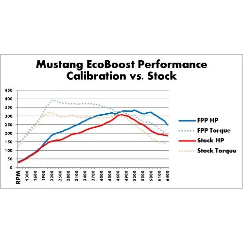

That's what I've been trying tell people. Peak numbers are meaningless. What matters is the area UNDER THE CURVE. You must integrate the wave form to see what the area under the curve really is.
That area is the total power delivered over each gear from x rpm to y rpm. Many of the 1/4 mile calculators out there are no longer valid for newer engine designs because they assume a relative peaky power curve of older V8 designs.
On a side note, I wanted to say that the top end of the FP tune seems much stronger than their engine dyno would indicate. Here's why I think Fox got the numbers he did and why there's a difference: I think he did a 4th gear run and he also had a FMIC which still makes a very substantial difference in allowing the FP tune to maximize power.
That IC really starts to have issues with not just heat soak, but flow as well once you start to push the turbo towards the top of its efficiency range, you need to keep the pressure drop to a minimum while maximizing heat transfer. That becomes apparent in the very anemic top end of a factory stock EB, it's not just tuning, it's also hardware.
Really, if you just install the FP tune, your only going to see marginal improvement, you really need a decent FMIC to allow the software to fully open up because it's not going to allow unsafe conditions. Give it those safe conditions and the tune really comes alive. Hopefully I can get mine on the dyno soon, but things are pretty busy right now being a single dad :(.
