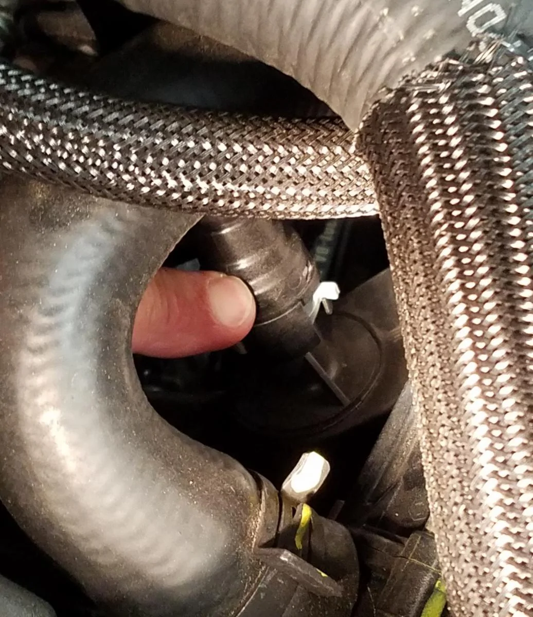

Had the tune and CAI done today at local dealer. Since I had read all of this thread, I knew to expect some crap performance at first. I am about 75 miles into the tune, and I just got a check engine light saying P0299, which is something about the turbo being in underboost condition.
Also, boost will not go above 0
Has anyone else had this?

Sounds like they did a choppy job on the intake. Check to see if the new box is fitted to the intake hose and take it back. Should be no CEL.
Yes. The intake was installed poorly and some hoses weren't installed correctly. Check hose fitting below and your intercooler charge pipe at the intercooler to see if it blew off. Both happened to me after install.

Turns out to be a hose labeled TB, a big one on the right below the CAI - annoyed but grateful nothing major
