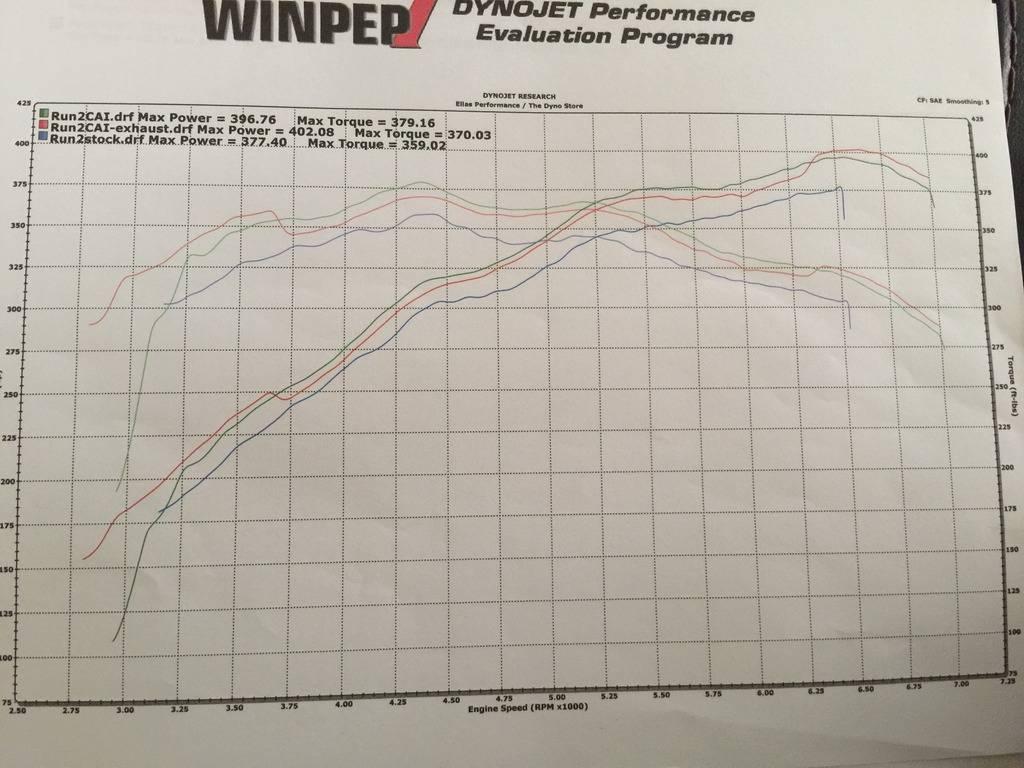

So I finally got my power pack 2 and decided to dyno it and everything was good until I installed my catback exhaust. It seems it past 3.7K rpm it dips and jumps backed up around 6.3K rpm. I know the tune wasn't optimize for the catback exhaust but wasn't expecting this result. lol it seems like I'm messing something.Anyway here is my results if anyone is interested:
