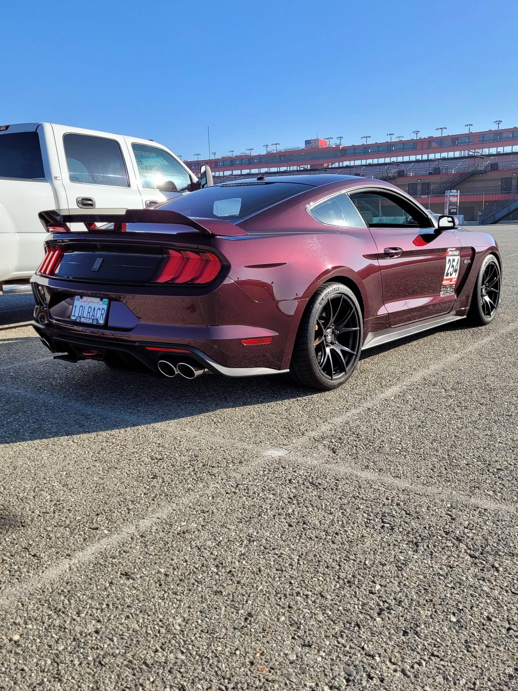

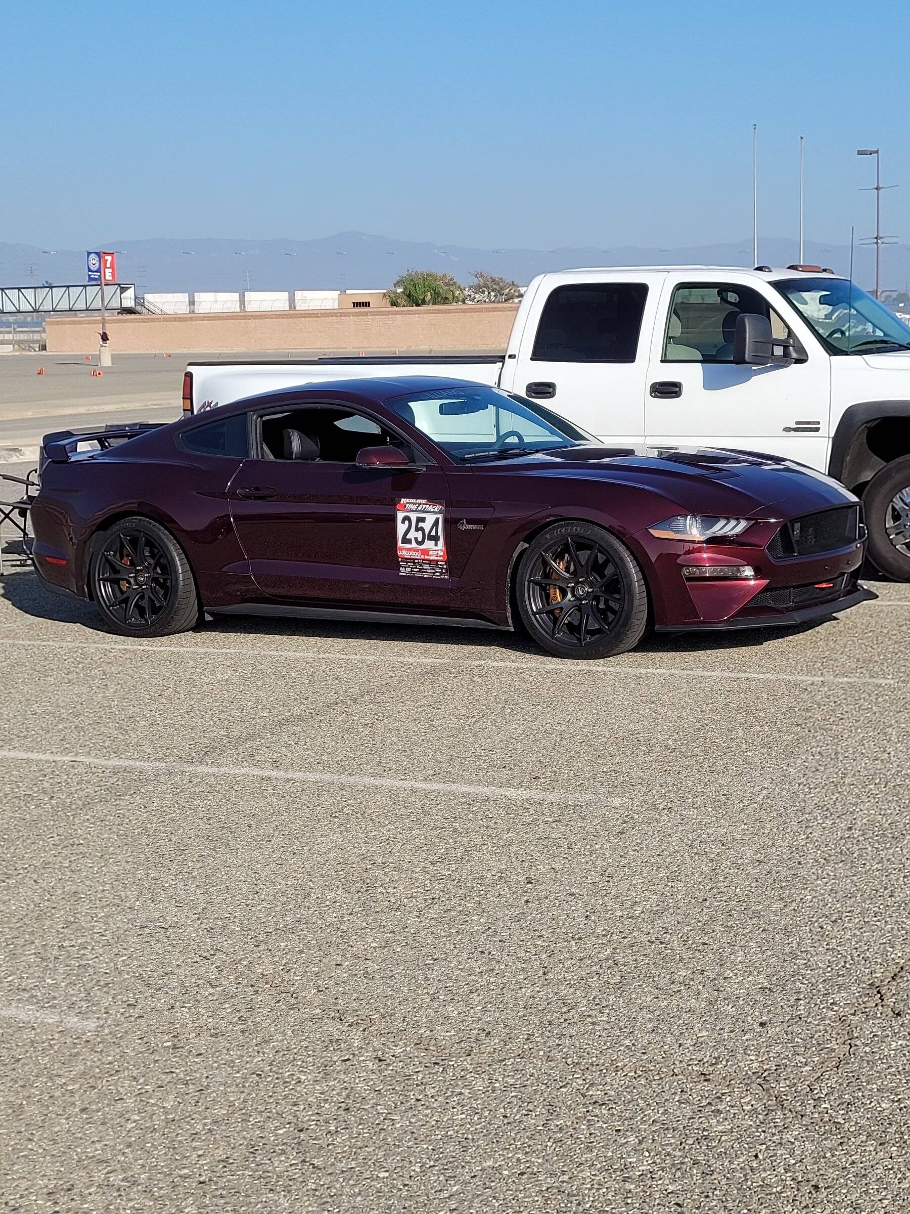

I run the FP. Track set up with the steeda 1/4" spacer along with 305/30-19 rears with 285/35-19 up front. This sits perfect for me and I track the car with this set up. The sway bars and aliment set up gives the car a small amount of oversteer as I exit turns. I personally like it that way. The pics are from last year.
