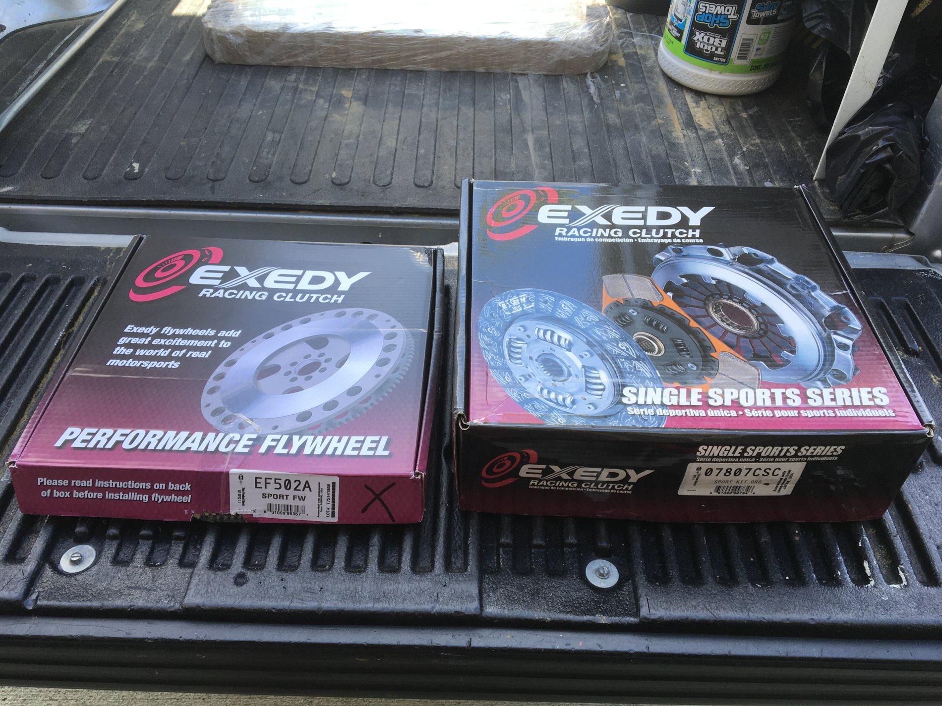

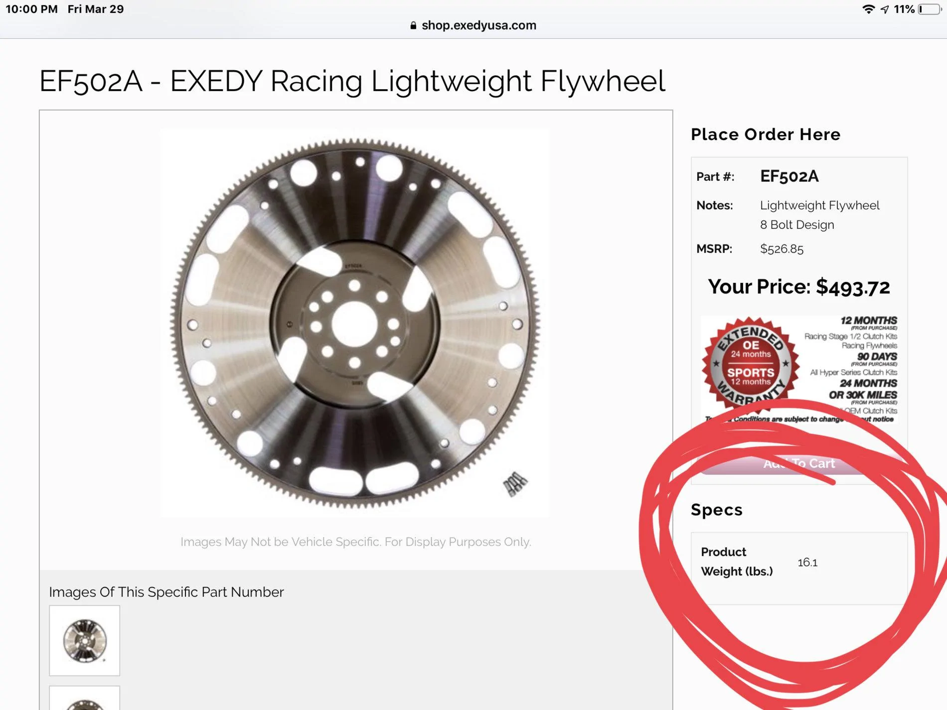

Anyone have any input? Ford Performance M-6375-M50 or Exedy EF502A?
Both are steel, and lighter.
Ford advertises as 9 pounds lighter than previous version but i don't know what that means compared to stock. Exedy, i can't find any info on weight.
I'm planning on running the Exedy Stage 3 Mach 500 clutch which has a sprung hub, and the Ford one advertises as having a 7 inch recess for this, where the exedra says nothing, but i can't imagine it's own brand of clutch wouldn't fit.
Anyone have experience with either?

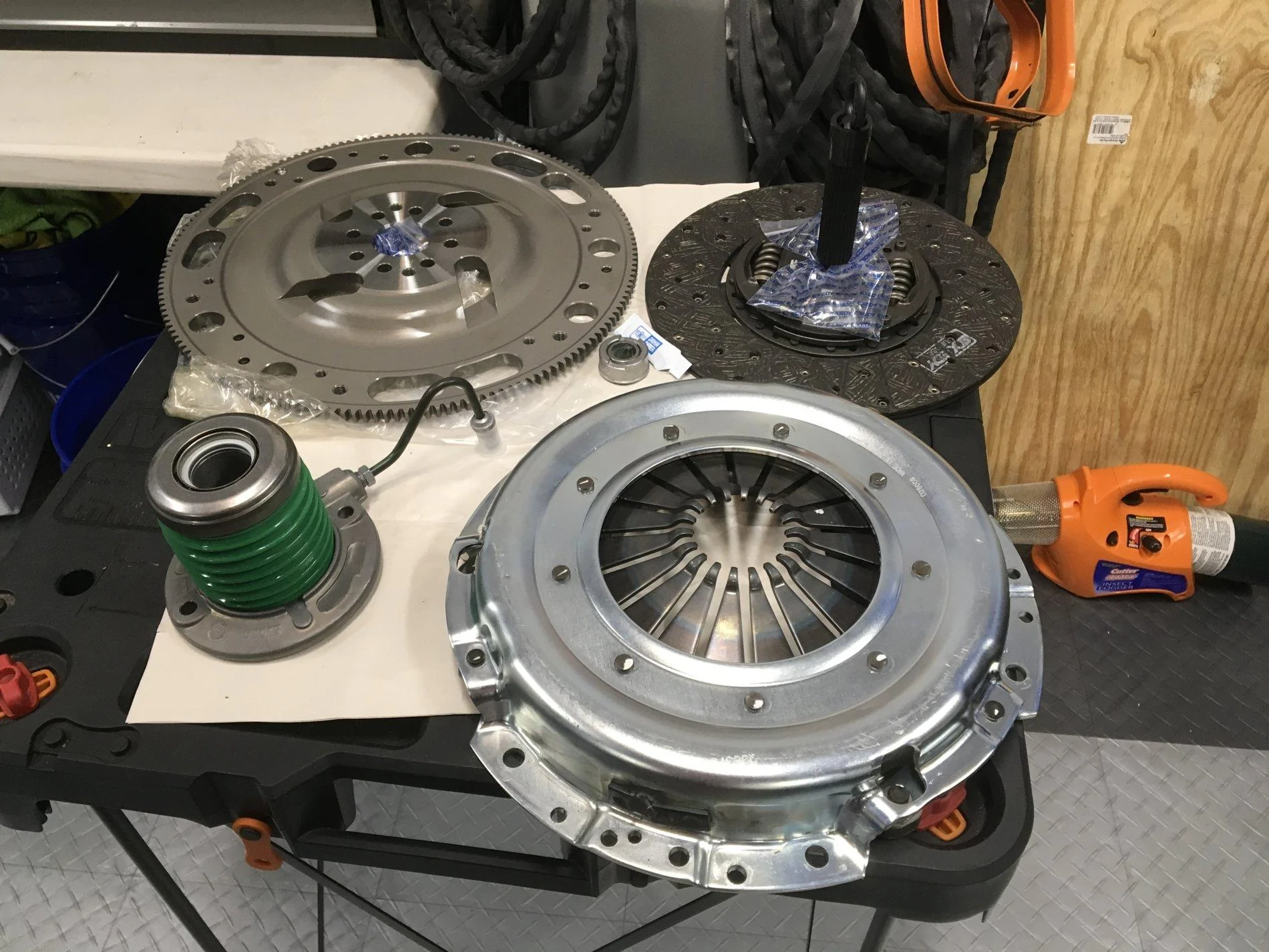

I’ve only ever driven the car with the Exedy clutch but it had the factory flywheel. Last year the slave cylinder went out so I decided to replace the clutch with the same one and I installed the light weight flywheel. I have no complaints, throttle response is fine and engagement starts about an inch or so off the floor. The pedal is heavier than stock but I don’t daily mine, heavy stop & go traffic may take some getting used to. It’s a great combo and I’d be surprised if you regretted it.
EDIT: of course just do a proper break-in
