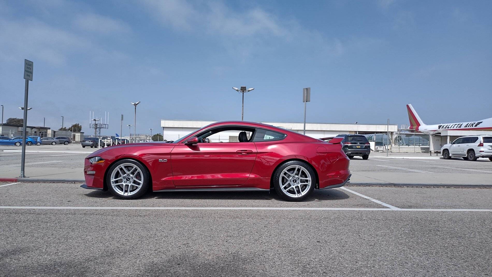

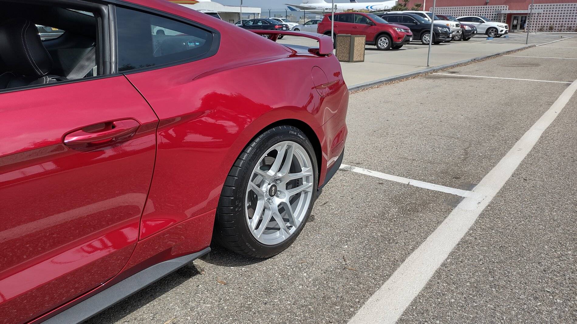

305/35 fills the wheel well nicely
This shot shows it front 305/30 rear 305/35
I like the 305/35/19 out back, it does fill it out nicely. I am running 285/35 /19 fronts MIch PS4S.

It kinda looks like a drag racer in that config, IMHO. For my own personal taste, the 35 is too much sidewall. Or at least, I'd prefer a more symmetrical look.

Yes correct drag car profile, when the fronts wear they will have 305\35.
The picture was just to show 30 verses 35. Funny you think 35 has to much side wall. I think the 30 looks like a rubber ban.

I'm looking for a more Mach1-like track car look, is all (and handling)
Are those the PP2 10.5/11" wide wheels in that pic?

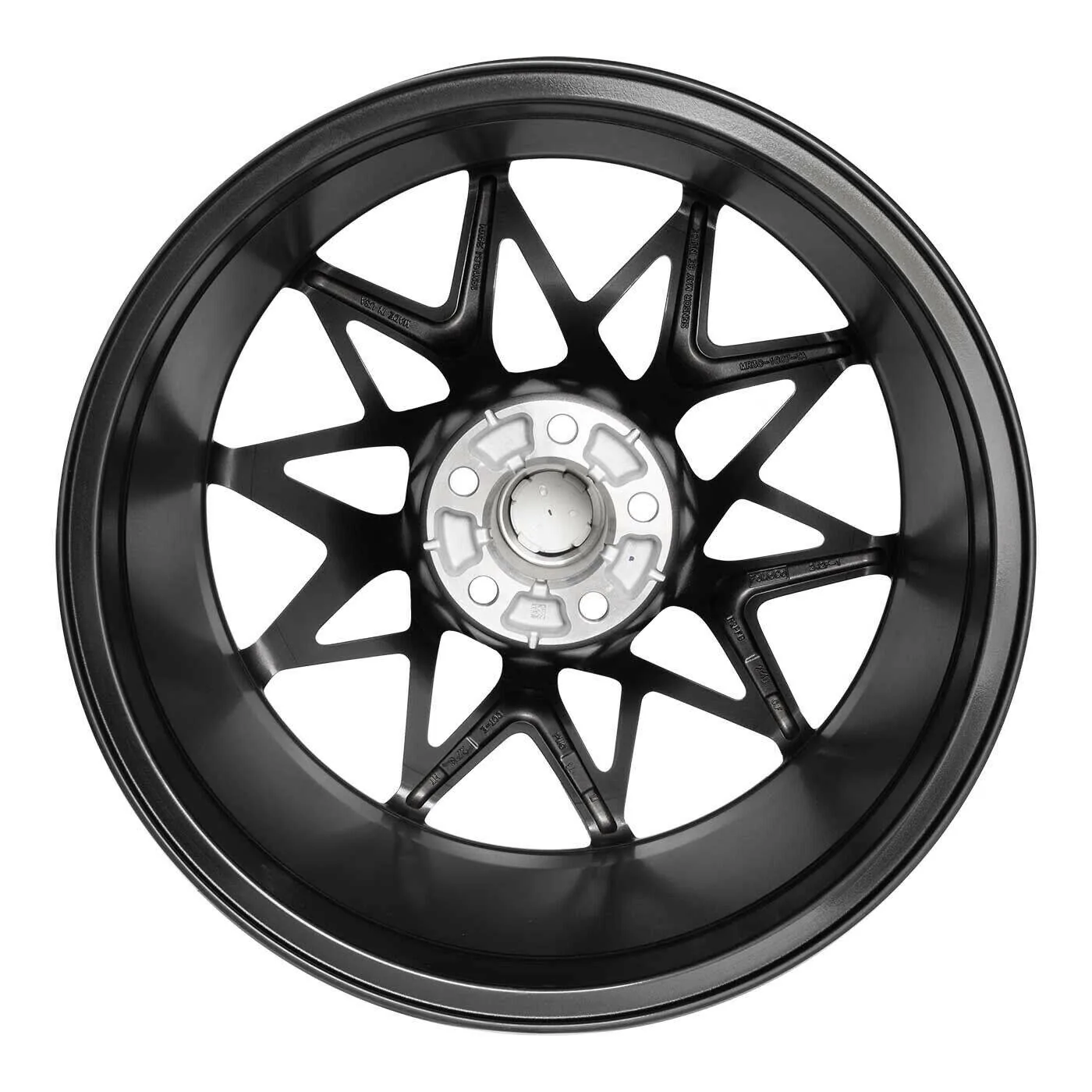

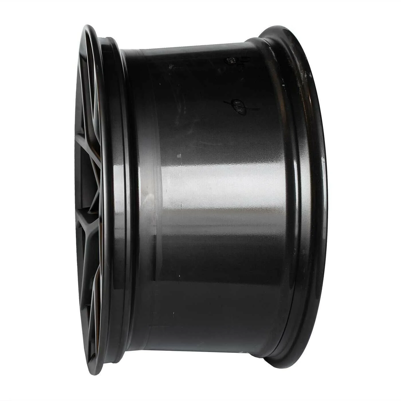

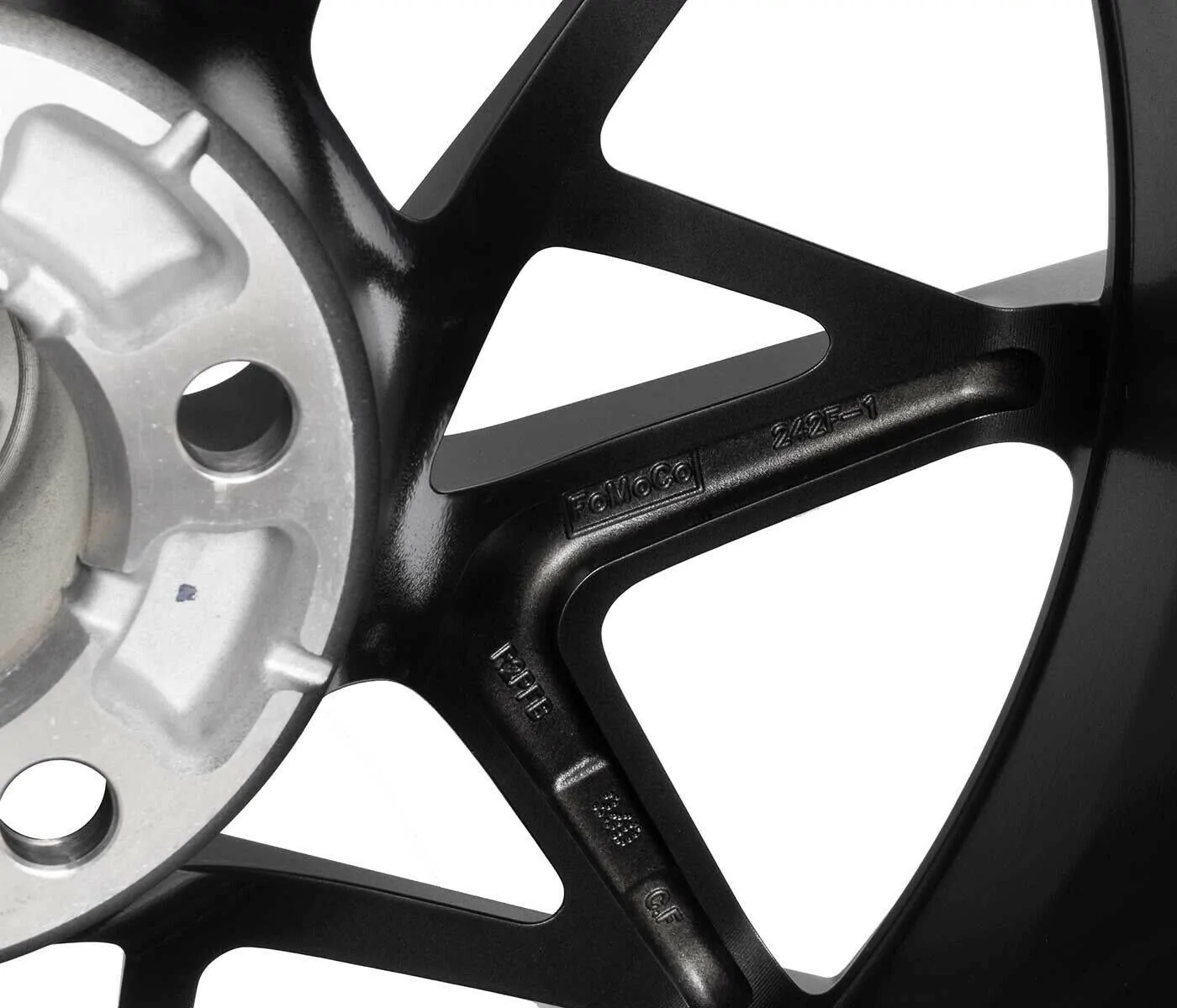

Here's more close up photos taken from eBay offering incl. the back side. Anyone with the OEM wheels can compare the codes to make it 100% clear once and for all.
To reiterate, the offsets are ET24 front and ET52.5 rear.
Indeed they are, car included .
