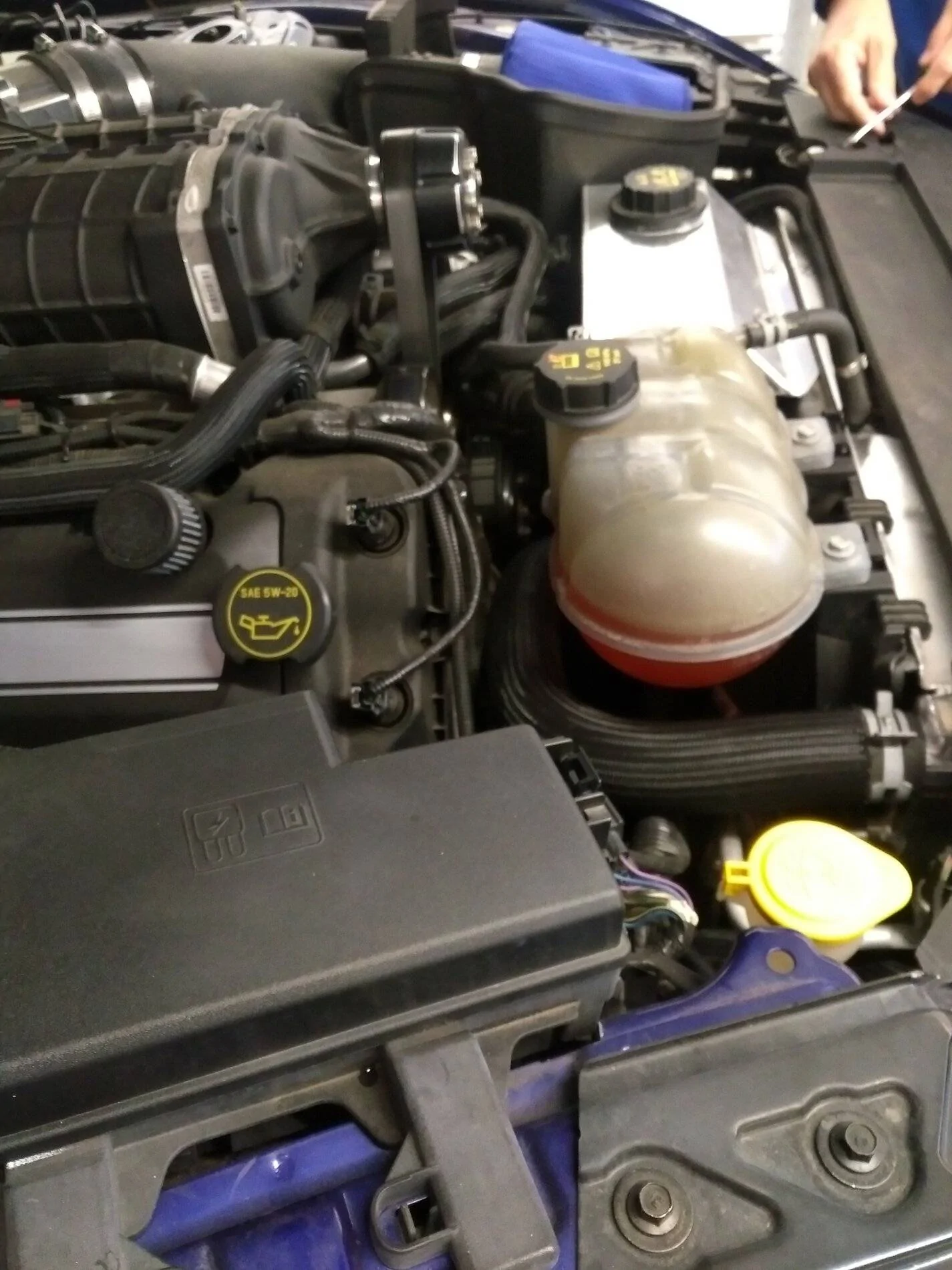

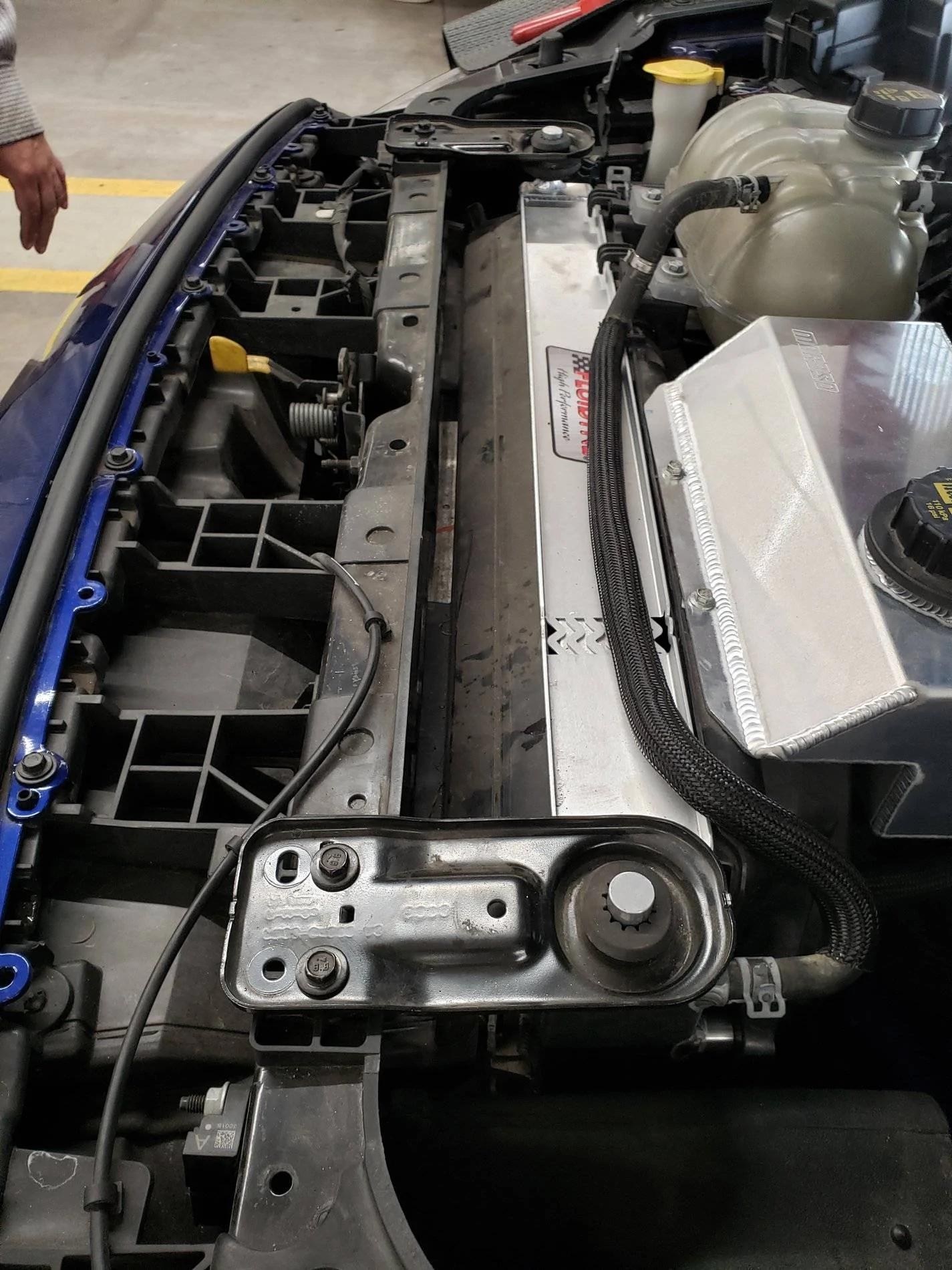

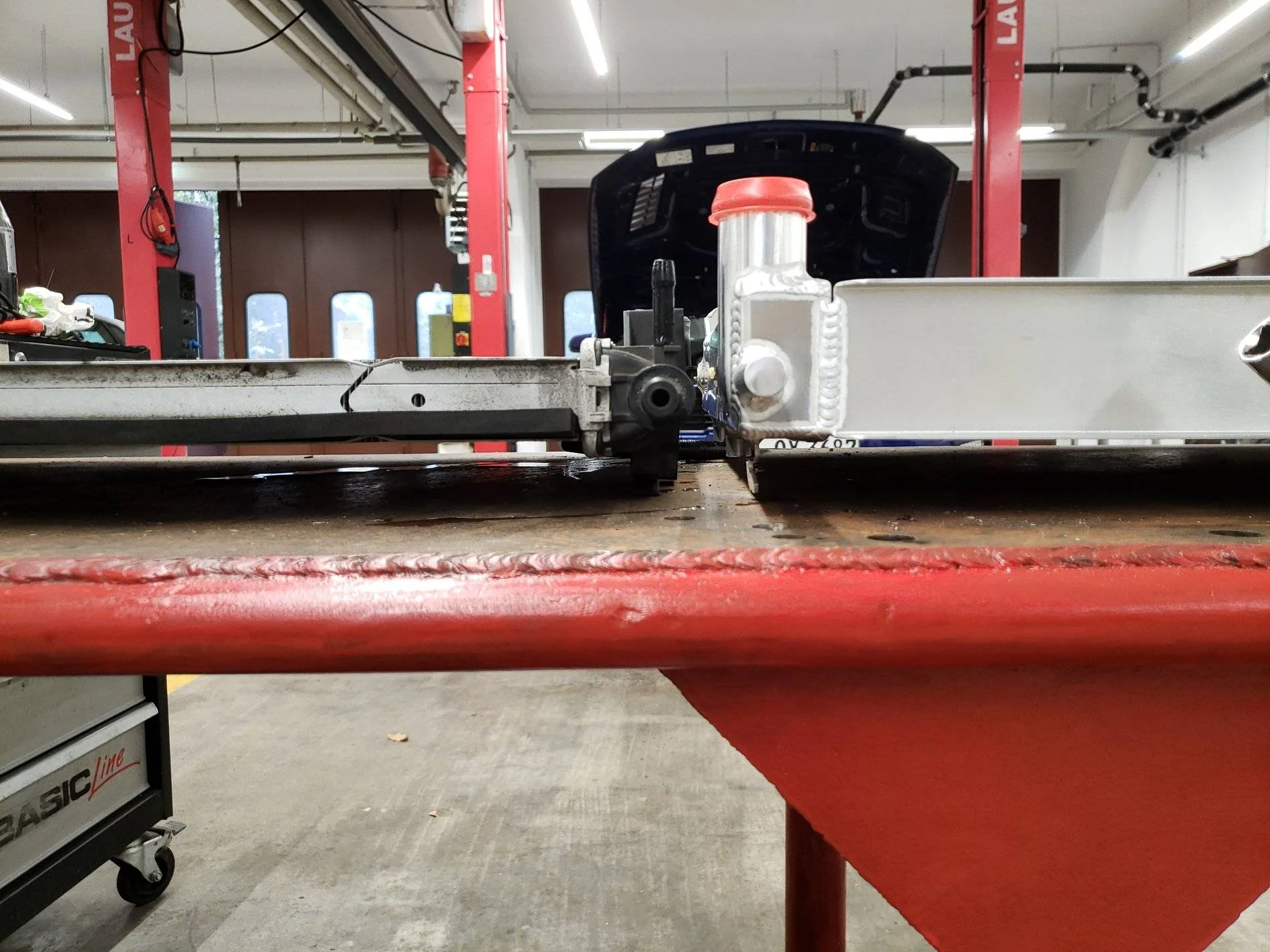

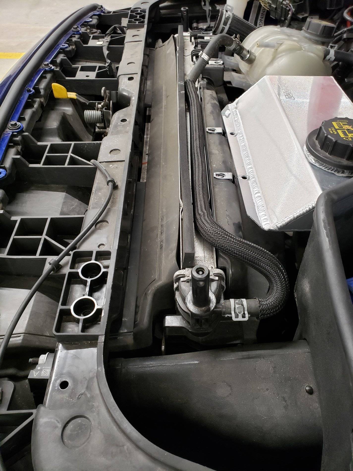

Installed the Fluidyne radiator today. Watched Youtube video to show me how. It's pretty straight forward. Messaged the upper hose to "pump" the system with fluid. The only real problem was the brackets holding in the radiator. Had to drill holes to make it work.

What was the impact to your CHTs?
Is there sufficient clearance between the degas bottle and the blower belt?

Oddly the CHT pretty much the same. The ECT are 10 or more degrees cooler.
Plenty of clearance between bottle and belts.
