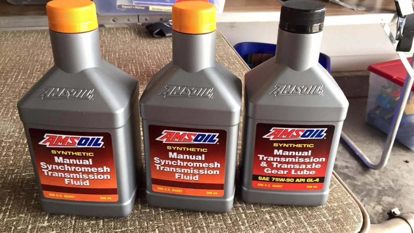

Switched out to Amsoil 2 part synchro mesh and one part 75-90 synthetic gear lube. Shifts like warm butter.

So you're supposed to mix the two?
Yes, the synchromesh is to thin on its own. I took a gallon jug and put all three in, gave it a shake and put in trans.
